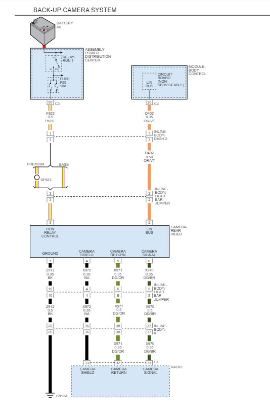

I put my car in park and backup camera came on. Drove again and backup camera stays on, been on two days, radio does not work, nor my touchscreen now.

This is a common enough issue that we know was one of two issues.
First the camera will just get stuck on and will keep the signal going to the camera which will tell the radio to keep the picture on.
So, unplugging the camera will get the radio to switch back to normal operation which means the camera needs to be replaced.
If unplugging the camera does not cause it to return, then the radio is the issue and will need to be replaced.
Please run through this and let us know what you find. Thanks
