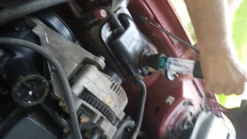

It's a Vulcan engine U in VIN. New water pump, new thermostat, 185 temperature. The fans work, hoses good, no cylinder miss. Radiator circulating and no bubbles in expansion tank. Did chemical test for exhaust gases, none detected. No oil in water and no water in oil. No steam nor smoke from tailpipe. Only code is O2 and lean. Fans work new expansion tank cap 16 PSI. Coolant level where it should be. Was flushed 3 times lots of red rusty gunk came out. Mechanic said it looked like old stop leak. There is a TSB on this issue and a bypass recommended. I do not know if one has been installed or not. We are second owners, but it was not purchased from an individual.
Runs till operating temperature then temperature will start climbing a little bit above normal operating. Then when you shut off engine it backpressure fills the expansion tank and pops the cap and dumps coolant. Mechanic is stumped. Will a clogged heater core cause this problem? Also, could trapped air cause this problem?

It sounds like you have a blown head gasket even though there is no coolant in the oil which can happen. To confirm the issue a chemical test needs to be done.

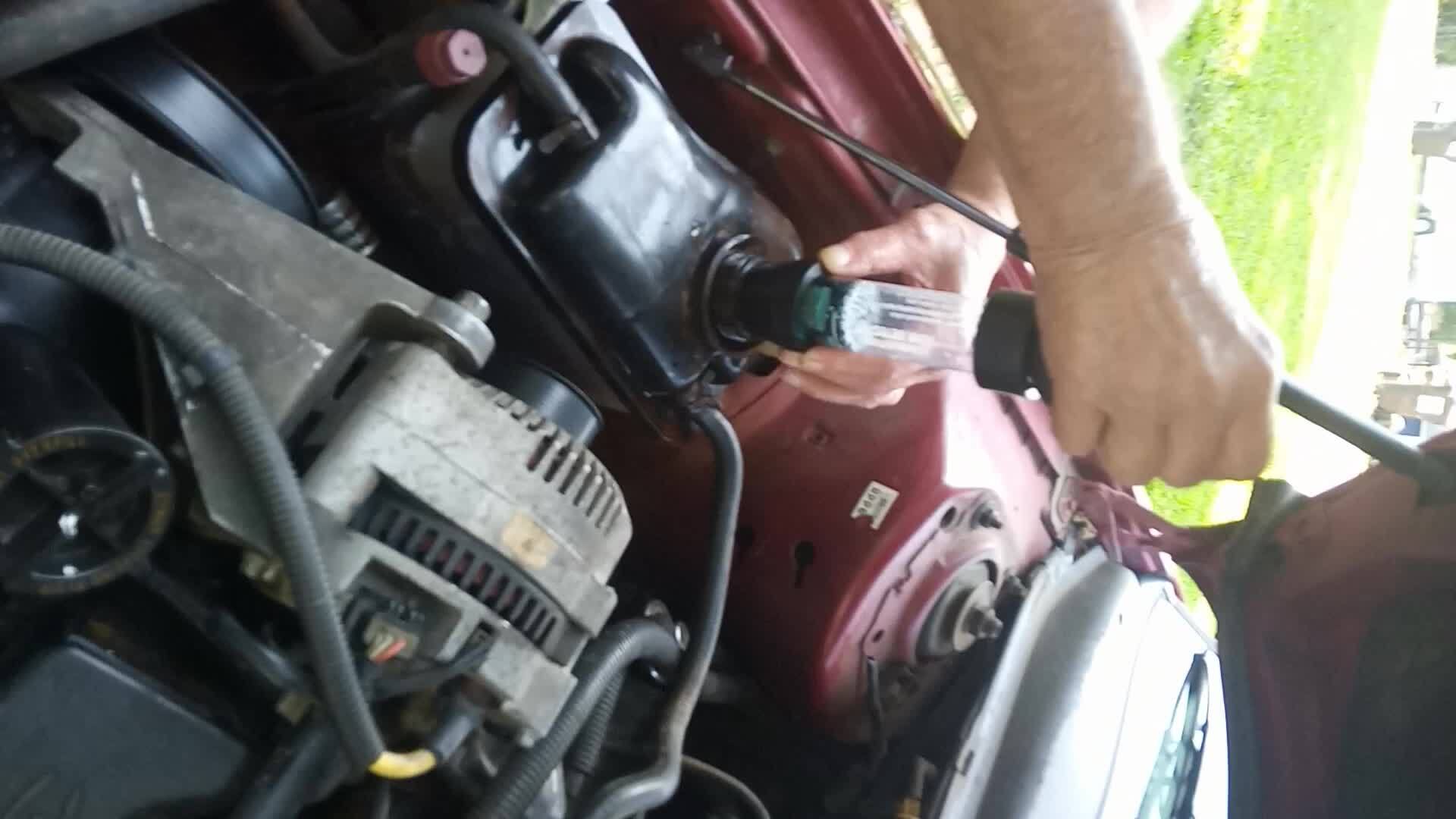

I did the chemical test, 3 times at different times, it was negative, each time the results were the same as in the vid. Also there is no misfire on any cylinder showing up with an OBD2 only code was for O2 sensor running lean, engine idles perfect. No bubbles in coolant either. No smoke. I have a 1998 Ford Taurus 3.0 Vulcan engine U VIN.
New water pump, new thermostat. 185 temp.
New expansion tank cap 16 psi
No combustion gases nor bubbles in the expansion tank per test.
No cylinder miss.
Mechanic says hoses are good
Radiator circulating and system flushed.
Fans work
Rusty water still even after flush. This is the 3rd time it's been flushed.
Only code showing is O2 sensor... Lean.
After the engine reaches operating temperature and is driven for a few miles, the temperature begins to climb over normal range.
I never let it get beyond a hair over normal range.
Shut off engine the expansion tank steams and pops cap dumping engine coolant on ground.
I saw the TSB on this.
How do I know if a coolant bypass kit has been installed and is there any other reason this may happen? No mixing of oil and water. No vapor out the tailpipe.

Thanks for the video. It does seem like the chemical was changing color slowly. This test is not 100% accurate and can produce a false negative. I think you may have a bad head gasket still, a very minor small leak but still enough to affect the engine overheating. Do the fans come on when the coolant reservoir is bubbling over? (Key on)

We took the chemical and put it in a bottle then blew through a straw into it, it changed color after one breath two breaths changed it green, 4 breaths turned it yellow. The test was preformed 3 times on that system with the same results each time and one of those tests were longer than 2 minutes and I agree I thought it maybe getting a lighter color. But really couldn't tell.

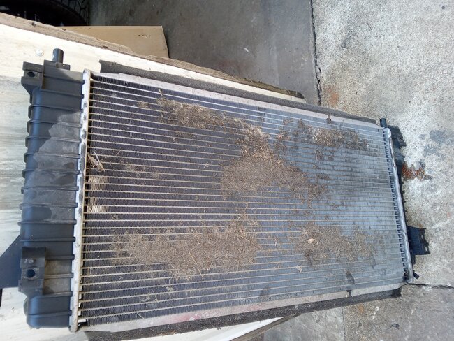

Yes, it would, the only other thing I can think of is the radiator is plugged internally so it would be difficult to see. Can I ask how you determined the radiator was clear? It could be plugged up externally as well. please check out this guide:

The expansion tank was being replaced for rupture. It had only been on for 5 months so shop said faulty part. We requested a system flush because of all the red slime mud that had been in the system when we purchased vehicle. The system has been flushed 2times in the past year. So, while they had it, we asked for a new water pump, a new thermostat a new radiator plus system flush. To remove any remaining stuff that maybe in the system.
The shop said we didn't need a new radiator cause radiator was circulating just fine and they felt we didn't need to spend that $700.00.

The problem will be either a partially clogged radiator or a blown head gasket.

It was a clogged radiator. Brand new one put in 2days ago. It was the original radiator. Full of rust.
It fixed my problem. You couldn't see the stuff on the radiator through the grill. That "clean" area in the middle is all you could see when you looked through the grille.
