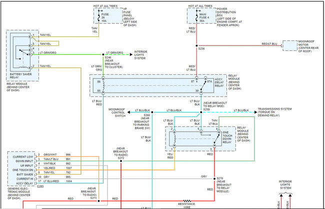

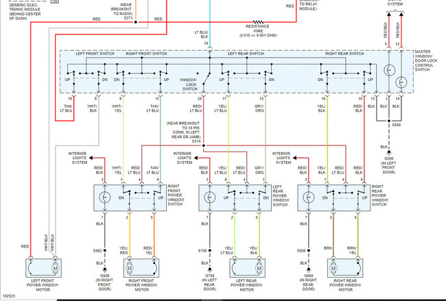

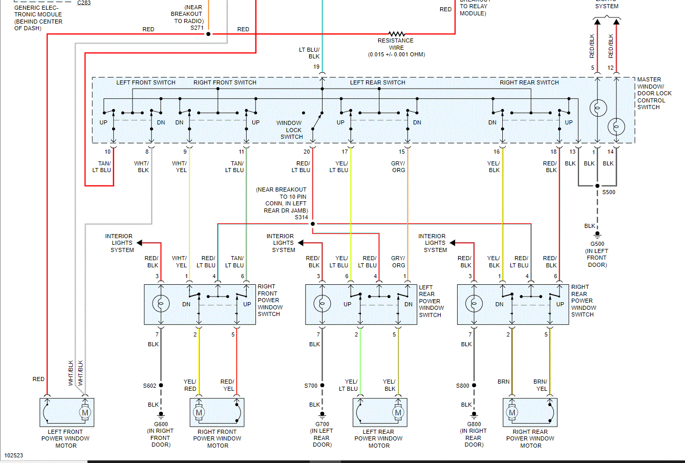

Do you hear any noise coming from the door affected when you try to open it? Are all other windows working correctly?
To get you started, I attached the wiring schematic below of the power window circuit. If you let me know which window it is (left or right rear), I will be able to help more with testing.
We will need to check if power is available at the window motor. If there is, chances are the motor is bad. If there isn't, we need to check a few different things.
See pics below. Note: I had to cut the schematic in half to make it readable. I did overlap them so you can follow from one to the next.

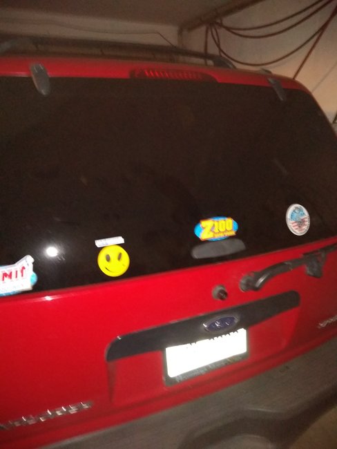

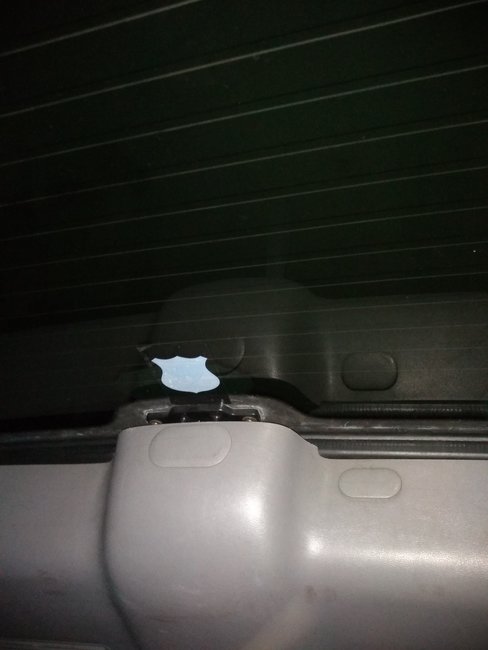

Thank you for getting back to me,
It's the rear Hatch Glass that won't open when I press the button in.
Normally when I press the button the glass part opens. See photos, one is on the inside of the Explorer, other photo outside view.
Any help would be appreciated.

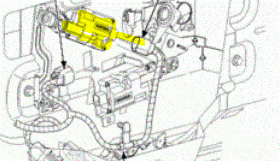

Do you hear a click or anything from the rear glass when you press the button? If not, is there anything other electrical not working?
If everything is working and you hear nothing, we need to check for power at the motor. See pic 1 below. If there is power, then we need to replace the actuator.

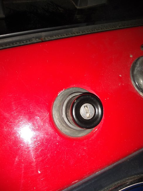

Hi, the lock will not release, that's the issue, there's a center post on the lock, one lever is on the right, the other one is on the back. Both lock down on the center post. I tried WD 40, but the lock did not budge.

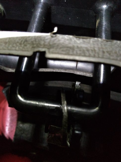

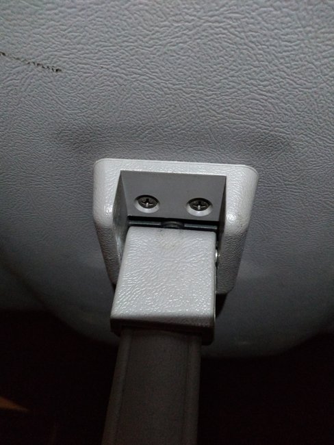

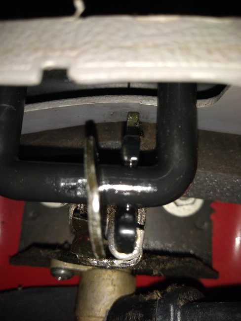

POLIZEME25
  • 61 POSTS
Joe. Hi do I need to remove the large inside back panel, and how do I do this? Thank you, Kenny
Thursday, June 10th, 2021 AT 4:28 AM

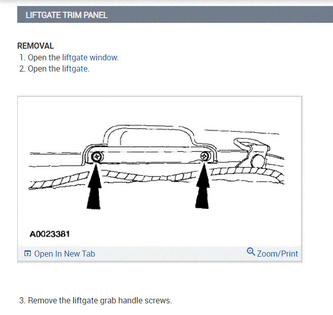

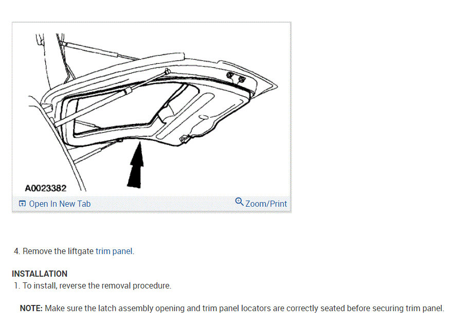

  • 110,192 POSTS
Kenny,

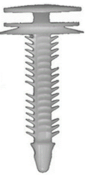

The directions I have are extremely vague. See pics 1 and 2 below.

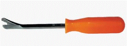

Here is what I recall. Once the screws are removed, there will be several trim panel clips that hold the panel around the frame. See pic 3 below. They are very easy to break, so don't be surprised if they do. Also, they make a tool to remove them which you can get at any part store. See pic 4. It really helps prevent breaking them.
The only other thing I can recall (it's been a while). Is where the window glass latch is located there should be a small cover that pops off. If I recall correctly, there is a screw under that cover.
Let me know what you find.

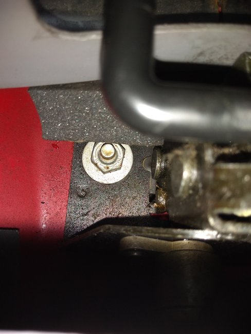

POLIZEME25
  • 61 POSTS

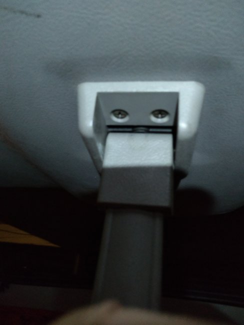

Joe, don't see any screws under plastic cover, only one screw under cap and 2 screws under handle. Do these screws need to be removed?
See photos.
Friday, June 11th, 2021 AT 10:22 AM
  • 110,192 POSTS
Yes, those need to be removed as well. The screws go through the panel and attach to the door.
Let me know how you make out or if you have other questions.

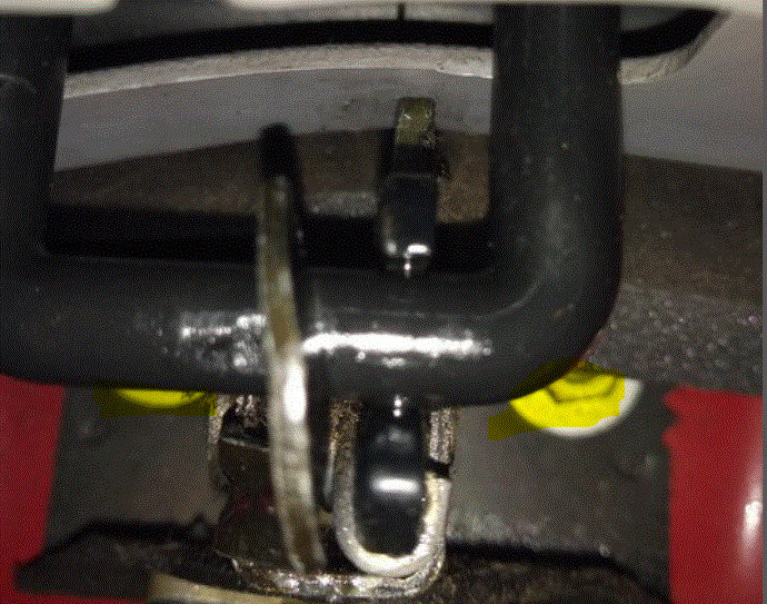

Joe. I removed the back panel as much as I could, the lock prevented me from removing the panel completely. The lock does not move no matter what I have tried. Putting a key in the lock, pushing in the button.
Any ideas? I have attached photos, and get you more pictures if needed.

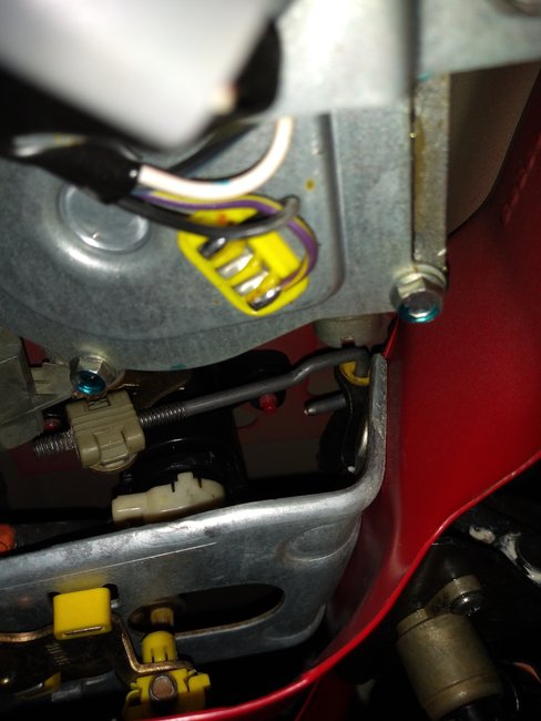

  • 110,192 POSTS
Is it possible for you to remove the two nuts I highlighted in the pic below? If so, remove them so we can open the glass and gain better access to the latch assembly.
If you could, take a pic of the inside from a little further back so I can see more of the area.
See pic.

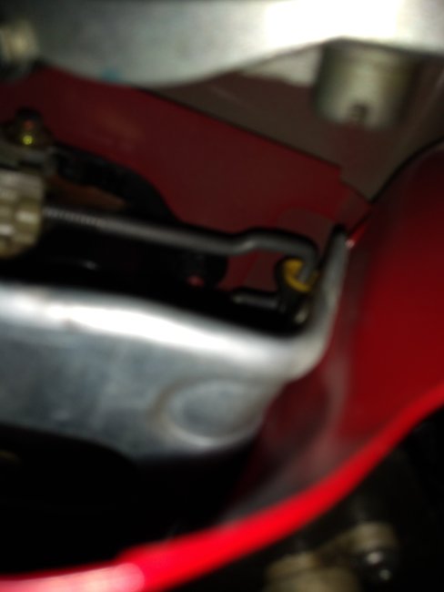

POLIZEME25
  • 61 POSTS
Joe,
I removed the two nuts and eventually got the glass to open.
Now the issue is the button still does not work, lock dont work and glass now stays open.
Any ideas?
Thank you, Kenny
Tuesday, June 15th, 2021 AT 11:25 AM
  • 110,192 POSTS
Okay, now that you have it open, are you able to manipulate the mechanism to remove it from the latch? Also, send me a pic of just the latch you removed so I can see how it's attached and if there is a way to remove it. If it is locked in place and you can not even release it manually, the assembly must be damaged internally.
Tuesday, June 15th, 2021 AT 9:29 PM
POLIZEME25
  • 61 POSTS
Joe,
I'm able to take a closer look, the lock solenoid don't move, it needs to be replaced. Went to a Ford dealer, they no longer carry. How do I find the part number and where can I get a aftermarket part?
