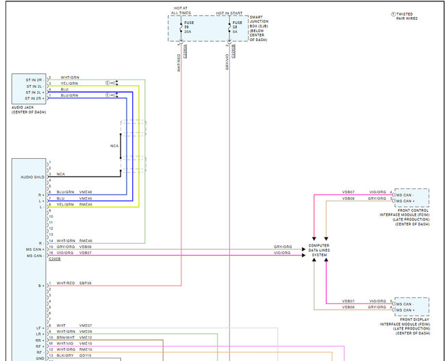

The B1031-60 Diagnostic Trouble Code (DTC) relates to the Audio Control Module (ACM) and typically indicates an Antenna Circuit Short to Ground.

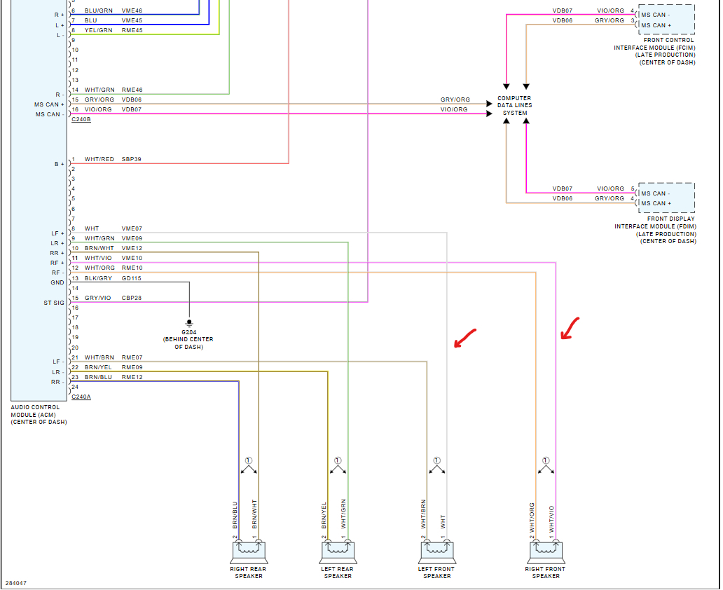

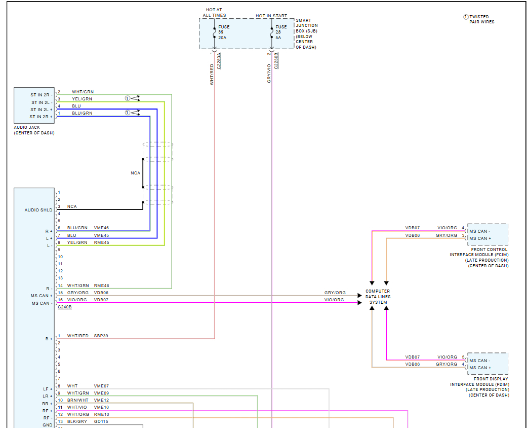

The B2404-60 code is related to the Audio Control Module (ACM) and refers to an issue with the Front Audio Speakers Circuit Short to Ground.

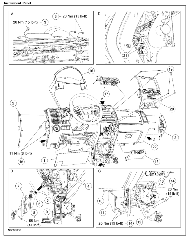

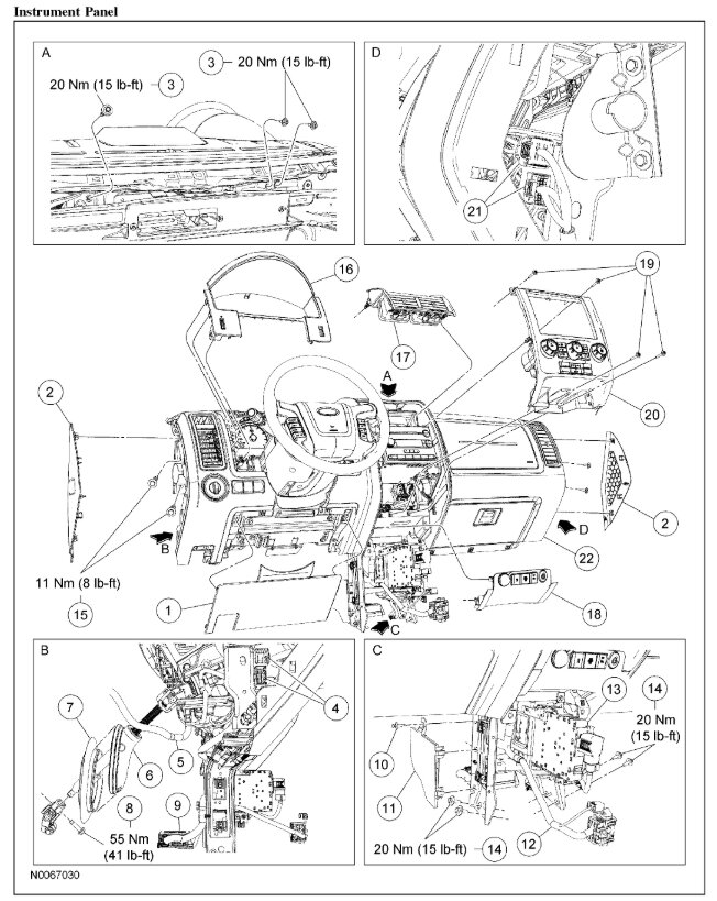

If the antenna is shorted to ground it will cause this code, here are the instructions on how to replace and inspect the antenna wire. Here are the front speaker wiring and a guide to help you check the circuit to ground.
It could be one of the front speakers is bad which will cause the code as well. Check out the images (below). Let us know how it goes.

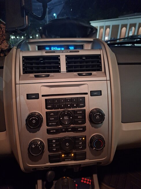

Here is the radio.

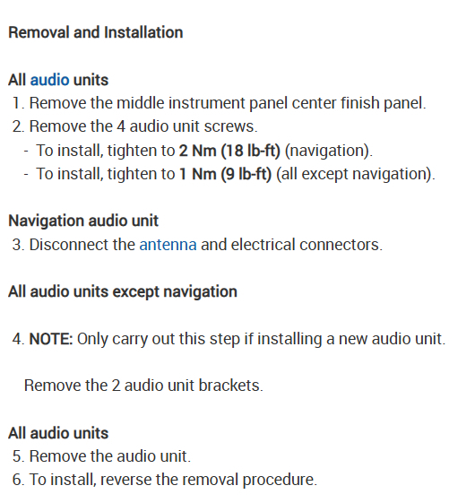

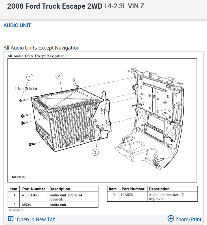

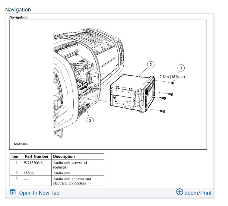

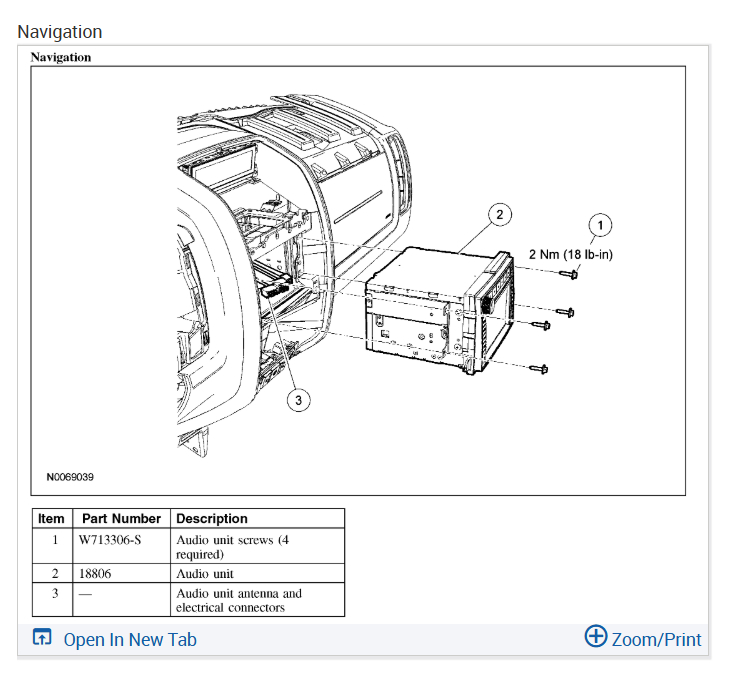

That is a stock radio so no worries there. If the antenna is okay and the speaker wires, I would get used radio by searching eBay and install it because the old radio has an internal error. good to hear the engine problem is better. Can you please update that post, it would be good for others to see it. Here is how to change the radio out.

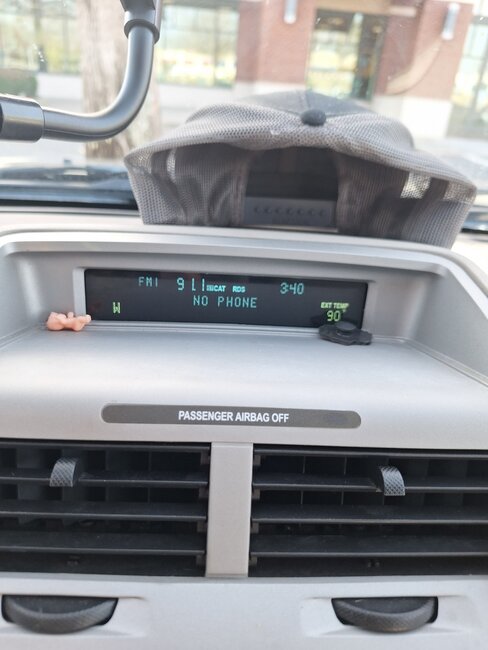

My dilemma about the radio is I don't want to spend the time and money to replace the radio if it's not the radio. Is there any other reason that it could be showing no phone when I press the phone button? Also, if the compass and temperature isn't accurate could that cause a problem?
Mar 7, 2025 at 12:41 PM
  • 54,503 POSTS
There are signs the radio is going bad, these problems all run through the radio, but I would test the antenna and speaker wires to ground to help confirm the failure, this guide can help, take the voltmeter and put one lead to the antenna and the other to ground, there should be no connection, the same for the speaker wires.
Please go over this guide and get back to us.
