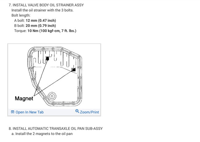

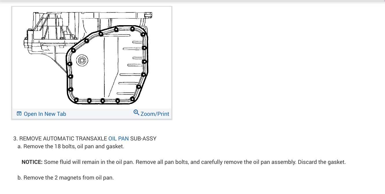

The ATF is dark, nearly black. I am a good DIY mechanic, but should I leave this to a professional?

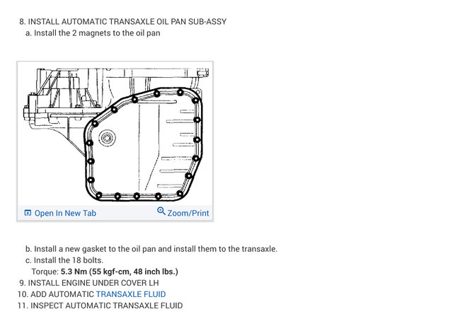

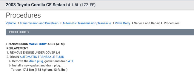

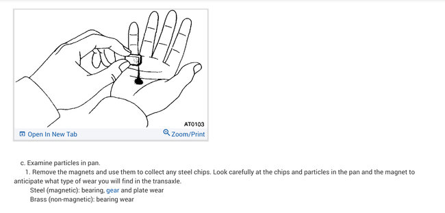

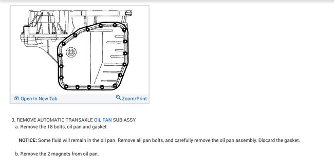

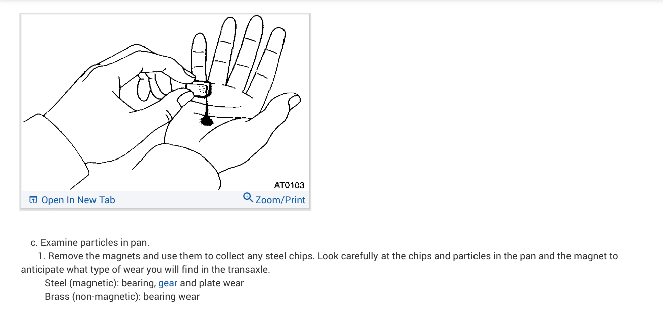

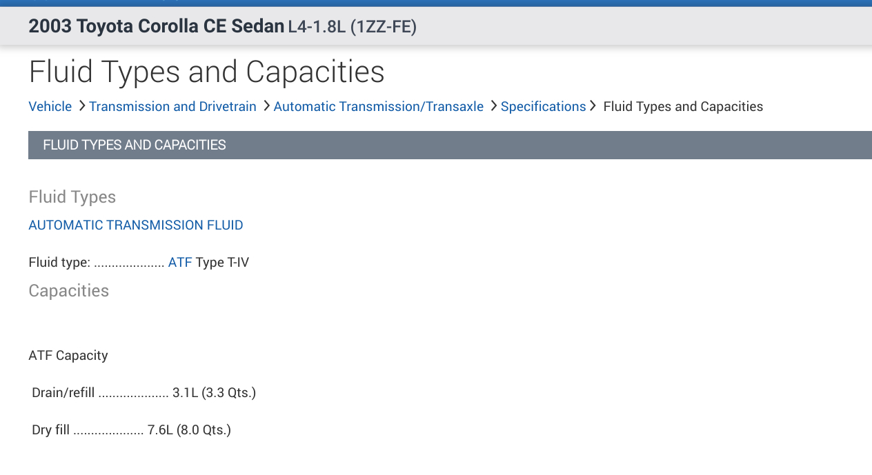

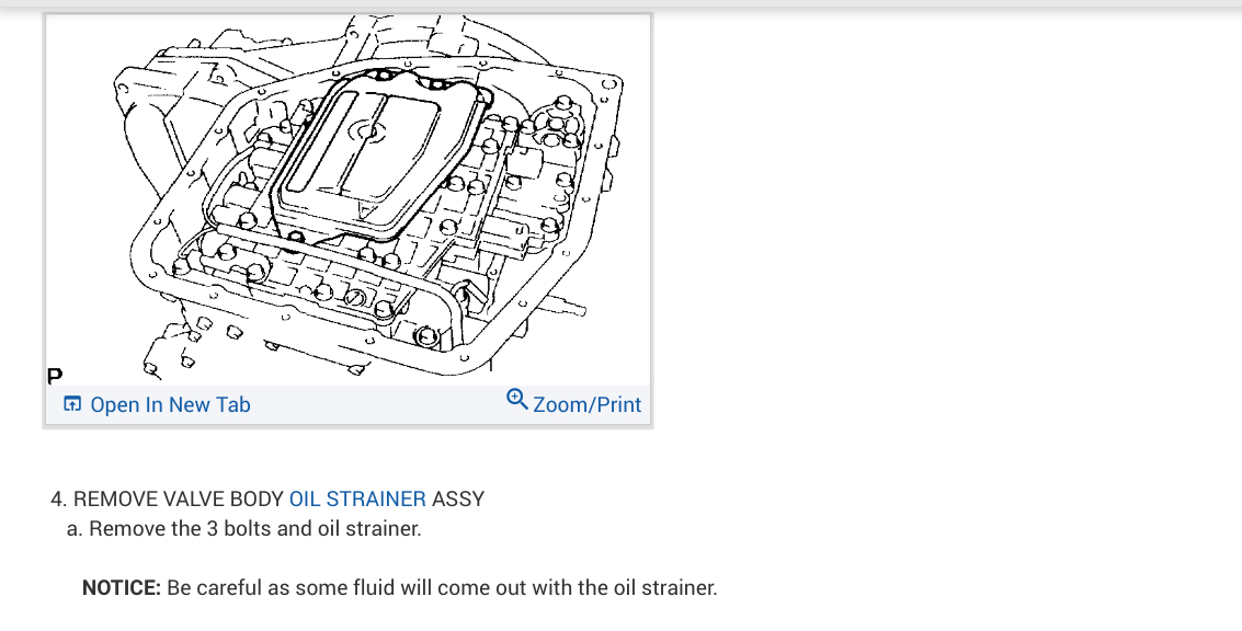

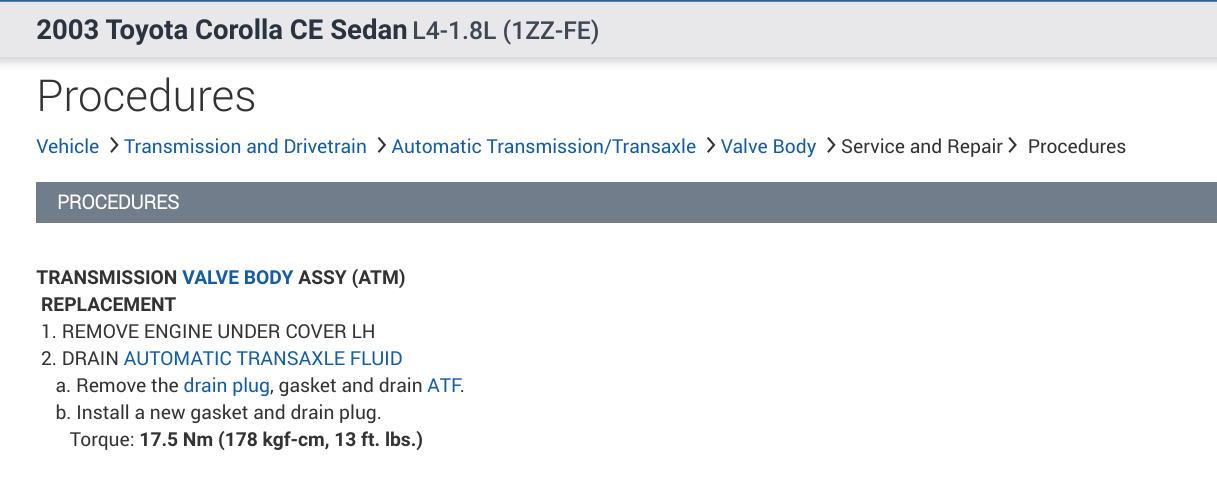

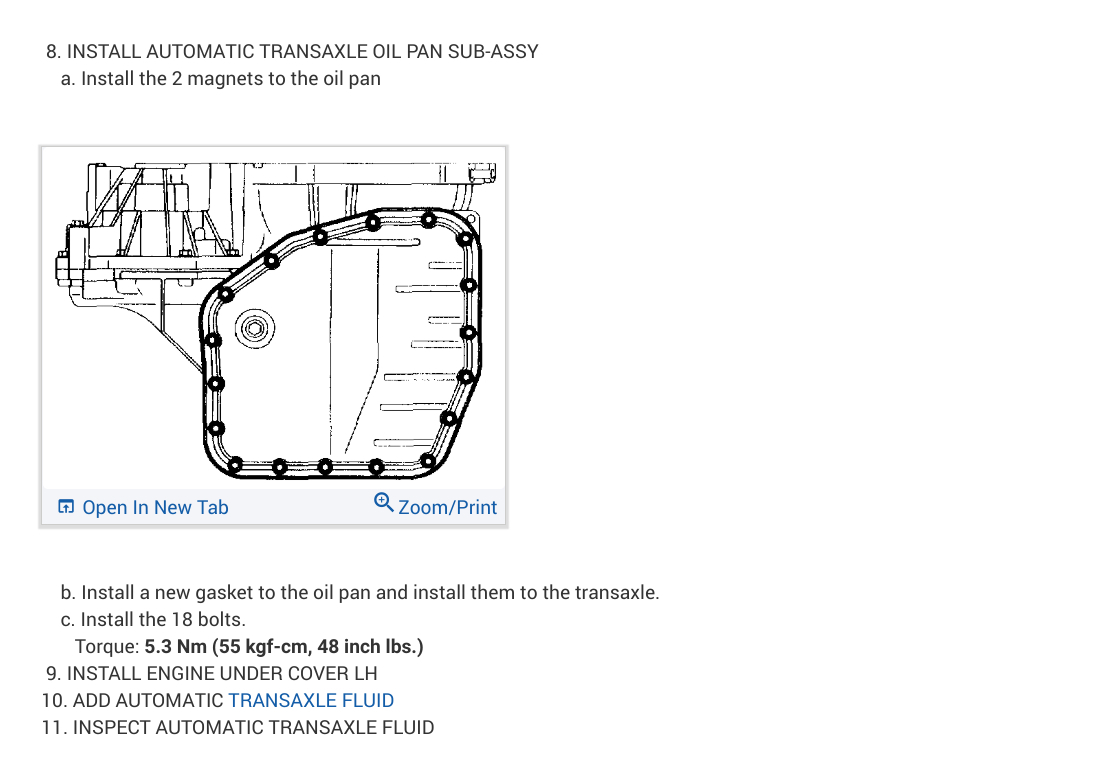

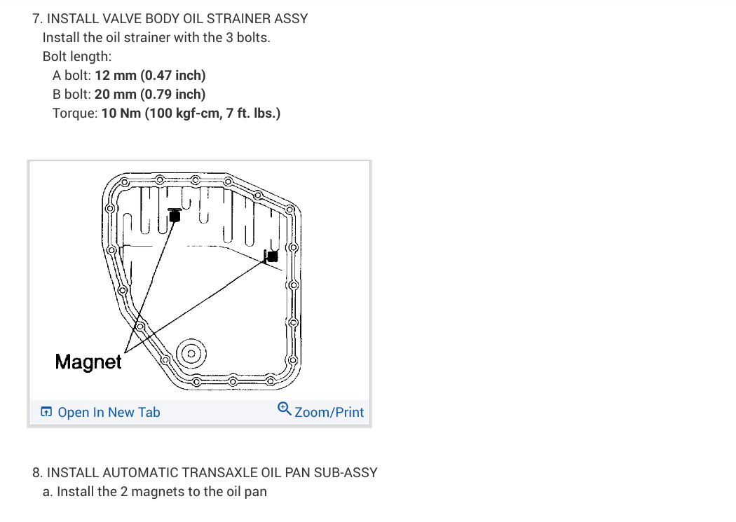

You can do it yourself here's a guide to walk you through the job with instruction in the diagrams below:
In the diagrams down below I have included the instructions along with fluid type and capacity for the automatic trans-axle for your vehicle. Please go through this guide and get back to us with how everything turns out.
