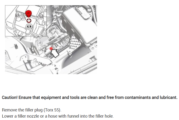

instructions on how to change the transmission fluid. Thus s an AWD one.

am sorry, I wrote a whole line but I may have not been typing on the line and then hit enter, Am trying to see if there are any instructions on how to change the transmission fluid. Thus s an AWD one. Thanks

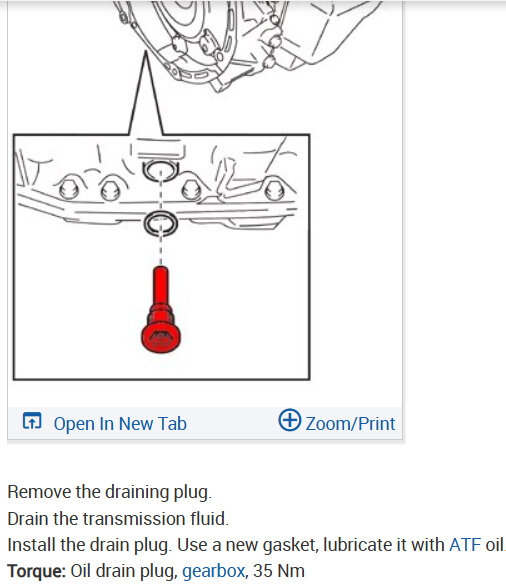

No problem, please go over this guide to help and I have given you instructions for your car and the fluid type as well which must be used or the transmission will not work or shift correctly.
Automatic Transmission Fluid Type Specification
Fluid type .................... AW-1
Check out the images (below). Let us know if you need anything else.
