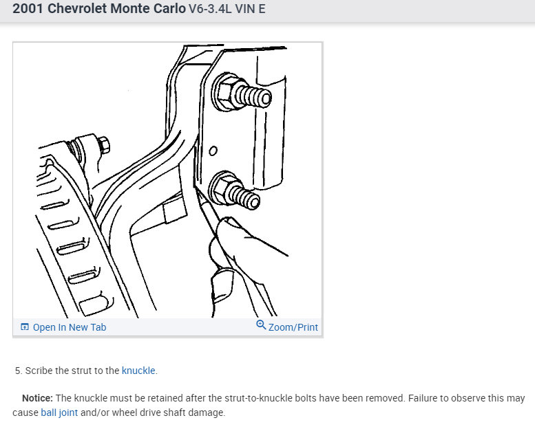

I bought the left side I needed the right are they universal?
Thursday, June 30th, 2022 AT 4:08 PM
SQM
MECHANIC
6,383 POSTS

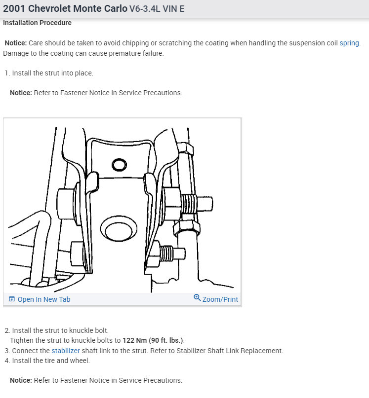

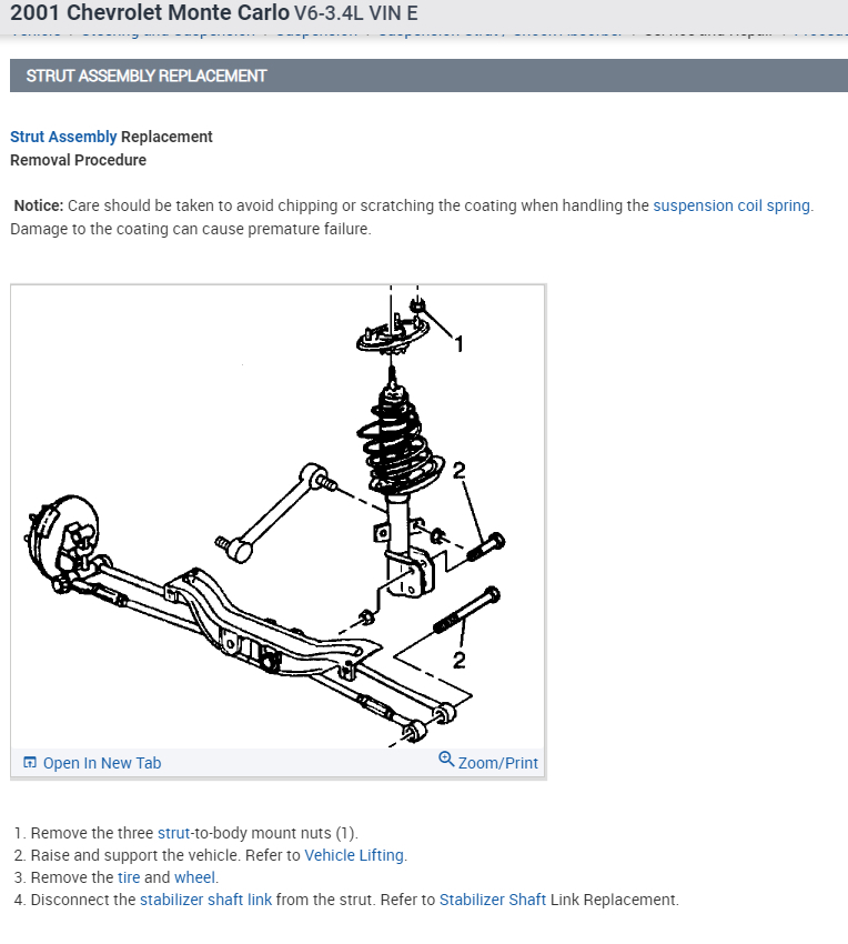

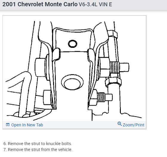

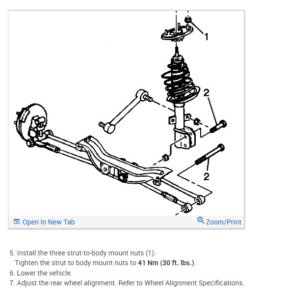

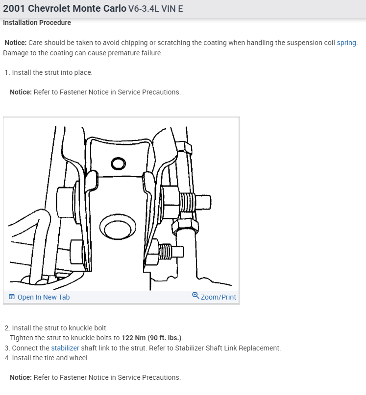

Unfortunately, the left side strut will not fit the right side and vice versa.
So, you will have to get the correct side strut.
https://www.2carpros.com/articles/how-to-replace-a-suspension-strut-and-spring
I have attached the strut replacement procedure below for your reference.
Let me know of any questions.
