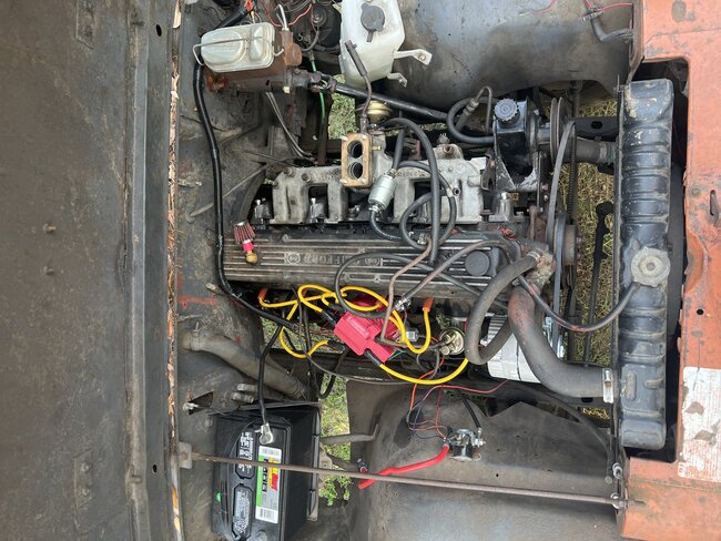

Vehicle can only creep a few feet in 4wd high before stalling and crapping out. Will probably only move a few inches in 2wd before stalling and crapping out. I am 90% sure I have upgraded to one-piece axles. I have replaced the carburetor with a weber 32/36 and have tried getting it to run right but can’t seem to get it going like it deserves! I have a feeling it is a fuel issue. I have just tried replacing the whole fuel system from previous contamination. Everything ‘s been changed other than the fuel lines. It also has new distributor, and it is nutter bypassed.

Can you send some pics all over the engine with the breather removed?

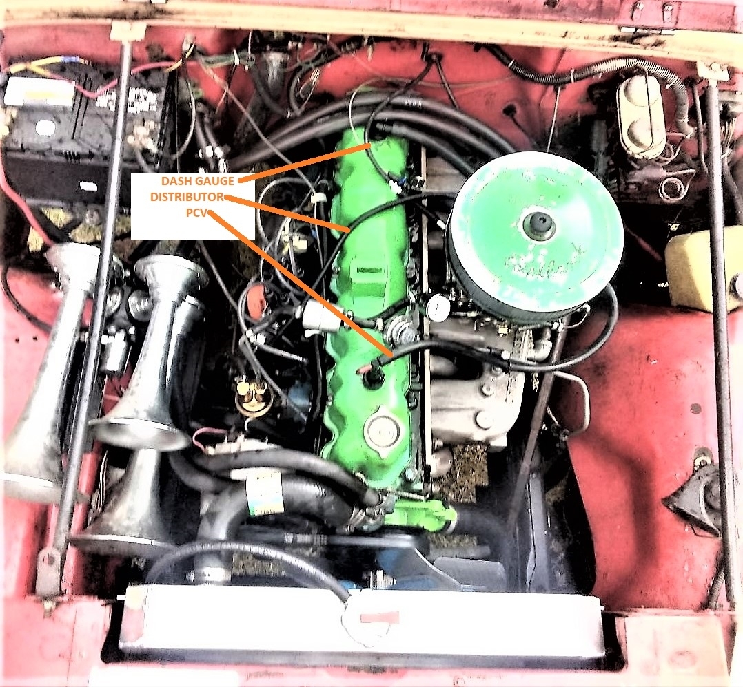

I would love to know all of the vacuum locations as well.

Another thing I only have like two vacuum lines, one from the distributor and one from the valve cover to the carburetor. This can't be right from the more than a dozen I have seen on previous diagrams.

More pics?

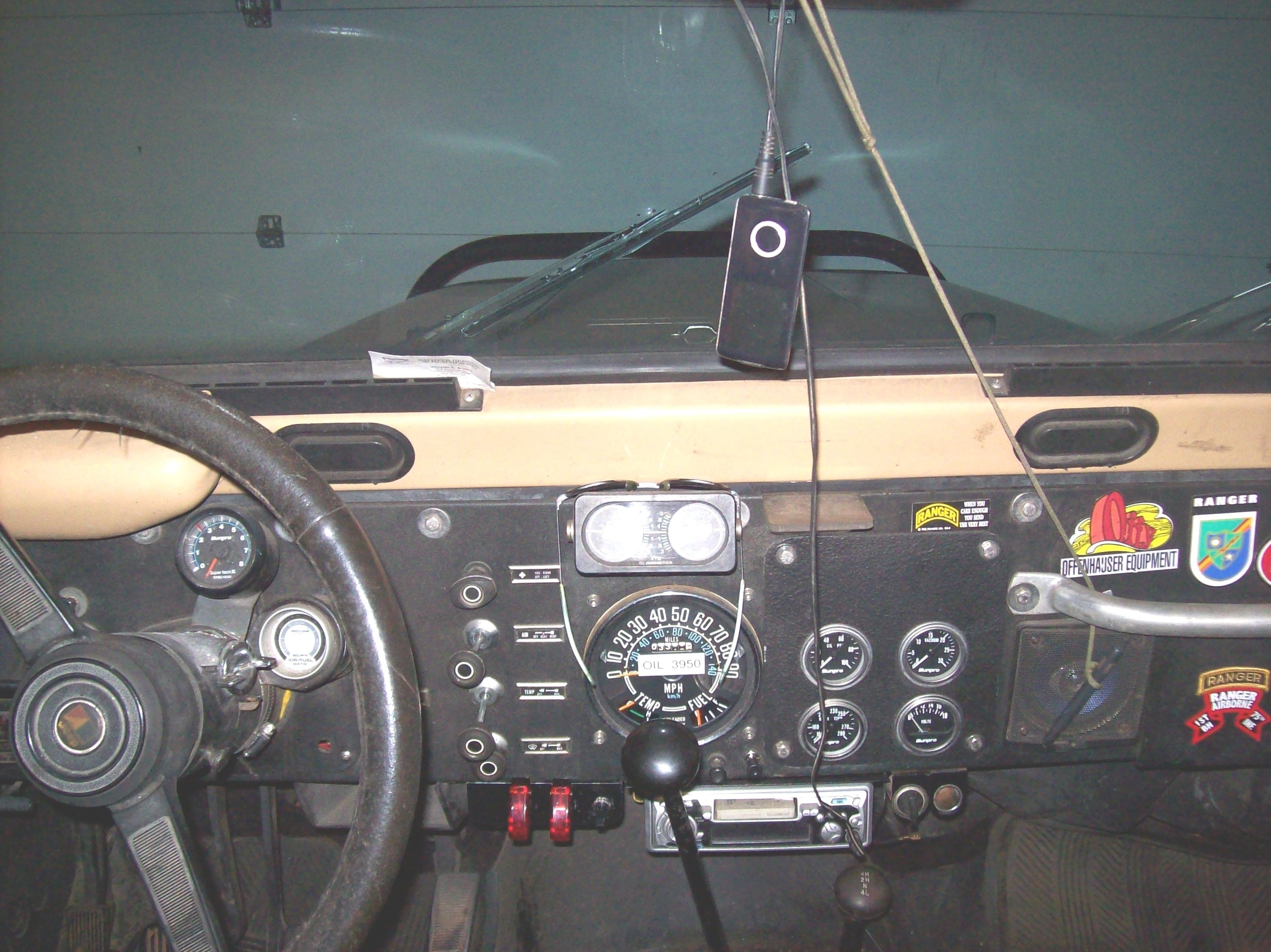

And what is that Dash Gauge for?

Do you have all of the vacuum ports plugged off that are not in use?

More pics ! Especially top and driver's side

Okay, it seems to be on time but I'm still having trouble cranking, I have to give it throttle. I tried advancing and retarding the distributor and nothing helped crank I should have all vacuum to the bare necessities other than the dash gage that u labeled not sure what to do with that yet. I believe the trouble must lie within the weber 32 /36 carb I have it is not squirting out of the second carb jet no matter what, which is a problem because it is supposed to be squiring gas progressively as the throttle is pressed all the way down. I also had trouble trying to tune it, which could also be the cause.

Make sure it is not sucking air somewhere! Cap/ plug/ etc any open lines.
Here's my "Dash Gauge"---it is not a must at all!
I have it to diagnose my Goods or Bads, or tuning! (It's usually goods)
Mine is The 1st scenario in the video!
https://www.youtube.com/watch?v=NrnzD7PgoHI
Here's my dash vacuum gauge---it's the top right one over the cigarette lighter

Okay, where do I check I don't have power brakes and don't know where to test. I only have the vacuum at the carb for the distributor vacuum advance. And the ones out of the valve.

I need to get u a picture of the engine bay again if I cant find one tonight I will take one tomorrow when the sun is out. I want to thank u for helping me try to get my ride running, I know im missing out on some fun. I havent been able to really take it out since I got it.
