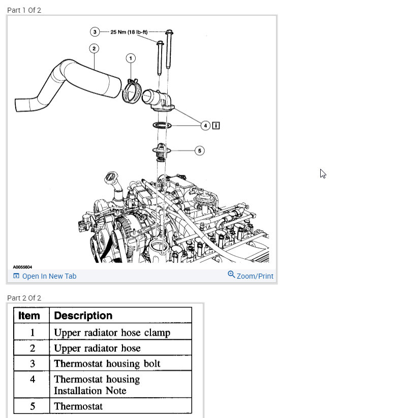

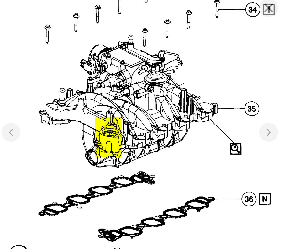

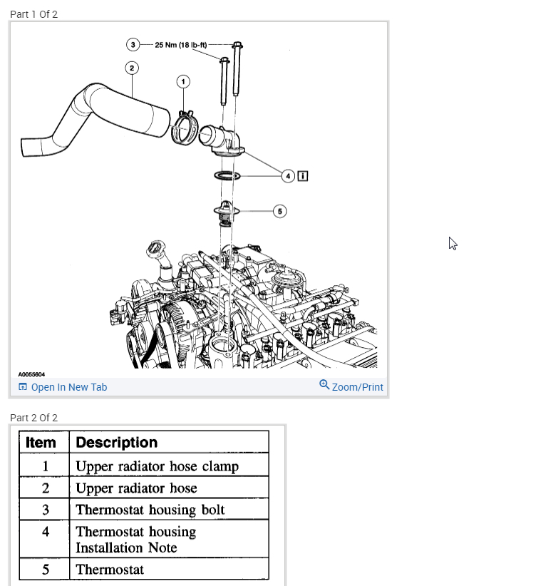

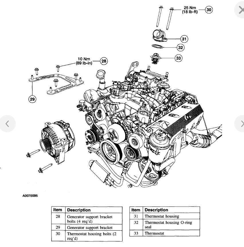

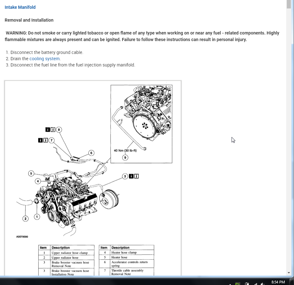

I asked what the part was that the thermostat housing was bolted to, and a mechanic answered it was the water pump. I disagreed and after researching it looks like the crossover. Could this be right?
Monday, October 28th, 2019 AT 12:56 PM
12 Replies
The thermostat housing bolts to the intake manifold. Take a look at the pictures attached for more detail. Let me know if there are more questions. Thanks
+1
Monday, October 28th, 2019 AT 6:56 PM
ROBERT LOUDERMILK SR.
  • 12 POSTS

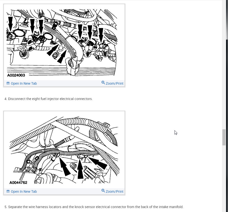

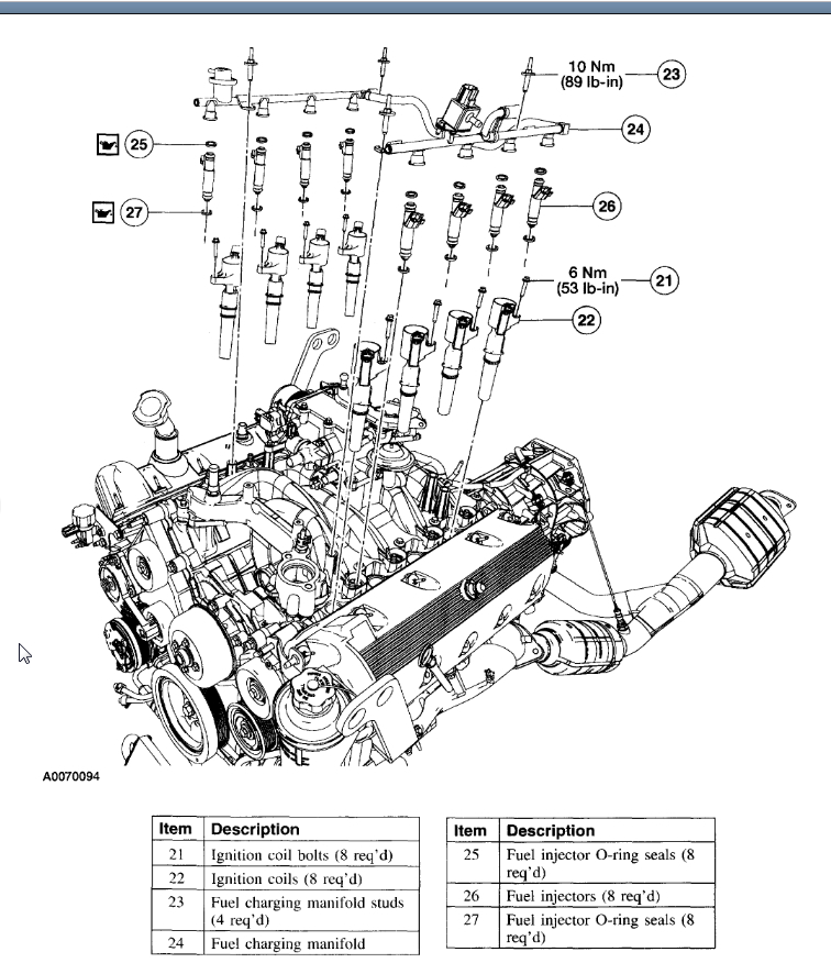

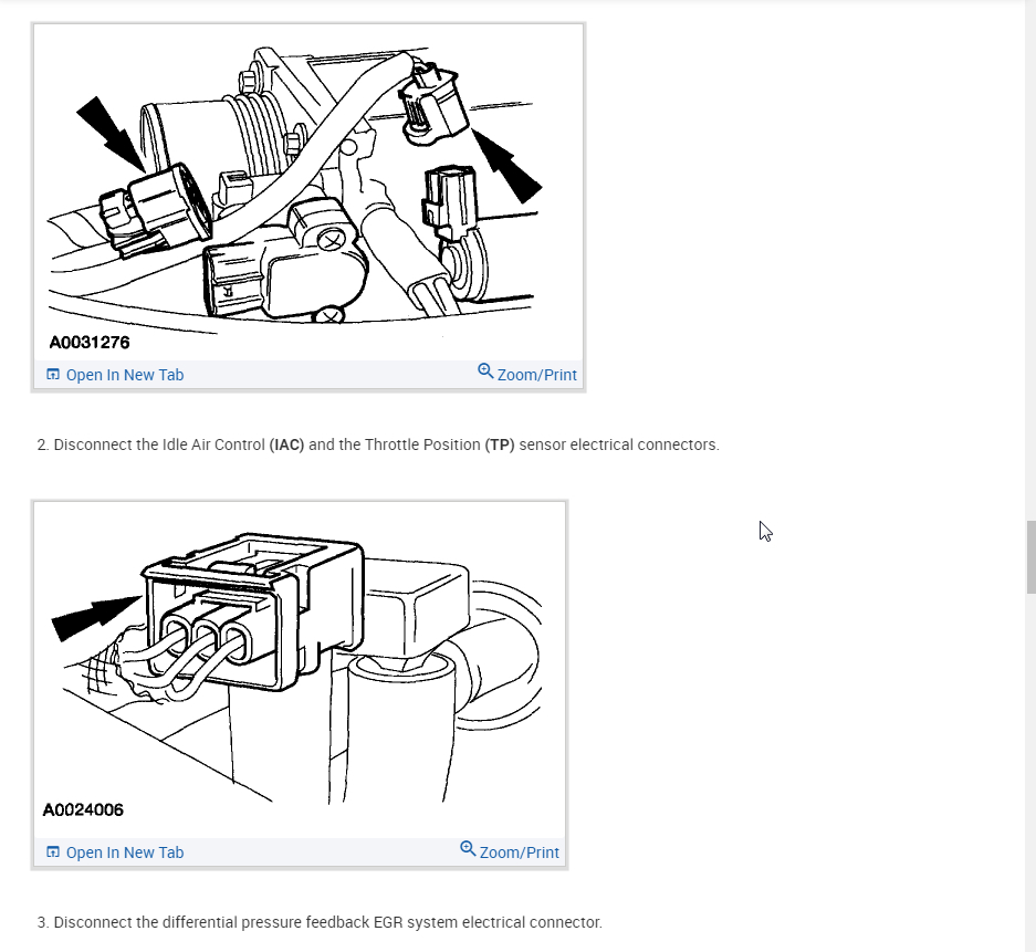

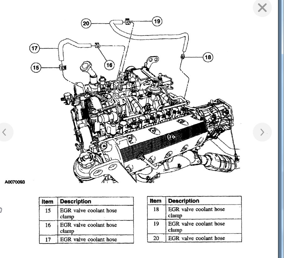

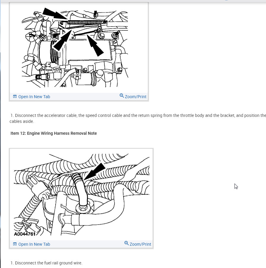

You are right. Thanks. How do I remove it. The bolts are on the bottom side of the manifold. Appreciate your help.
Wednesday, October 30th, 2019 AT 7:04 AM

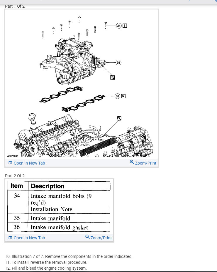

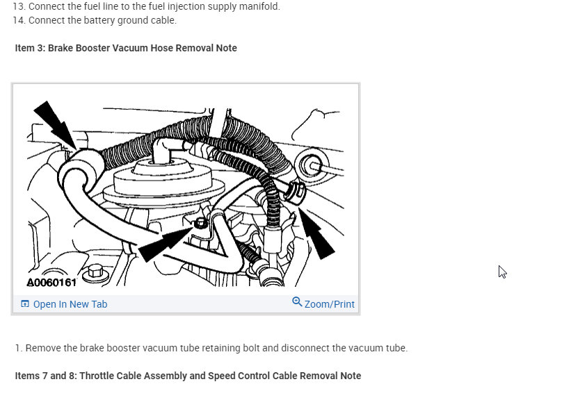

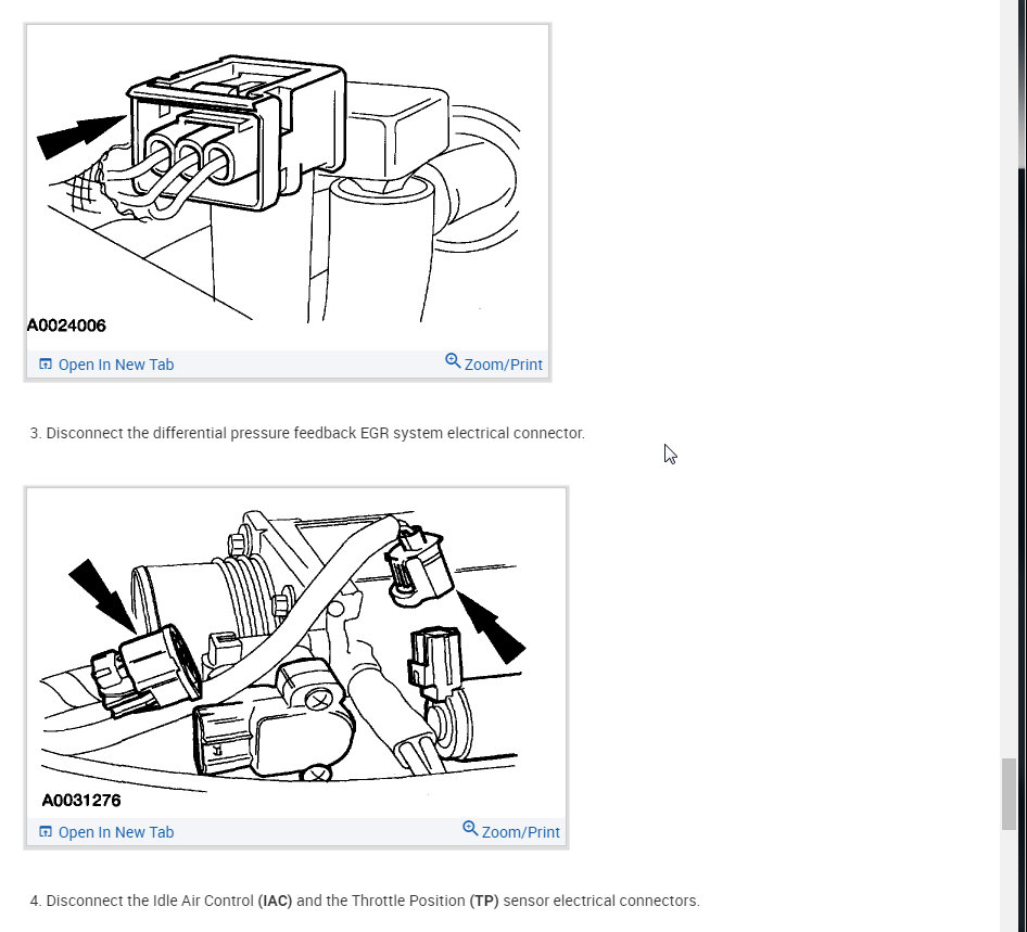

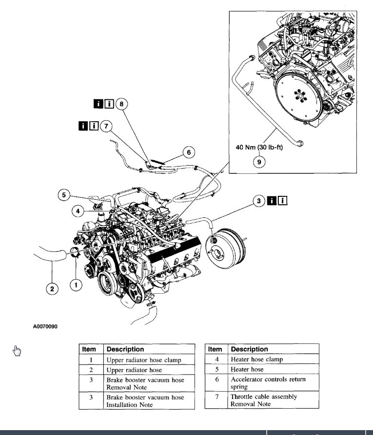

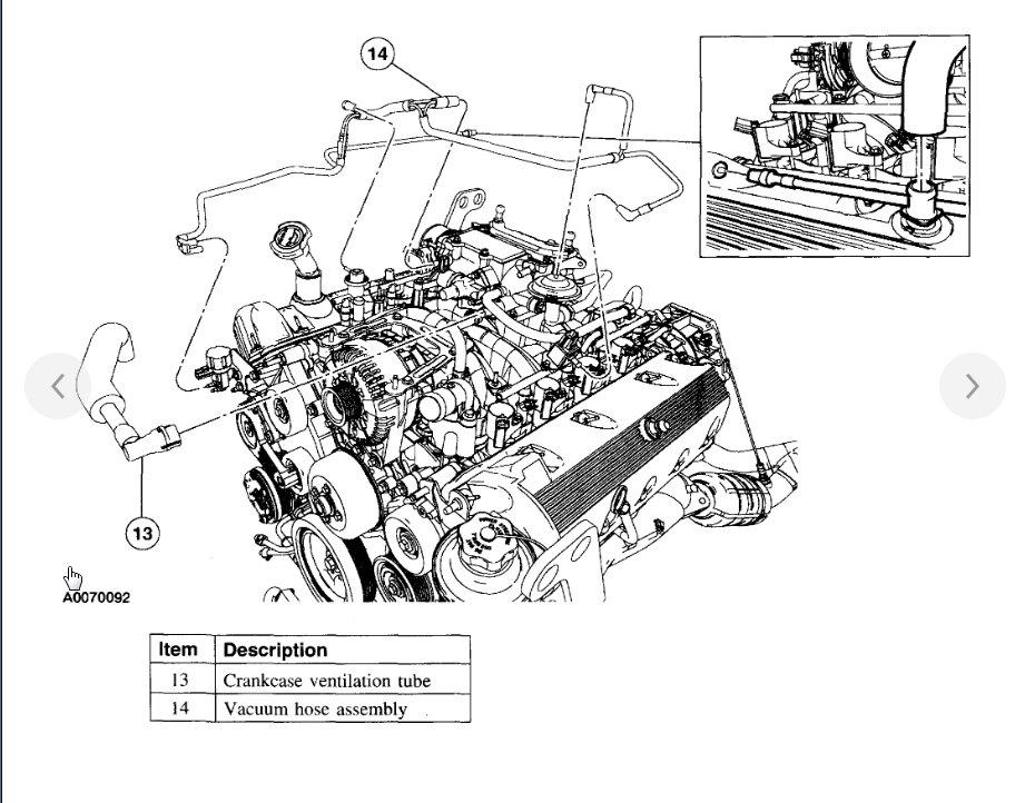

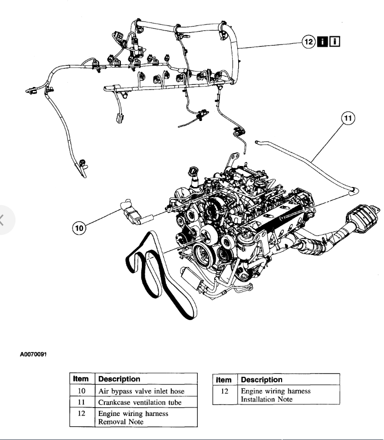

This is part of the manifold and is not removable separate. It is a single molded component.

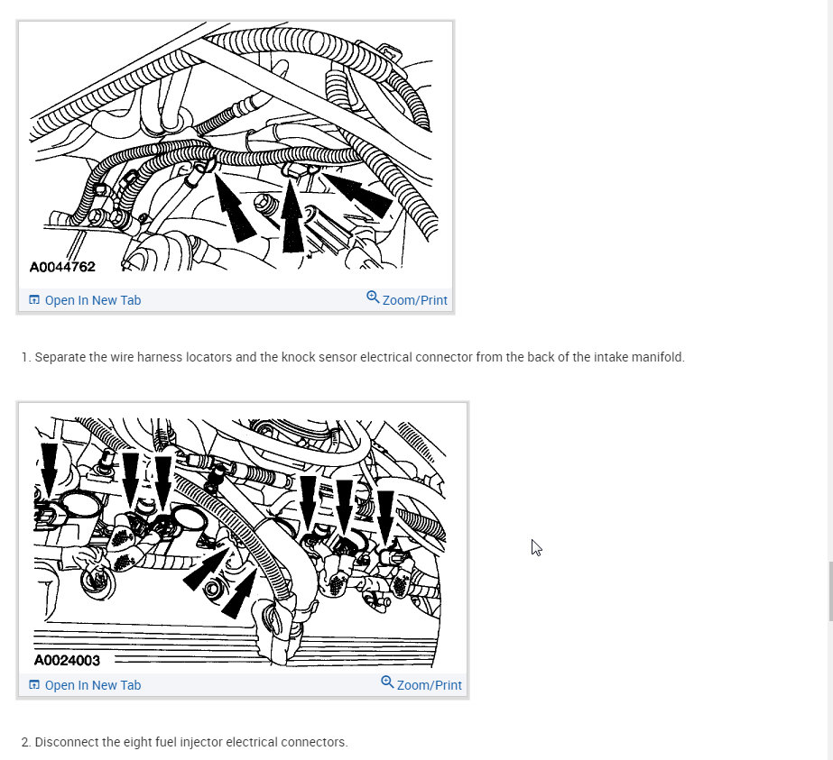

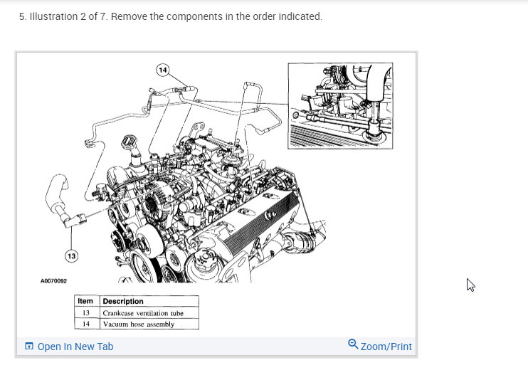

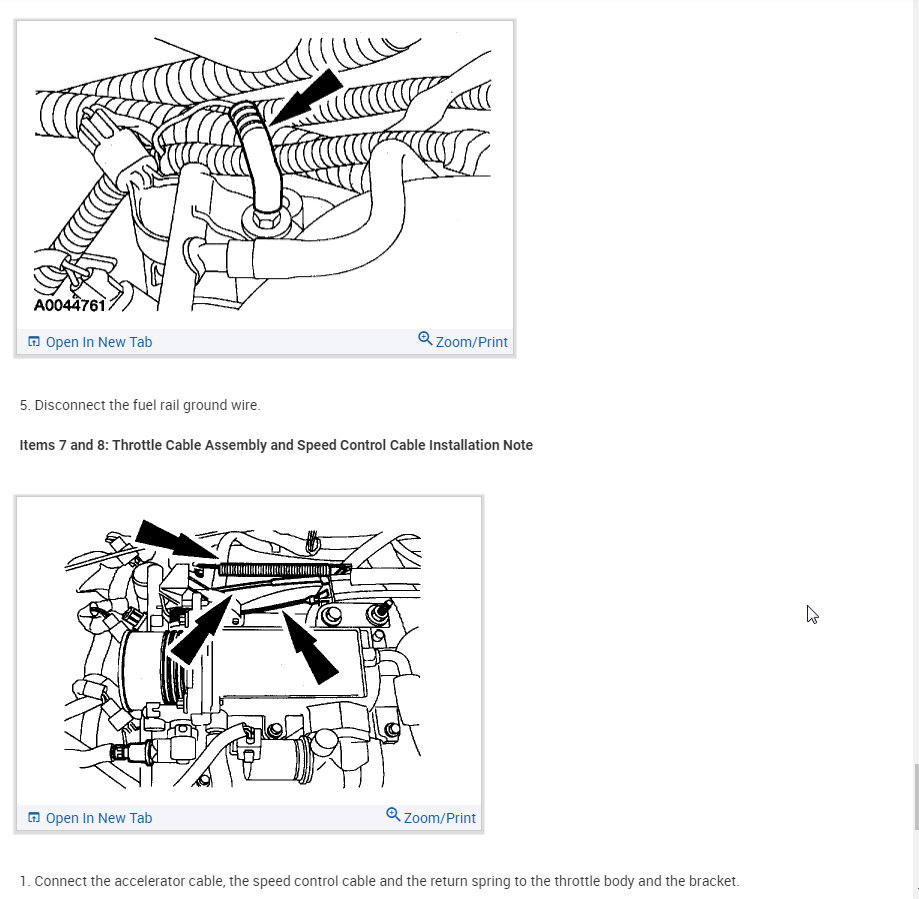

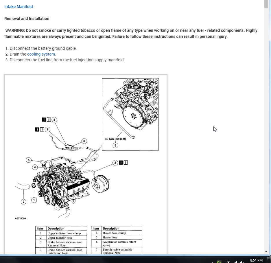

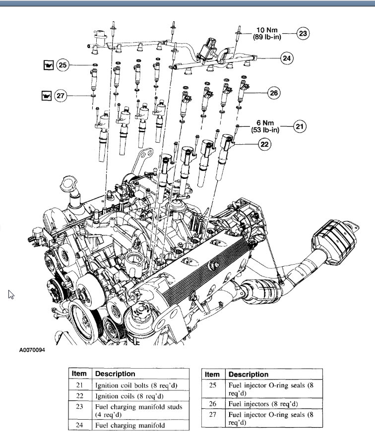

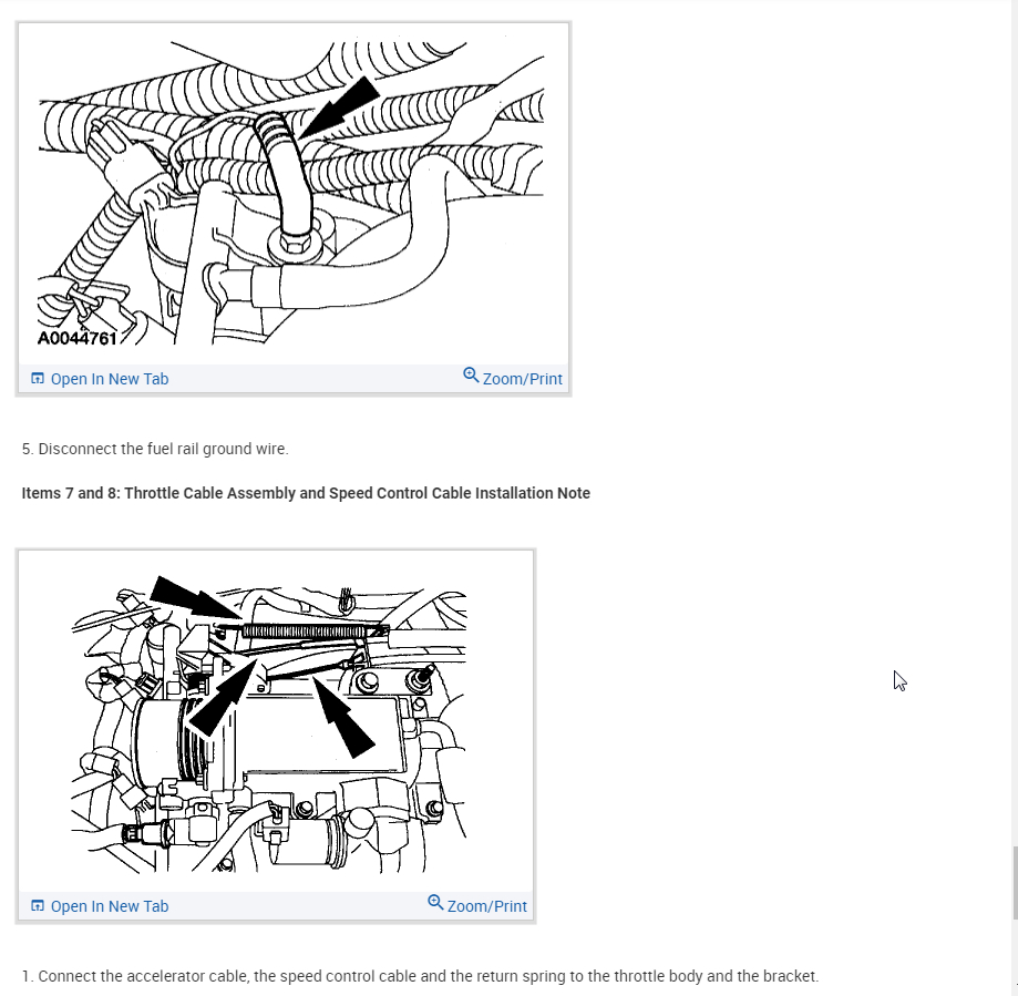

Here are the steps to remove the intake manifold. Let me know if you need more info.
+1
Wednesday, October 30th, 2019 AT 6:11 PM
  • 12 POSTS
Thanks. I watched it on YouTube. The guy had a new intake with built in rubber gaskets. No gasket sealer involved. Looked easier.

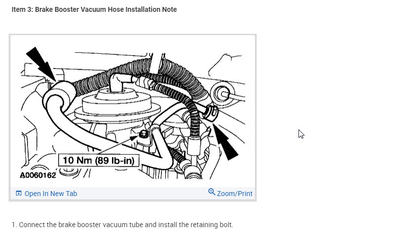

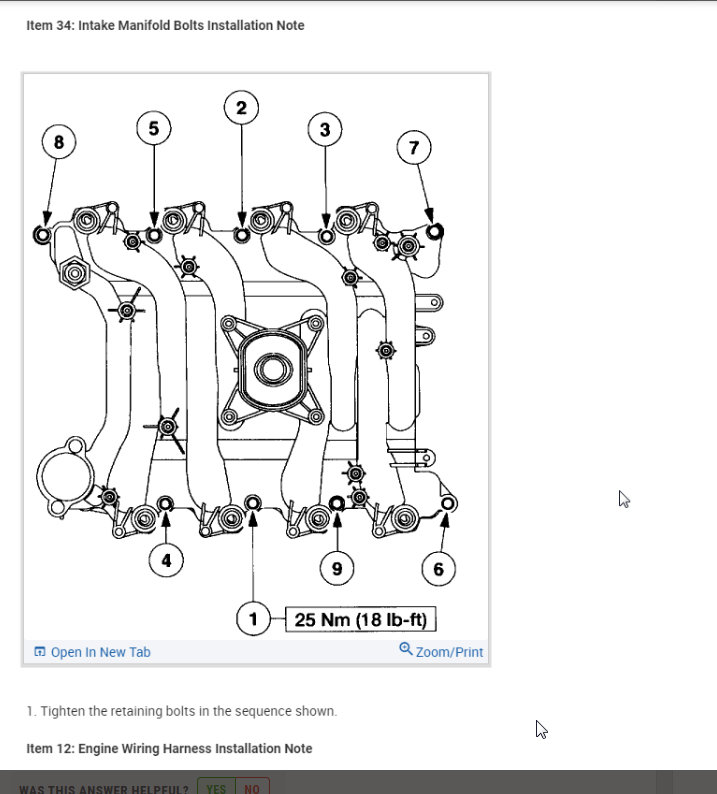

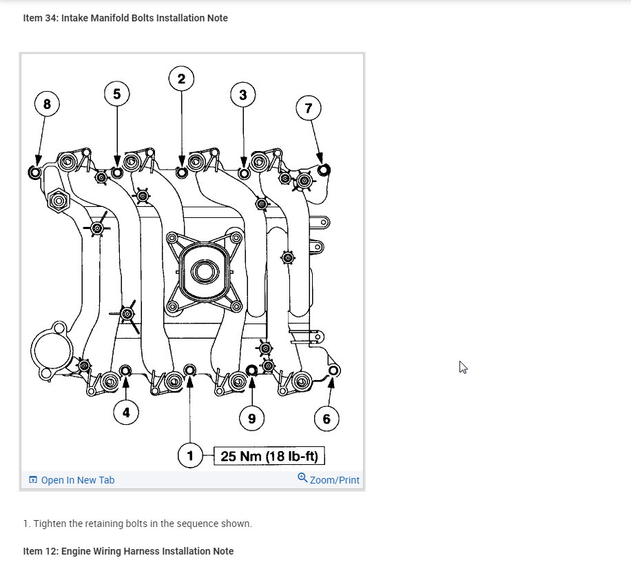

Is there a sequence and what is the proper torq of the manifold bolts?
Thursday, October 31st, 2019 AT 11:53 AM
Yes. The 14th attachment above. I reattached it here.
