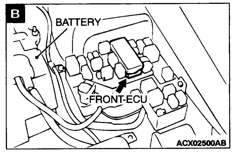

Thank you, that's what I figured. Now I will be checking ECU in engine fuse box or fuse box inside car apparently there's one there too.
Thursday, August 18th, 2022 AT 10:25 PM
  • 110,192 POSTS
There is one there. I attached a pic below showing its location. I hope this helps.
See pic below.

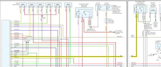

Well, you see my issue is my fuel pump wasn't engaging found out not getting ground side on relay circuit but not sure what to do next. Also seems like my fuel pressure is low or is that from fuel pump not engaging. I used starting fluid to see if car would start and it did but stuck on what to do next on relay or what to check and where. I have the car listed above rt 3.0l v6 6g72 Mitsubishi engine.

If you aren't getting a ground from the ECM, that is why you have no fuel pressure. I'm looking at the wiring schematic (see pic below). The ground signal is provided via a black wire. Go to the ECM on the passenger side and locate that black wire. With the battery disconnected, remove the connector and check for continuity in the wire itself. Also, make sure there is no damage at the connector or corrosion.
If that checks good, then check right at the ECM for a ground path. If there isn't one, the ECM is my first suspect.

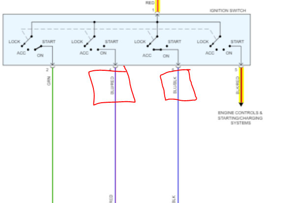

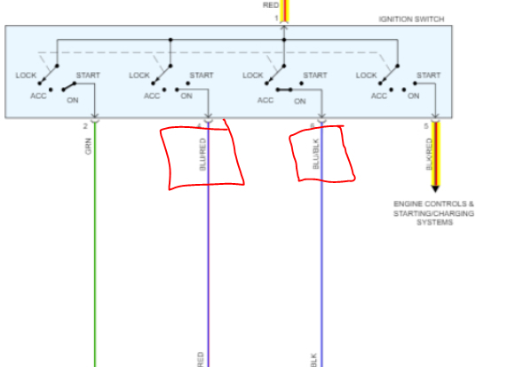

Question in regard to my ignition switch. Now my blue with red tracer and also my blue with black tracer say one says it connects to accessory heater blower 1 and blue and black connect to accessory heater blower 2 now if I'm eliminating ignition column switch and installed push start with accessory toggles how would I wire those two wires.
Saturday, September 24th, 2022 AT 10:24 AM
  • 110,192 POSTS
I'm not sure how you have it toggled, but the blue/black needs power in acc and the run position and the blue/red only should have voltage in the run position.
Is that what you need? See pic below.
