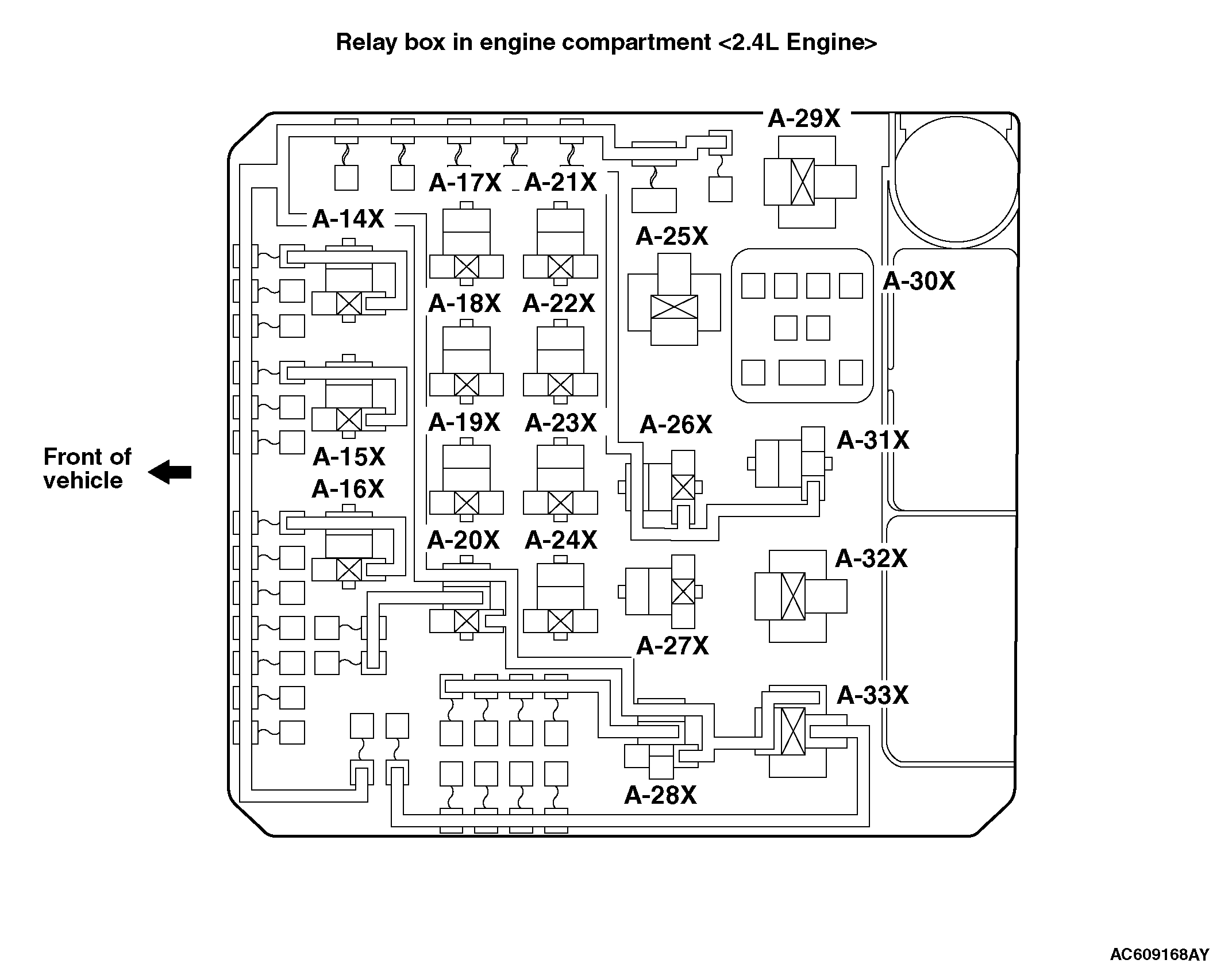

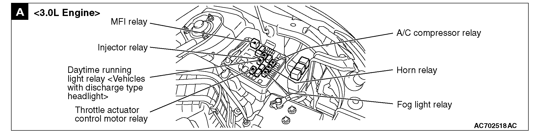

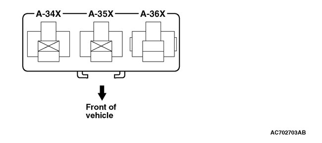

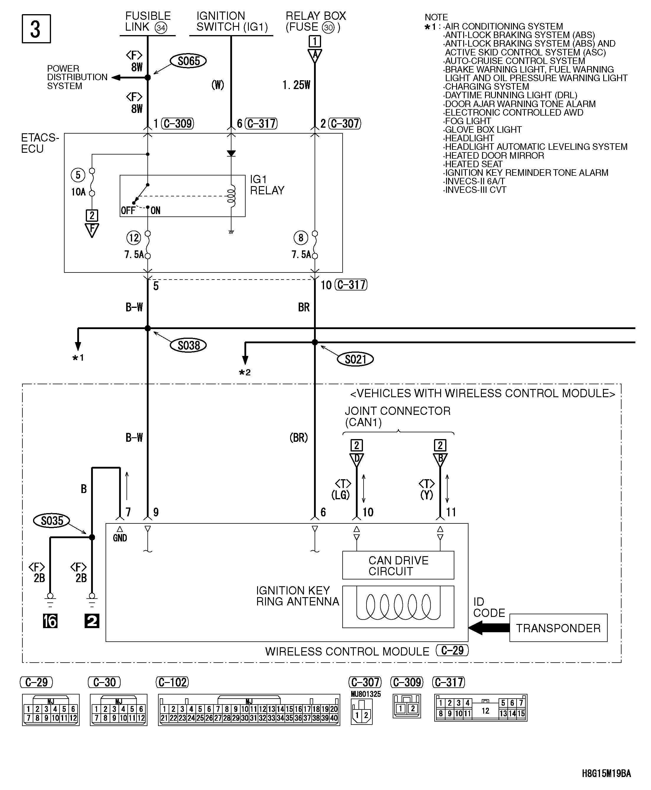

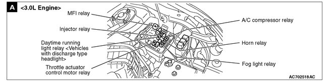

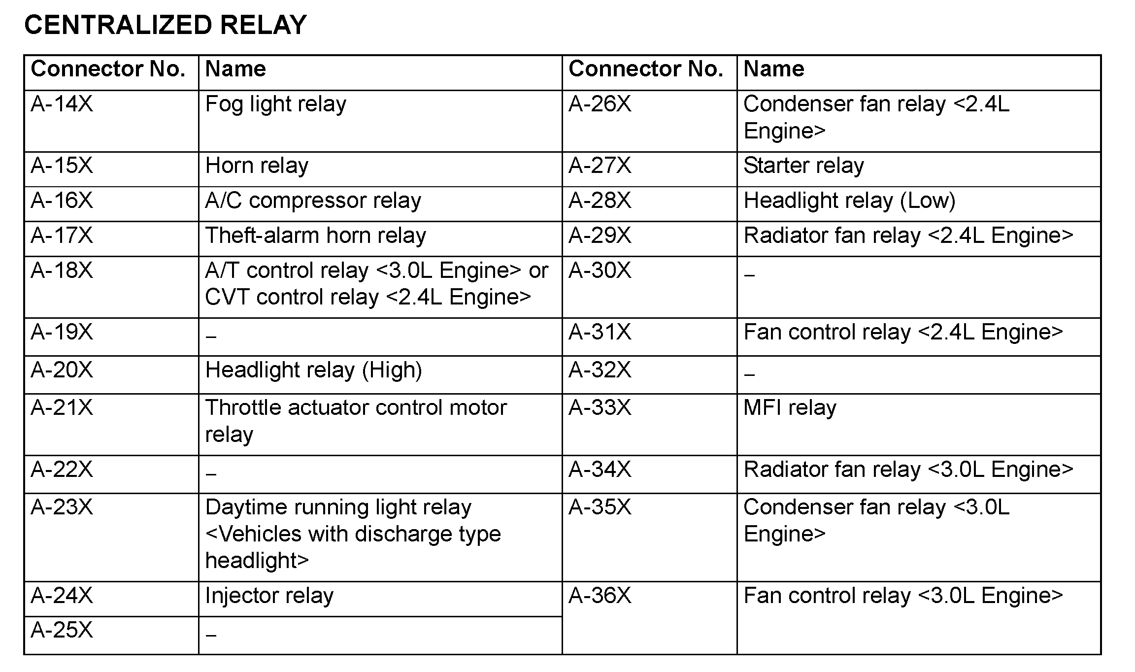

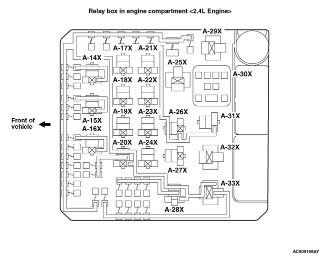

Joe. Can you check again for the ignition relay 2.4 liter and where is it located. It powers the WCM and also the MFI powers the Ignition system
Saturday, October 27th, 2018 AT 11:15 PM
  • 110,194 POSTS
Raz:
Here are the relays.
Saturday, October 27th, 2018 AT 11:53 PM

Joe, gonna check something can you provide a schematic/diagram for the start circuit from the ignition switch to the starter motor
Monday, October 29th, 2018 AT 7:04 PM
CATAFINA
  • 98 POSTS

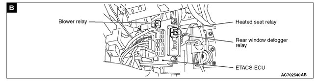

This is the engine compartment fuse/relay box-the relays boxes you given me is entirely different then what I have. After checking most of it -its pointing to the ETACS
See below-this what I have
Tuesday, October 30th, 2018 AT 12:58 AM
  • 110,194 POSTS
Interesting. That is not the picture I have. I have a feeling it is the module.
Tuesday, October 30th, 2018 AT 5:10 PM
CATAFINA
  • 98 POSTS

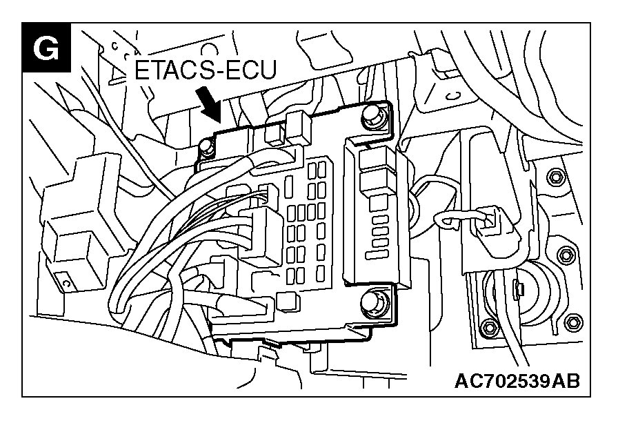

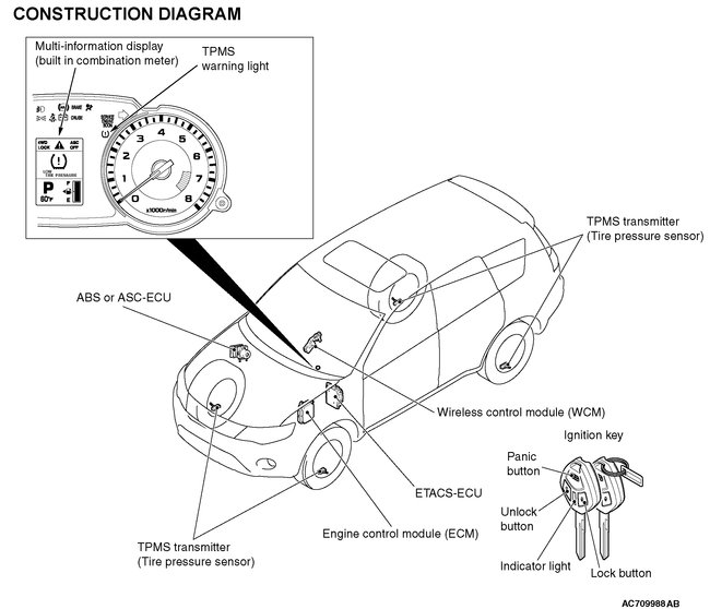

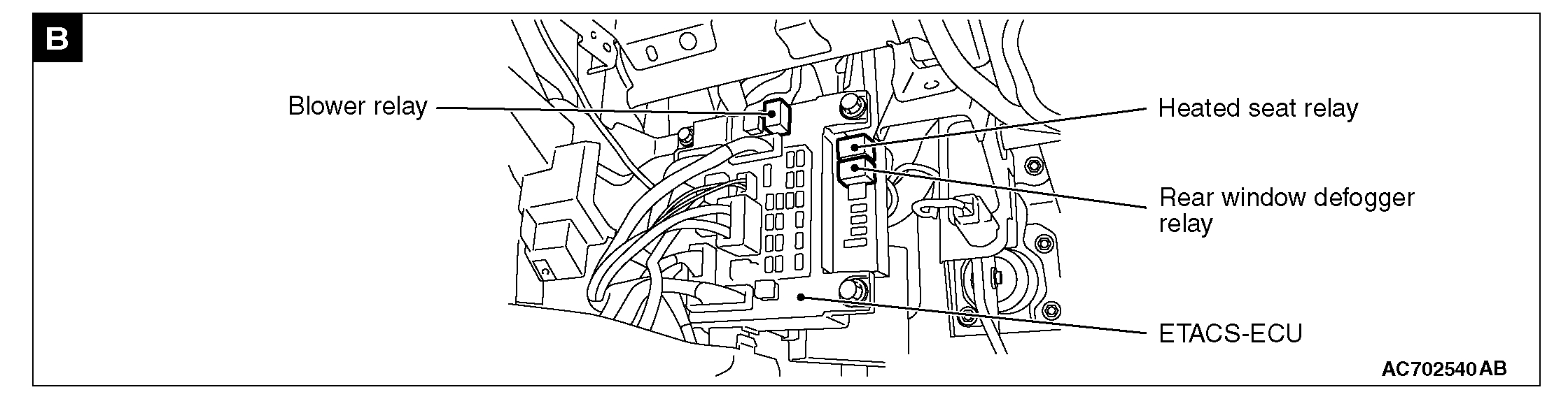

That is what I have physically. What modules the WCM' ETACS or the PCM am prepared to change it no matter what lets get to the bottom of this getting too long on this.
Tuesday, October 30th, 2018 AT 5:15 PM
  • 110,194 POSTS

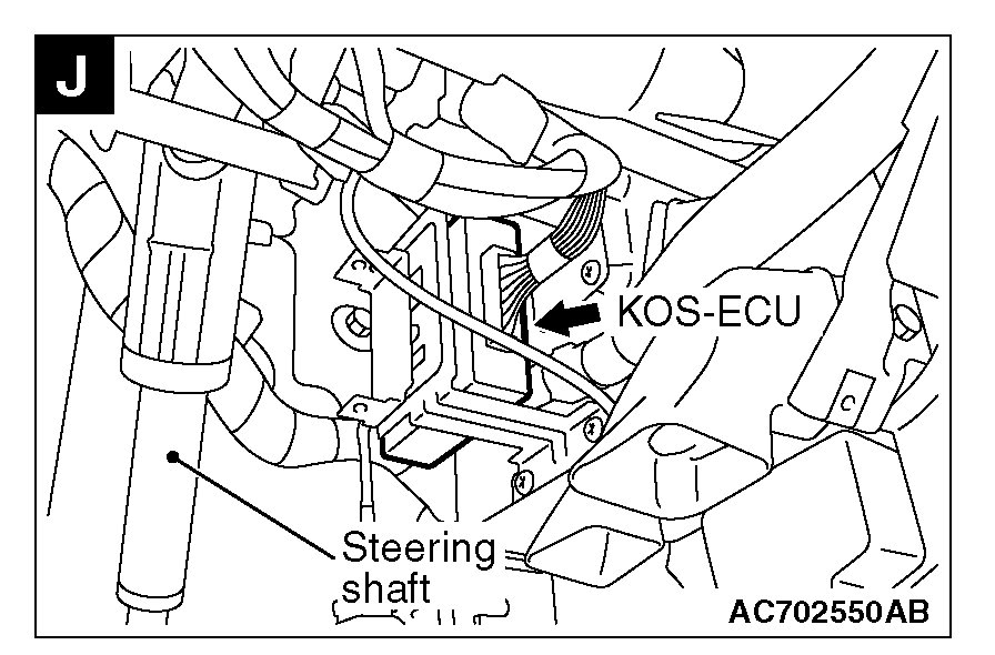

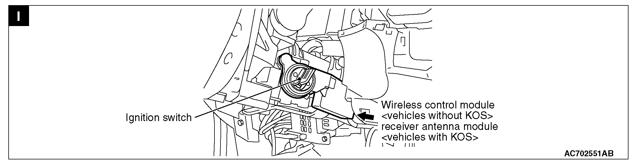

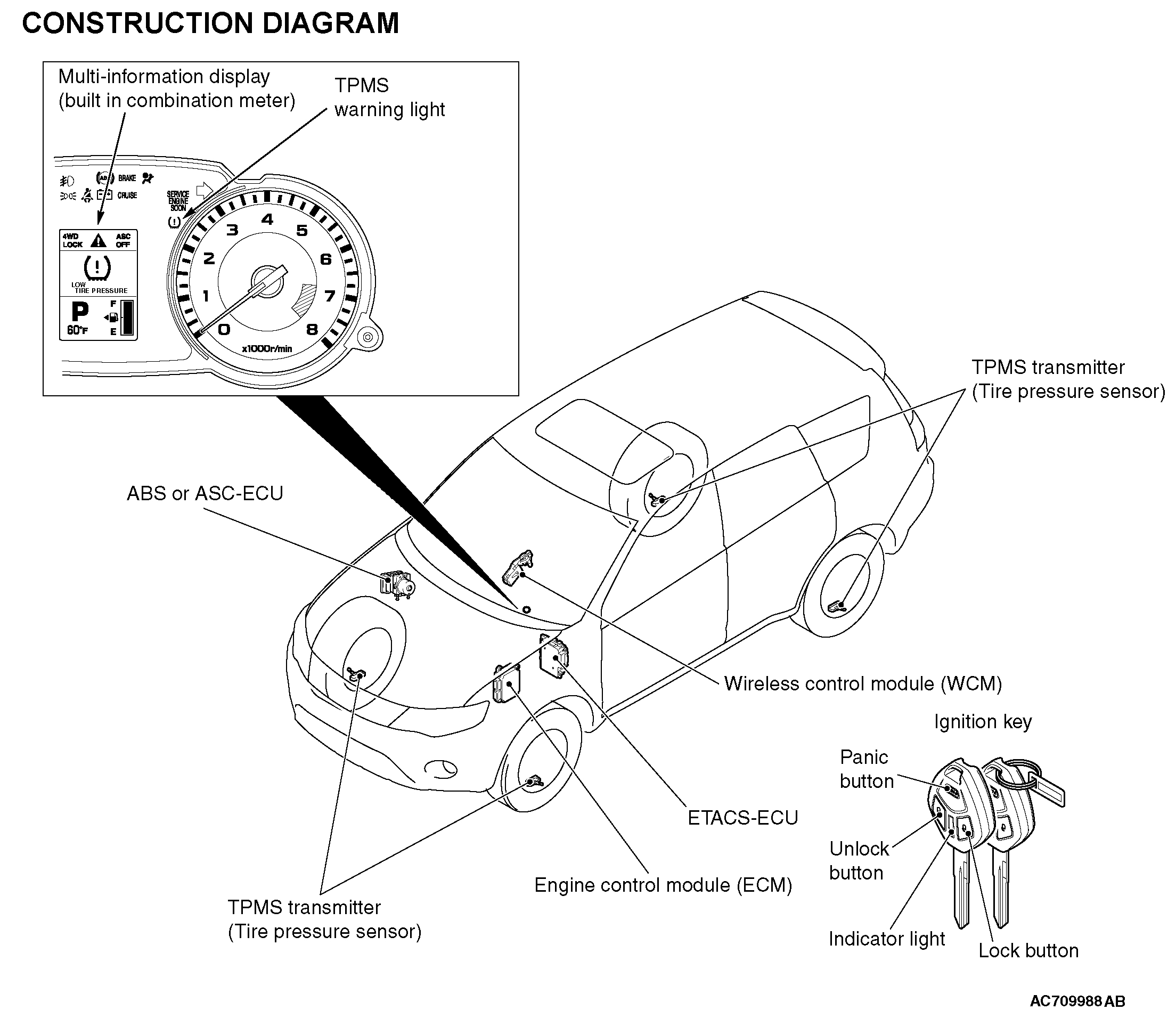

Pic 1 KOS module
Pic 2 and 3 WCM
Pic 4 and 5 ETACS / ECU
Tuesday, October 30th, 2018 AT 6:00 PM
CATAFINA
  • 98 POSTS
KOS module what does it really do
Tuesday, October 30th, 2018 AT 6:14 PM
CATAFINA
  • 98 POSTS
Looking for the KOS Module no where to be found underneath as picture describe/resemble nothing there-suppose to be there right side of steering shaft.
