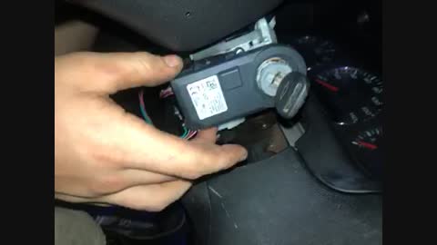

It is always been solid on since the problem came out of no where. It was going out after I replaced the anti theft immobilizer but my battery lost juice shortly after. Didn’t have a charger at the time but had a brand new battery that I swapped out with and now it won’t go out no matter how long I wait. I don't know if I’m doing something different or what. And unfortunately I do not have that tool, I’m limited on supplies and when it comes to security systems I lack a lot of knowledge. Thanks for your quick response and assistance with this frustrating issue.

I’ve checked the obd2 codes like the basics but nothing appears on the scanner.

Okay, I did some checking and everything is showing the need for a scan tool. Here is what I suggest: Disconnect the battery, remove the module, keep it out for at least 10 minutes, and start over. See if having it disconnected allows you to get things to reset.
If you want the relearn procedures, please let me know.

Is this the only possible way? Thanks for your help again sir. Most help I’ve gotten in months. And a little of a off subject question does the immobilizer module have to be reading a specific ohm reading?

Does the immobilizer module have to be reading a specific ohm reading? If so how many times does the copper wire have to be wrapped around or what is the required ohm reading? Last question I have. Thanks again Joe.

B3031 is the code.
Friday, March 12th, 2021 AT 9:02 AM (Merged)
STEVE W.
  • 15,700 POSTS
B3031 is the code that says the system is in the key learning mode. It sounds like you had the module in learn mode when the battery failed. Then putting in the new battery didn't change that. From the description I would have a dealer or shop try to re-flash the programming in the module and then program in the keys. As the battery went flat while you were in the learning mode and you replaced it that may have been the reason why it suddenly started acting strange in the first place, newer cars are very touchy about the battery condition and voltage.

So I’ve replaced anything and everything for the most part.I went through the 30 minute relearn cycle successfully twice now and when it came to the turn that was supposed to fire it up and be completely successful nothing happened, it just clicked and that’s it. So I thought well maybe a fourth time will work but now the light is not turning off again. I didn’t do anything differently since it was turning off and haven’t touched anymore parts. I’ve been working day and night on this piece of junk to no avail. Currently getting evicted over this and just really needing it fixed soon so I can at least have a car to move out with. I have no more money for tow bill or mechanical help and I’m beginning to lose hope. Crazy how something so simple could wreck such havoc on a persons life. Heck, it would’ve been better if someone did steal my car. Thanks GM you’ve done it again!

You will need to use a dealer level scan tool and the access to GM to make all of the system operate. The 30 minute relearn only works when everything is already initialized and working and you only add a key or change the cylinder. As you have replaced multiple parts that all need to be programmed to work together, the scan tool is the only real option. No DIY way around that. Same routine on all makes and models these days, with some being far worse.
