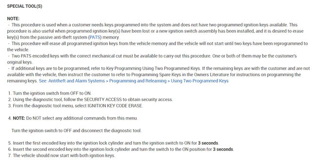

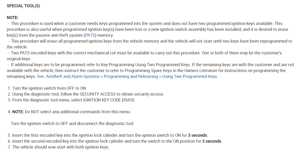

Theft security immobilized engine won't start. Lost original key. Bought new key, no new fob with it. What to do to start my car? My theft light keeps blinking and my car won't start. Is there a fuse I can disable the security lock system to start my car? Please help.
-1
Tuesday, December 15th, 2020 AT 3:18 PM (Merged)
KEN L
  • MASTER CERTIFIED MECHANIC
  • 55,538 POSTS
Not really, the system needs to work for the car to start. lets try to reset the system by following this guide I also have included how to relearn a new key in the diagrams below.
https://www.2carpros.com/articles/how-to-reset-a-security-system
KEY PROGRAMMING USING TWO PROGRAMMED KEYS
NOTE:
- This procedure only works if two or more programmed ignition keys are available and it is desired to program additional key(s). If two keys are not available, follow the procedure in Key Programming Using Diagnostic Equipment.
- PID SPARE_KY must be enabled for this procedure to operate. If this PID is not enabled, follow the security access procedure above and select Spare Key Programming Switch: Enabled.
- If the programming procedure is successful, the new key(s) will start the vehicle and the THEFT indicator will prove out for approximately 3 seconds.
- If the programming procedure is not successful, the new key(s) will not start the vehicle and the THEFT indicator will flash. If the programming procedure was not successful leave the ignition switch in the RUN position for at least 30 seconds, repeat the key programming procedure from Step 1. If the failure repeats, refer to Diagnosis and Testing to review DTCs and carry out pinpoint tests as required.
- A maximum of eight ignition keys can be programmed in normal mode to a passive anti-theft system (PATS) equipped vehicle. If more are required, refer to Key Programming - Unlimited Key Mode. See: Antitheft and Alarm Systems > Programming and Relearning > Unlimited Key Mode
- If the steps are not carried out as described, the programming procedure will end.
- Ignition keys must be the correct PATS encoded key type.
- If the vehicle is in unlimited key mode, this spare programming procedure still functions. Any two keys that can start the vehicle may be used to program an additional unlimited key.
1. Insert the first programmed ignition key into the ignition lock cylinder and turn the ignition switch from OFF to RUN (maintain the ignition switch in RUN for three seconds, but no more than ten seconds).
2. Turn the ignition switch to OFF and remove the first coded key from the ignition lock cylinder.
3. Within 10 seconds of turning the ignition switch to OFF, insert the second programmed ignition key into the ignition lock cylinder and turn the ignition switch from OFF to RUN (maintain the ignition switch in RUN for 3 seconds, but no more than 10 seconds).
4. Turn the ignition switch to OFF and remove the second coded key from the ignition lock cylinder.
5. Within 20 seconds of turning the ignition lock cylinder to OFF, insert the unprogrammed ignition key (new key/valet key) into the ignition and turn the ignition switch from OFF to RUN (maintain the ignition switch in RUN for 3 seconds). This step will program your new key to a coded key.
6. If it is desired to program additional key(s), wait 30 seconds and then repeat the key programming procedure from Step 1.
- If the programming of the new key is successful, the new coded key(s) will start the engine and the theft indicator will illuminate for 3 seconds and then go out.
- If the programming of the key was not successful, the new coded key(s) will not start the engine and the theft indicator will flash rapidly on and off. REPEAT Steps 1 through Step 5. If the failure repeats, refer to Key Programming Using Diagnostic Equipment

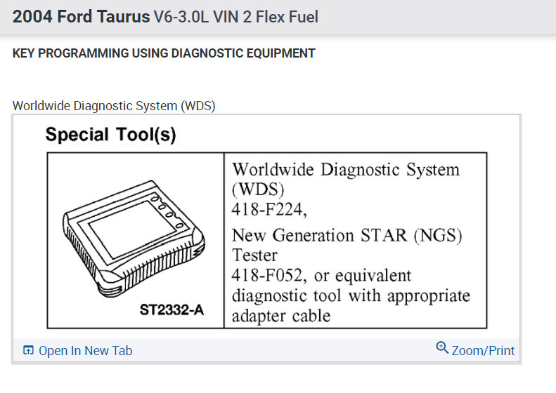

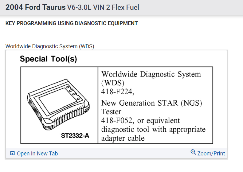

KEY PROGRAMMING USING DIAGNOSTIC TOOLS
PROCEDURE #1
1 key required. Cycle key to RUN. Enter "Ignition Key Code Erase." Disconnect Tool and leave key in RUN for 20 seconds. Cycle key to OFF and then RUN.

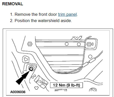

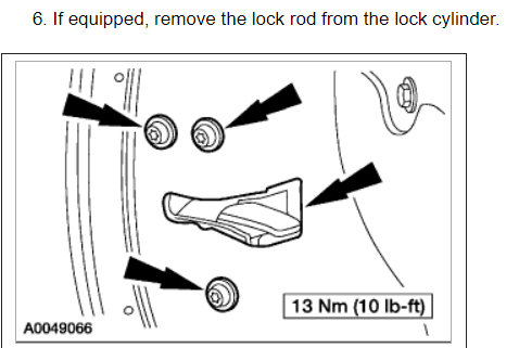

My 2004 Ford Taurus, has a factory car alarm. I have noticed that when the outside air tempature goes below 40 degrees, the alarm will go off. I have to go outside turn the alarm off. It maybe another 30 or 45 minutes then it goes off again. What could be causing the problem. Is their away to turn the alarm system off completely? I know my neighbors are getting upset that my alarm keeps going off:(
Wednesday, December 16th, 2020 AT 8:04 AM (Merged)
KEN L

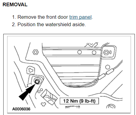

  • 55,538 POSTS

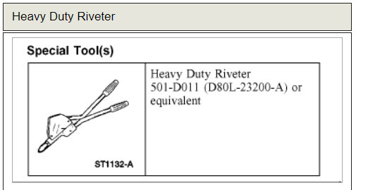

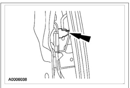

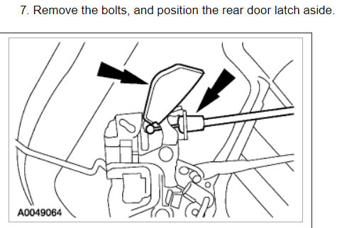

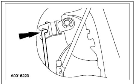

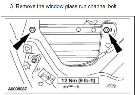

9 times out of 10 it is the drivers door door latch which needs to be replaced because the switch inside malfunctions causing the alarm to go off. You will need to remove the door panel to get to the latch to change it. Here is a guide that will give you an idea of what yo are in for when doing the job.
https://www.2carpros.com/articles/door-panel-removal
Here is a diagrams to help you see what you are in for when changing the latch.
-1
