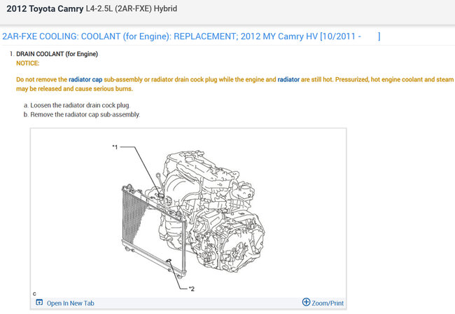

I am looking for amount of coolant in my hybrid car, i tried to look for it but failed
How much my car coolant capacity in detail
I mean:
In radiator
In engine
In reservoir
In inverter
In condenser
And total in liters
And the best way to drain most of it, as i know most of the coolant will be in the engine.
Thanks
Feb 18, 2025 at 12:23 PM
  • 54,503 POSTS

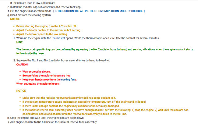

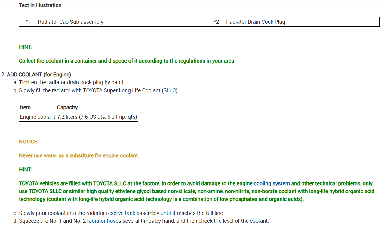

The engine's cooling system has a total capacity of approximately 7.7 quarts (7.3 liters). Here is a guide to help you service the system with instructions to do the job on your car in the images below.
https://www.2carpros.com/articles/coolant-flush-and-refill-all-cars
Toyota recommends using Toyota Super Long-Life Coolant (SLLC). Check out the images (below). Let us know if you need anything else.

1. once i bleed the radiator and reservoir and want to replace them the amount that i will add will be less than 7 liters as i know there will be coolant remaining inside the engine, right?
If yes, how i can bleed the engine coolant? Is it necessary?
2. You didn't mention the coolant of inverter and its amount; can you send me how to replace the inverter coolant?
Thanks
Feb 19, 2025 at 2:03 PM
  • 54,503 POSTS
Yes there will be coolant left inside the engine block. You don't need to bleed the system just go over the guide in the post above. Please make a new post for the inverter coolant.
