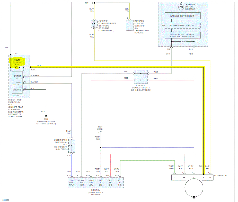

What does it mean when my alternator isn't getting power but the battery is sending power to the alternator?
Dec 4, 2020 at 1:58 PM
  • CAR REPAIR CONTRIBUTOR
  • 110,193 POSTS
If you have no power at the alternator, it could be a few things. It could be related to a blown fuse, a faulty alternator, or a broken wire.
How was the alternator checked? What wires were checked on the alt for power?

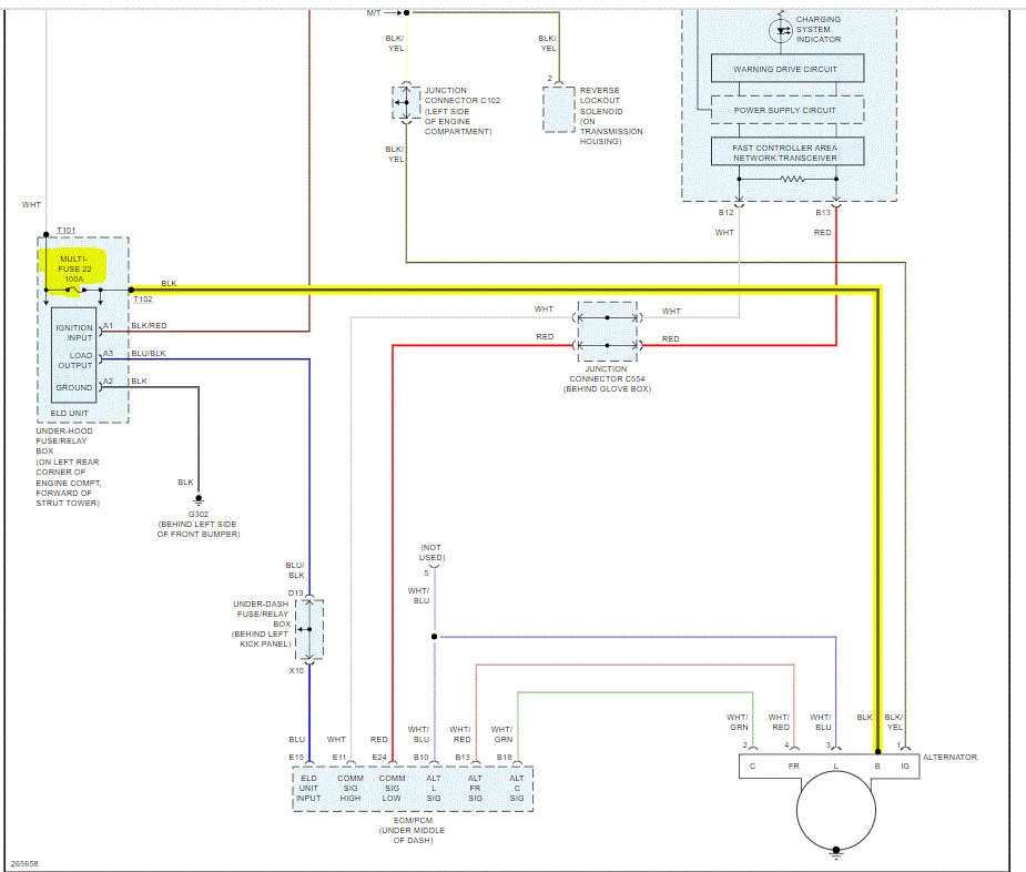

If you look at the attached pic below, it shows a portion of the wiring schematic related to the charging system, Check the fuse I highlighted and let me know what you find. Also, make sure there is power both to the fuse and out from it. Here is a link you may find helpful:
Let me know. Also, let me know exactly what is happening. I assume the alternator isn't charging; however, I want to confirm it.
