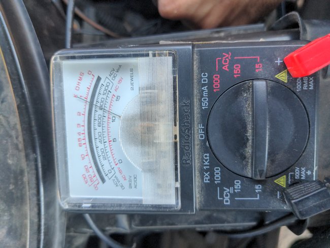

Okay, got a digital meter here are readings.
Small terminal driver side : 11.43.
Small terminal middle : 0.45 - 0.50.
Large cable : 46- 47 V (had to use 200 not 20v to measure).
That help diagnosis?

You can't have 47 volts in a 12-volt system. Are you using an auto-ranging digital voltmeter? I've used a friend's a few times, and have always made mistakes by overlooking the range the meter selected for me, especially when the "mv" is so tiny you can barely see it. If you're actually getting.47 volts on the output stud, the fuse link is burned open. That would be due to the previous owner connecting the battery backward. There's six diodes inside the alternator. Those are one-way valves for electrical current flow, and they're in there backward, which is what prevents the alternator's stator windings from being a dead short to ground. When the battery is reversed, that puts the diodes in there in the "forward-biased" direction, and they act like a piece of wire. That will burn open the fuse link wire.
With the fuse link burned open, you'll find 0 volts on the alternator's output stud with the engine off. At the same time, since you have a new / good alternator, the voltage regulator is going to be doing everything it can to get system voltage up to 13.75 to 14.75 volts with the engine running, but it's not going to see success. Now you'll find high voltage on the output stud, as in perhaps 16 to 18 volts. For demonstration purposes in the classroom, I've been able to get as much as 35 volts, but that's with no voltage regulator in the system, and only to prove what is possible when we use invalid troubleshooting techniques.

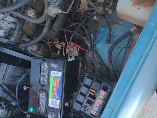

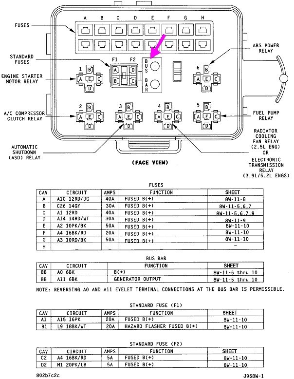

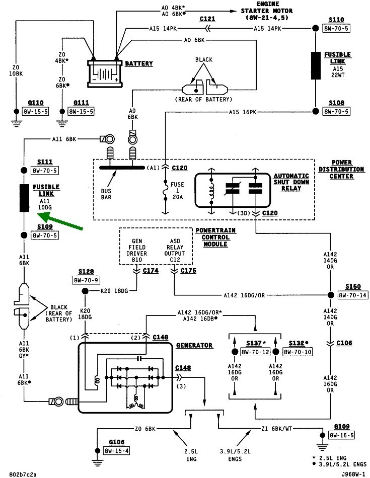

From what I see on the diagram, there's two studs on the Power Distribution Center, (under-hood fuse box). On one off them, 12 volts comes through a black bullet connector and wire from the battery. The fuse link wire is connected to the other stud. On newer models, they use a regular fuse and sometimes two, built into the battery cable clamp, but yours is shown as a wire.
Wednesday, December 30th, 2020 AT 9:29 PM
MICHAEL EMULATE KAI
  • 23 POSTS

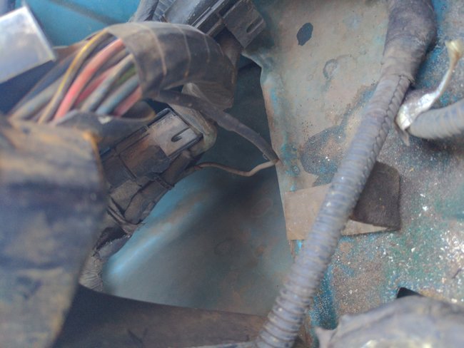

Still a bit lost. Is the disconnected black bullet connector the one you're referring to?
Thursday, December 31st, 2020 AT 8:41 AM

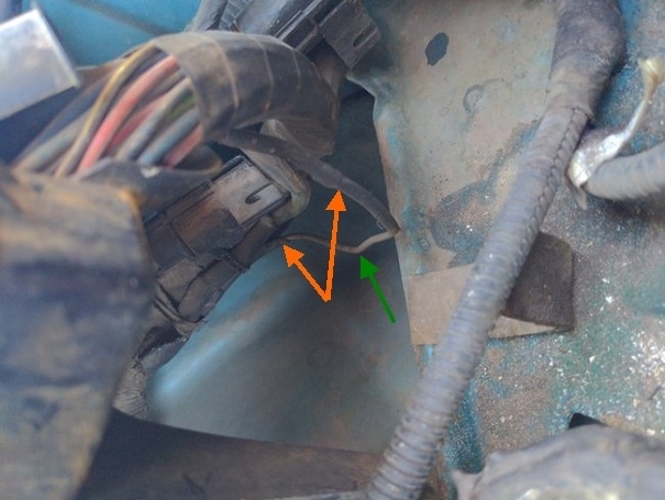

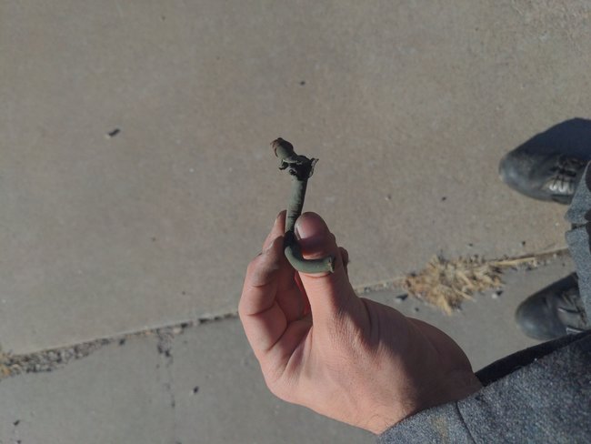

Is this isolated wire the fuse link?
Thursday, December 31st, 2020 AT 8:43 AM
MICHAEL EMULATE KAI
  • 23 POSTS
Located and removed. It's a 10 gauge. Fuselink. Do I need souldering or can I splice it in?

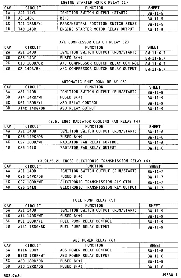

Rats. You got ahead of me. I'm going to post these photos anyway for the benefit of others who may research this topic.
First of all, I see the reason for some confusion. The first drawing is of your Power Distribution Center, (PDC), under the hood. I had expected to see the two buss bar studs in one corner, sticking out from the box. In fact, yours are tucked away in the middle, as shown with my purple arrow. You should be able to reach down in there and measure 12 volts on both studs all the time. For your current problem, I suspect you'll find 0 volts.
In the third photo, you did find the bullet connector. I added red arrows to it.
In the fourth photo, you found the fuse link wire. It's common to hide them away as you don't have to access them very often. On the older front-wheel-drive cars from the mid '80s to mid '90s, you'll find a whole bunch of fuse link wires wrapped together in a bundle going around the left front strut tower. The two orange arrows are pointing to the moisture-proof heat-shrink tubing used at the factory. The green arrow is pointing to the fuse link wire itself.
To replace the fuse link, cut the 6 gauge black wire just beyond the heat-shrink tubing on both ends of the fuse link. Strip those back about a half inch. Be sure the copper wires are clean and shiny, otherwise solder won't adhere to them. Cut a piece of the new fuse link long enough to easily connect to the two black wires, and strip those ends. When splicing the joints, it's easiest to not twist the ends together like you would with house wiring and wire nuts. That makes them too hard to seal. Instead, overlap the two ends, and twist them around each other to make a good mechanical connection first, then solder them to make a good electrical connection.
When the first joint is soldered, slide on a piece of moisture-proof heat-shrink tubing, and warm it with a lit match or hot-air gun until the glue oozes out on both ends. Don't try to use electrical tape. That will unravel into a gooey mess on a hot day.
The next step is one we often forget. Slide a second piece of heat-shrink tubing onto one of the wires where it will be far enough away from the heat of the soldering iron. Curl the two remaining wires around each other, then solder them. Before you slide the heat-shrink tubing over the joint, feel for sharp points left from an end of one of the wires sticking up. If you find any, squeeze them down with a needle-nose pliers so they don't poke through the heat-shrink tubing over time. Warm that tubing, and you're done.

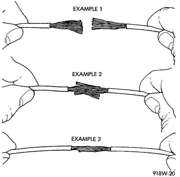

The fifth drawing shows the recommended splicing method. I prefer example 2, but that has the greater potential to leave sharp points sticking up that are easy to overlook. With larger diameter wires, some people will take a single strand a few inches long and wind it around the joint to hold it together while they solder it. The method I'm recommending is example three. It's faster and easier.

So in response, ordered a length of proper 10 gauge fuse link. Going to do a real splice job when it's delivered. To test it I had some alligator clips and a regular length of 10 g wire. Charging at 15v solved the issue very quickly. Appreciate the full explanation and as soon as the fuse link wire arrives I will do a proper solder and heat shrink job I have that just not the proper wire.
For anyone else wondering like myself. Yes, it will work with a regular wire. The fuse link is important because it's mostly fire proof insulation, unlike regular wire. So I won't be using this temporary fix more than a few days.
Chose alligator clips to make it easily removed.
Hope you don't scold me for proof of concept for myself but it was definitely just that.
Thank you again. I hope this helps anyone else who has my issue!
