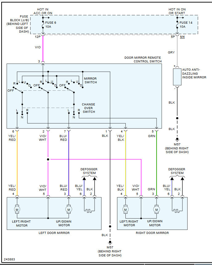

was sitting waiting for someone to come out i turned my side mirror nob and everything went black, but it all works outside.

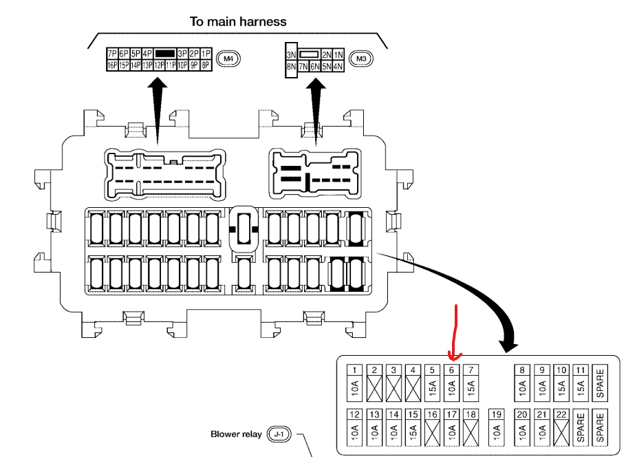

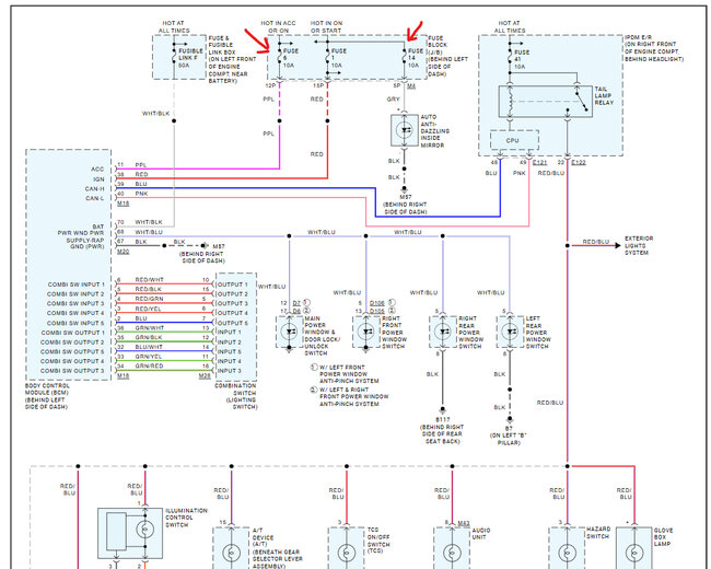

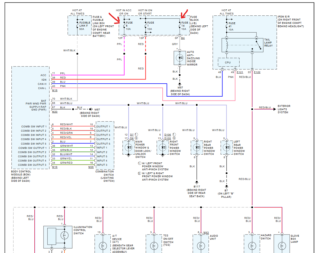

There is a number 6 fuse in the fuse panel on the left side of the dash that sounds like when out, here is a guide to help and the fuse locations for clarity:
Apr 13, 2025 at 1:08 PM
BMAN1G
  • 48 POSTS
yes all the running lights and blinkers working and there is no number 6 fuse.
Apr 14, 2025 at 12:01 PM
  • 54,503 POSTS
Are you talking about the lights for the radio during the day or night? Also, with the systems on I would check all fuses. Please use the guide.
Apr 15, 2025 at 9:19 AM
BMAN1G
  • 48 POSTS
All dash lights are off radio too can't see my speed or anything.
Apr 15, 2025 at 11:30 AM
  • 54,503 POSTS

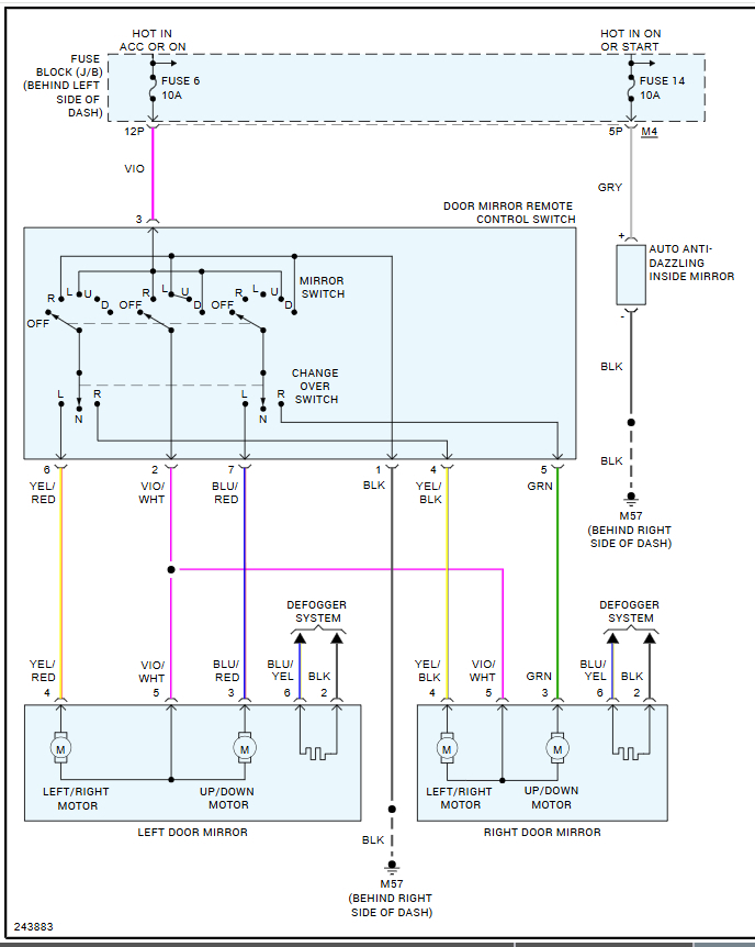

There should be a fuse #6. Did you check the fuse panel inside the car under the dash? Please check out the wiring diagrams below to see what I am talking about.
