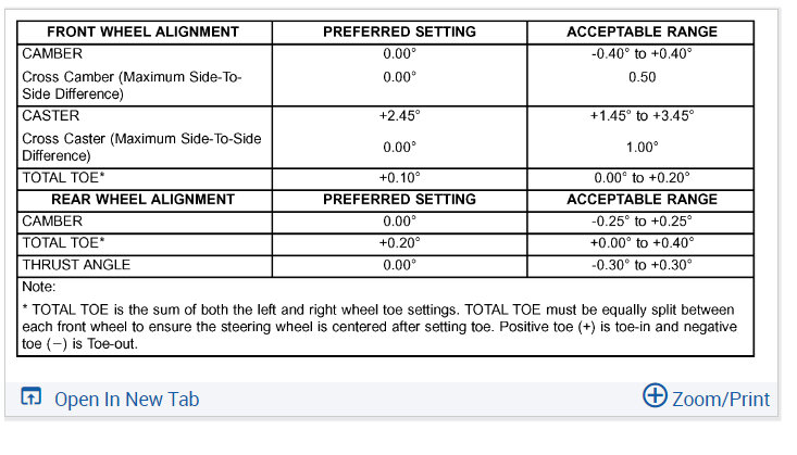

I had my alignment checked one mechanic said it's good another said it needs fixed how bad is it?
Front driver side. Camber 0.9° Caster 2.6° Toe -0.53°
Front passenger side Camber 0.7° Caster 3.2° Toe 0.27°
Rear driver side Camber 0.2° Toe 0.34°
Rear passenger side Camber -0.1 Toe -0.25
Thrust angle 0.29
This vehicle has been in a minor front-end collision in the past.

How does the car drive and how are the tires wearing? This is an indication of how bad the alignment is. These specs don't seem too bad to me. Here are what the book specs are. Check out the images (below). Let us know if you need anything else.

Car drives good, no weird vibrations or anything, Tire ware looks uniform. Thanks for your help.
