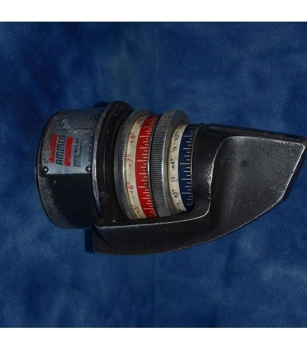

I just bought a used alignment computer on an auction, exactly like the one I used at the dealership. Problem is my garage is packed with house stuff after I had a house fire, so there's no room to put a hoist, and I don't have the turn tables yet. Took me an hour of moving furniture around so I could shoe-horn the computer into the garage. This model was an $18,000.00 computer when the dealer bought it for me in 1995. I got it for $300.00 at the auction.
There's a better alternative for you if you're going to do this kind of work multiple times. That is to look for an old mechanical caster / camber gauge at repair shop auctions or places like eBay. The gauge sticks to the hub magnetically, and you have to transfer it from wheel to wheel. Also, for front-wheel-drive cars, there are screw-on adapters that screw onto the stub axle / end of the outer CV joint. You might have to remove the cotter pin and stamped retainer so the adapter can butt up tightly to the axle nut. We had different adapters with different threads for different car models.
The Ammco gauge I used is shown in the photo. It's about 7" to 8" long. Another type can be seen by searching for item # 352689371546 on eBay, and there's item # 372655163514 that includes a rim clamp that will work on any vehicle.
The issue still is the tires have to be able to slide out when the suspension is settled. That requires the turn tables. When caster isn't important, you could fashion a pair of boards that sit on multiple pieces of electrical conduit, or galvanized water pipe. That would help, but it won't let the wheels turn slightly as the lower ball joint moves out but the tie rod linkage doesn't. Using my imagination, I'd try to find the large steel balls I used to save from outer CV joints or pressed-in front wheel bearings, and put a bunch of those between two thick boards. For this to work for measuring camber, the two boards have to be the same height so the front of the car is level from side-to-side. If the rear tires are on ground that's higher or lower, that would only affect the caster readings, but those don't affect pulling on front-wheel-drive cars, so it doesn't pay to try to measure it.
If you had one of the mechanical gauges, they all measure camber directly by adjusting a level so the bubble is centered, then you read the number where an arrow is pointing to the camber scale. If you wanted to measure caster, the gauges have you turn the wheel to the left, center the camber level, turn to the right, center the bubble with a different adjustment, then read caster on another scale. Basically, since caster causes a wheel to lean out on top when steered out away from the car, and it leans in when steered toward the center of the car, the amount of camber difference is proportional to the caster value. That's why two camber readings are used to calculate caster. The problem with this is the more you turn the wheel left and right, the higher the caster will appear to be. To eliminate that variable, all the gauges specify how far to turn each wheel, and you need the turn tables for that. They have a protractor scale to show how many degrees you turned that wheel. Most gauges are calibrated to be accurate when you turn the wheel out 20 degrees, set the bubble to level, then turn the wheel in 20 degrees, level the bubble, then take the reading.
After becoming accustomed to the precision of an alignment computer, I don't want to go back to mechanical gauges. Those were good enough for older rear-wheel-drive cars where a tolerance of 1/16 degree was okay, but today a lot of cars need the computer's precision that gets down to 0.01 degree.

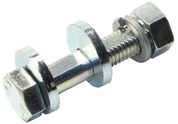

I see the problem with the cam bolts you were given. Those are for use with GM's original struts that don't have the elongated lower hole. The bolt is skinnier except for the small section in the middle. That part stays centered within the hole, then as the rest of the bolt is turned, since it's offset, it moves the head in and out. The special washer has two tabs to lock it to the strut, so the bolt head pushes and pulls on the strut to move it.
You need the bolts that look like that in this photo. You'll see your replacement struts have a shoulder for the offset washers to push on. This bolt will be the same diameter as what you removed. The flat side is only there to key the washers to it.

The kit you were given is for use with the original struts that don't have the elongated lower hole.
Okay, after 35 miles, three auto parts stores, and a dealership, I finally found the correct part when speaking with an alignment specialist at a Firestone store. It's part # 41-8245 in the Northstar catalog. They show three sizes for three different groups of GM vehicles.
Towards the end of my journey, it occurred to me you don't need any of these special bolts. They are all alignment aids, not necessities. You can use both of the original bolts, but setting the wheel to the desired setting can be a tedious trial and error affair. You have to loosen the top nut just enough to remove its clamping force. The bottom nut has to be backed off to the end of the threads, then the bolt has to be tapped out far enough to slide the serrations out past the flange on the strut. Push or pull the wheel to where you want it, then tighten the bolts. The fellow at the dealership said he uses a helper to hold the wheel in position while he crawls underneath and tightens the bolts. When I did these myself, I tightened the top bolt just enough to hold the wheel, but still loose enough that I could force it to move.
Rather than using that force, and getting frustrated at having to do it over and over, the cam bolt allows you to make the adjustment by slowly turning the bolt. The eccentric washers push the strut one way or the other, and then holds it there while you tighten the bolts.
I remembered the cam bolts were blister-packed on a piece of white cardboard. Upon doing a search for "Northstar alignment aids", I found "Specialty Products Company. That sounds familiar, but I don't know where to buy these parts locally.

I never used this type of kit, but regardless of what you use, remember these are all just alignment aids. When you elongate the lower hole with a die grinder, or install new struts with the elongated hole, that hole allows you to choose where to adjust the strut to so you can fine tune the camber setting. That can all be done with the two original bolts. Knowing how much to loosen the bolts so the strut can be moved in or out without it slipping too far from gravity takes experience, a lot of frustration, and usually trial and error. These alignment aids are just designed to take out some of the frustration and trial and error. You don't have to use any of them because once you have the wheel set where you want it, it's up to the clamping forces of the bolts to hold it there. The cam bolts that I listed help hold the strut from moving or slipping when you hit pot holes. The type you have is best for setting the position without having to resort to muscle to get the strut where you want it.
Your bolt allows the spindle to be moved in and out by sliding the upper hole in or out. The elongated lower hole allows for the same adjustment by sliding the lower hole in or out. You actually have two means now of adjusting camber.
