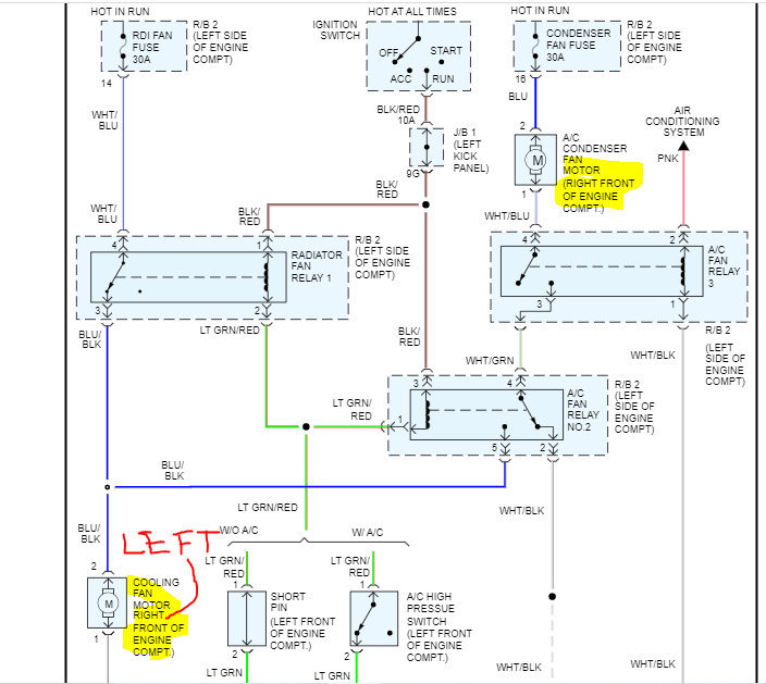

Does this car have a fan assembly for the radiator and another one for air conditioning?
1993 TOYOTA CELICA
175,000 MILES • 2.2L • 4 CYL • 2WD • AUTOMATIC
TJANGEL
I have a fan assembly for the radiator and another one for air conditioning. Looks like it has a place for a second assembly, but I can't see where the wire connector is. The A/C doesn't work but it has all parts.

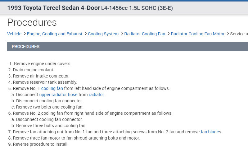

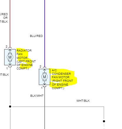

I'm reading through the manual, and it indicates that it should have two. See pics 1 below. As far as the A/C, have you checked anything related to it? For example, have you checked to make sure it is charged? Have you checked fuses?
Do me a favor. Take a look through this link and let me know if it helps. It explains the most common causes of an A/C not working or weak.
Let me know if it helps or if you have questions.
See pic below. Note: Please ignore pics 1 and 2 below. I can't get them to delete.
