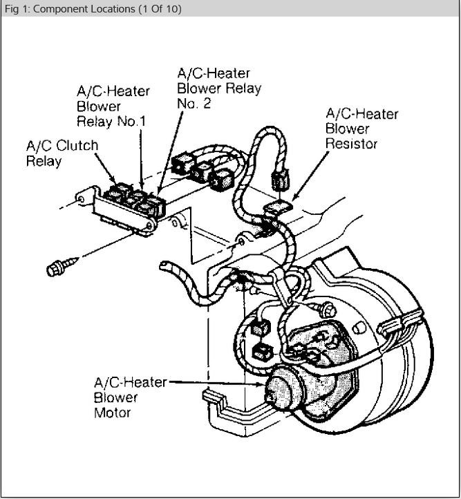

CORNGOLD3
  • 1991 GMC SIERRA
  • 5.7L
  • V8
  • 2WD
  • 132,000 MILES

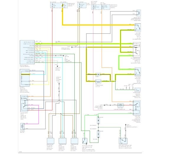

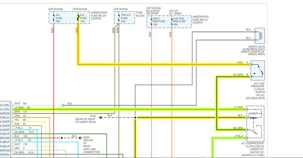

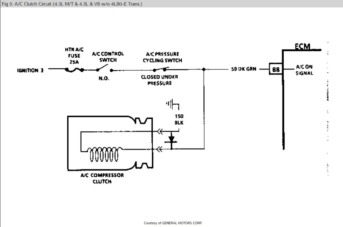

Truck listed above is a C1500. When I push the A/C button the clutch assembly does not engage to turn the compressor on. I have ran a wire from the positive terminal to the A/C harness and the clutch then engages. I replace the low pressure/cutoff switch on the accumulator but it still does not work. I have a new compressor, accumulator, any idea what's going on with this unit?
Friday, December 18th, 2020 AT 9:47 AM (Merged)
94 TRANSAM
  • 680 POSTS
I would start with the A/C clutch relay.
Location is behind the right side of the dash sitting on top of the air-box. See diagram below.
Make sure you check the fuse and confirm voltage to the relay.
Confirm you have a good ground at the clutch winding.
Wiring diagram below also.
Also check the charge level. If it is too low the clutch will not engage.
https://www.2carpros.com/articles/air-conditioner-how-to-add-freon
Rich
CORNGOLD3
Hello 94 TransAm, I pull the relay pack out and verified all 3 of the relays and they all checked out good, I even swapped the A/C clutch relay with the other 2 relays and the compressor clutch still will not pull in. I jumped the A/C control switch on the accumulator out to see if that was the trouble but it still did not pull in. I pulled the relays off and verified that they were operating correctly by applying 12 volts to pins 30 and 87(?) And I heard the relay exercise(all 3) I measure the resistance between 85 and 86 and all 3 produced 74-75 ohms. What would you recommend I do next?
94 TRANSAM
  • 680 POSTS
Just because you hear a click from a relay doesn't mean its working. The click is the electromagnet pulling in the contact for the load circuit. Over time that contact gets charred and burnt and will no longer pass current. This is more common in a bad relay than to not hear the click. When testing relays you need to first put 12v to the trigger side and see if it does click. Then you need to leave it plugged in, trigger the relay and check the output voltage on the relay. If you do this unplugged you may read 12v no load but that burnt contact will pass voltage but not current. Thus it will read 12v free but under load it may read.03v for example.
You should always test relays in circuit.
You should also confirm you have 12v on the feed circuit for the load circuit. If there is an issue before the relay it's obviously not going to work.
Also, all the switches in the system are tied together, so as I said before you need to put a gauge on it and check the charge level. Too much gas or not enough will kill the clutch circuit. You need to confirm the charge is correct. You could be doing all this testing over it needs gas or its over charged.
Let me know what you find.
Rich
