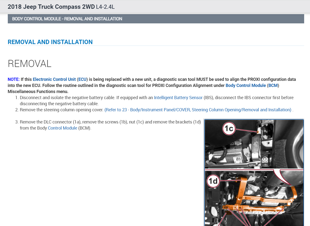

Several times when using command start the A/C comes on instead, even though it was on heat last time the vehicle was used.
Jan 28, 2023 at 4:06 PM
  • 54,494 POSTS

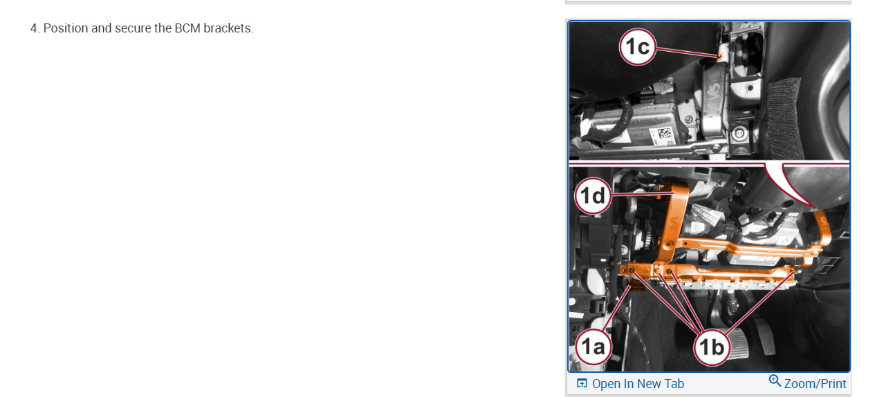

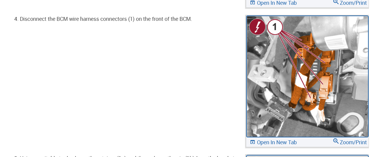

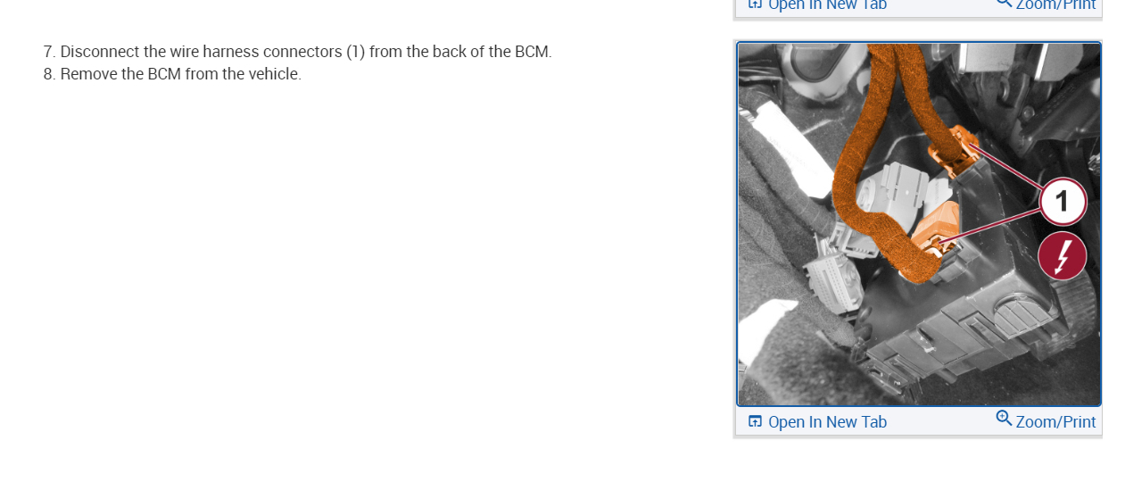

Yep, it sounds like the BCM is out causing this issue, to be sure we can do a CAN scan, you can get a CAN scanner (Controller Area Network) from Amazon.
https://youtu.be/u-4syLc-ifQ
and

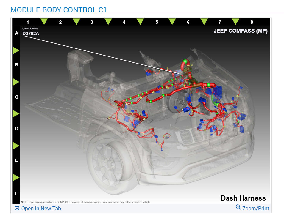

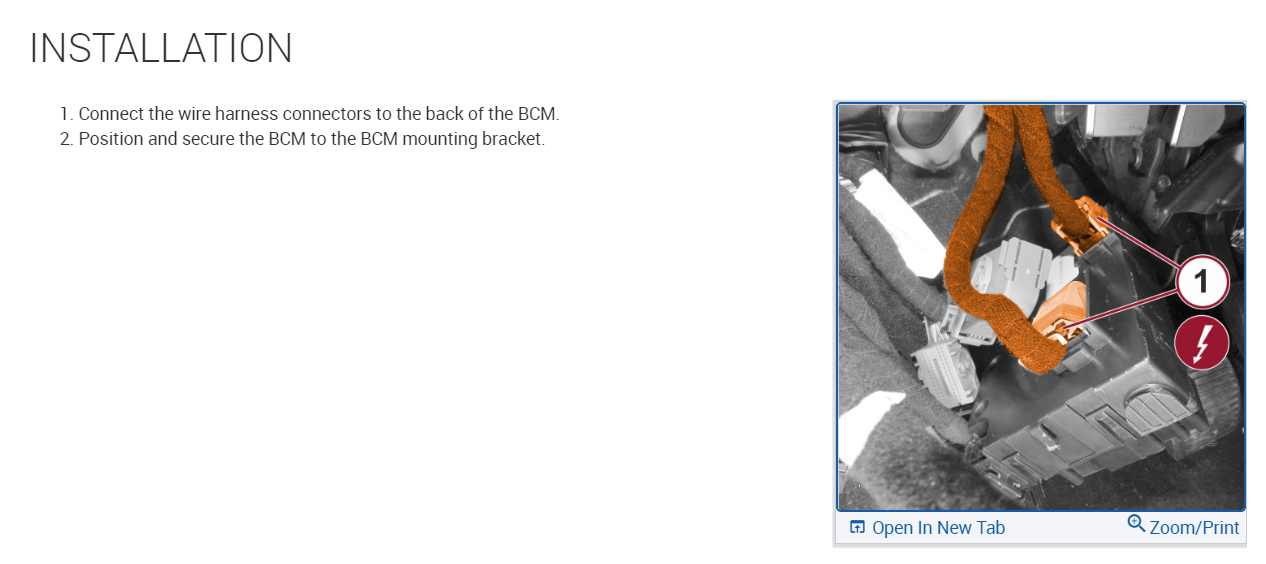

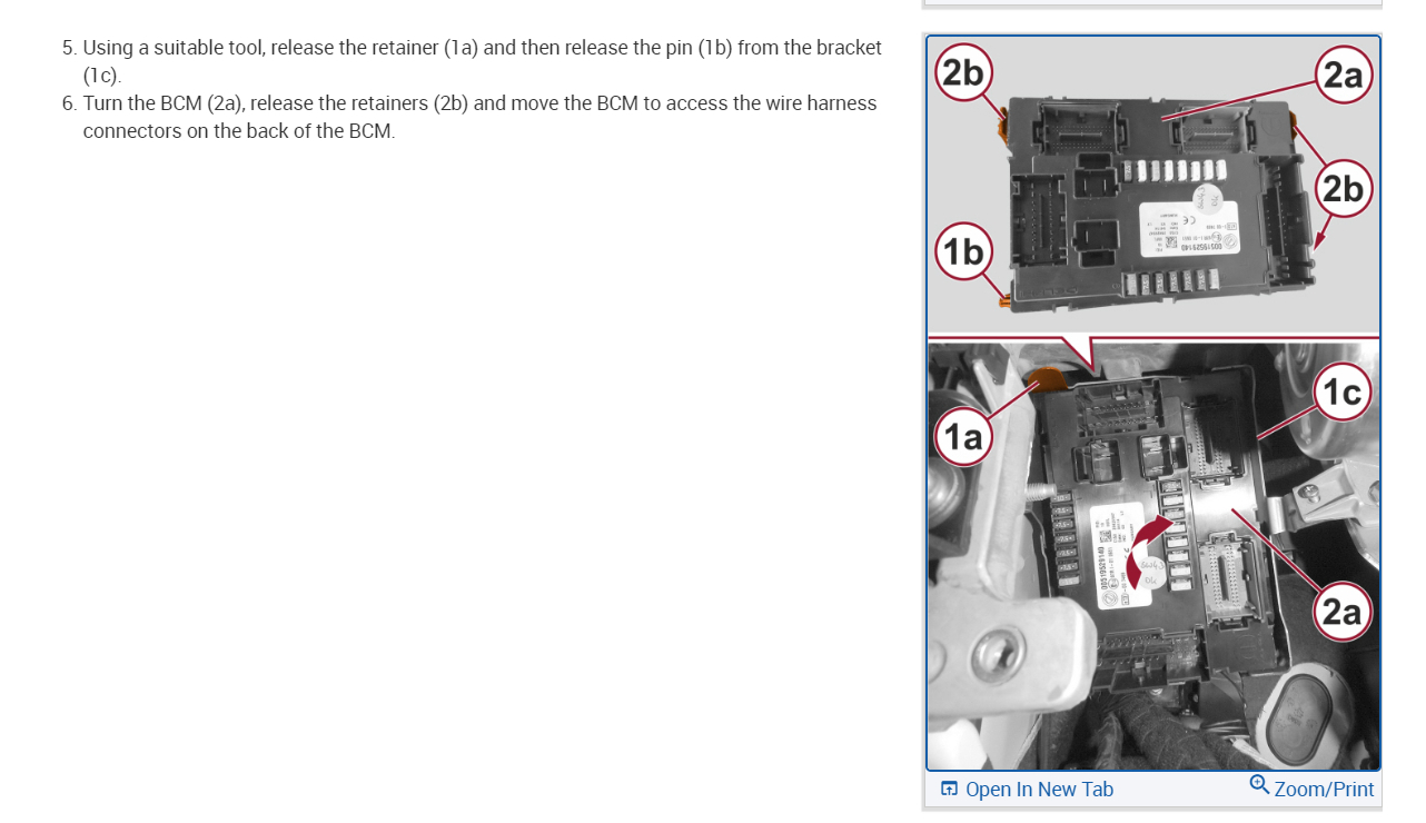

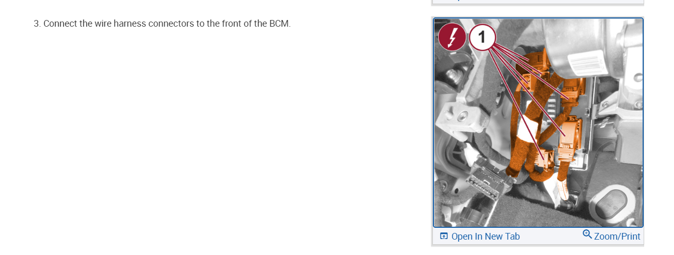

Here is the location of the BCM, you can get a preprogrammed unit by searching Google or Ebay. Check out the images (below). Let us know what happens and please upload pictures or videos of the problem.
