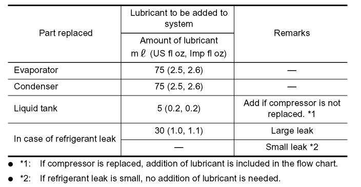

If compressor failure is from it seizing then make sure to flush out the whole system and replace the receiver drier. Also, the correct amount of oil needs to be added. The spec is 6.8 ounces for your system. Here is an article I think would be good to go over before replacing the compressor:
https://www.2carpros.com/articles/replace-air-conditioner-compressor
