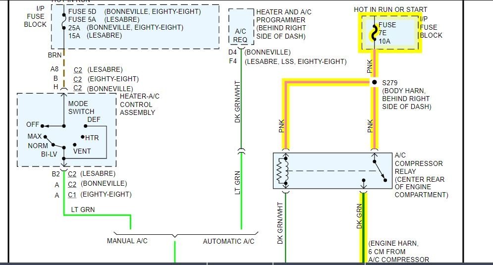

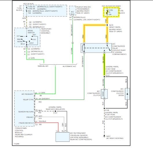

System has been recharged but still only blows hot air.
Monday, August 12th, 2019 AT 3:42 PM
MECHANIC
52,796 POSTS
Good evening,
Is the compressor engaged?
Can you give me the high and low side readings of the pressure?
This could be an electrical issue or it could be something with a blend door if the compressor is on.
