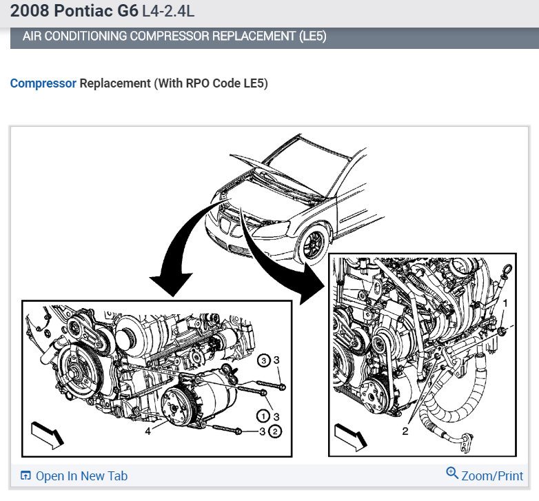

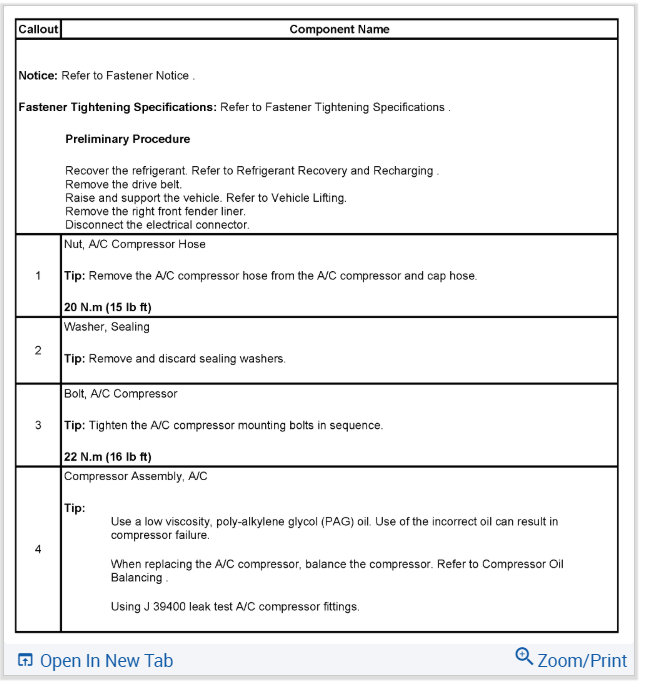

  • CAR REPAIR CONTRIBUTOR
  • 54,334 POSTS
If the system is full and the clutch is turning it means the compressor is going out and needs to be replaced. here is a guide to help walk you through the steps with diagrams below to show you on our car:
https://www.2carpros.com/articles/replace-air-conditioner-compressor
