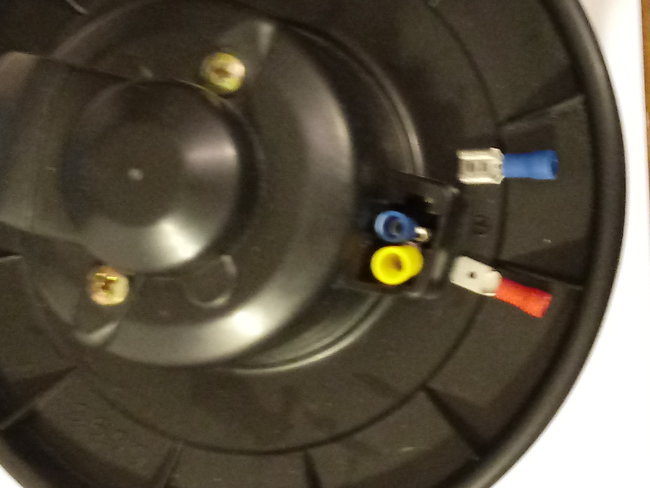

Good news on the blower. i tested the old blower and it work with my probe. I remember what you said about wiggling wires for the fuse box. i had a feeling i should of wiggled the wire to the blower and i did it, but put the old blower back, it worked!
Thank you Roy and 2CarPros. Thanks for telling me about wiggling technique. it is not the fuse. i have hot and cold air now! Thanks for your service! I will ask again for my next project. Thanks Roy.

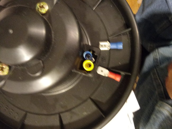

No luck with the de-grease on the pigtails to the blower. It did not show any signs. I was excited when I put back my old one and wiggled the wires and it came on like brand new. It felt good but now back to square one again.
Jan 14, 2019 at 5:02 PM
Is the connector at the fuse block or the blower motor connector?
Jan 14, 2019 at 7:50 PM
The connector is at the blower motor. I wiggled that the first time and it worked then after it didn't and today I greased it and no go. Nothing. I have two blowers and they both work, when I put power to them . I don't believe it is the blowers. Something with that line to the blower and plug. I keep thinking fuses again . I could recheck them . Still in limbo. I believe it is that line though? Trying to figure out how I could see more to that line? Thank you Roy
Jan 14, 2019 at 9:02 PM
Check the connector at the blower. It may be the connector itself.
Jan 14, 2019 at 9:06 PM
That is what I thought! Actually the plug itself looked a little smashed, not burnt. I was thinking of getting plugs and cutting the part up to the plug and using electrical tape ? I want to test that wire before I make that decision. If that wire is good, that to me would be the plug? What do you think? Also having difficulty buying those plugs. Which types. I might have to take a picture and bring it in to the store or go online. Thank you Roy

Okay, rule the story of buying correct plugs out! I found connectors that actually fit two of the blowers. If I test the wire and see if it has power , I will cut the plug off and put these two connectors which do work , because I tested them out of the car to the blowers. So now I have to just test that wire. Confused about how to go about testing the wire. Car on or off again! Which device to use? I have a power Probe for continuity. We are getting there. Thank you Roy again.

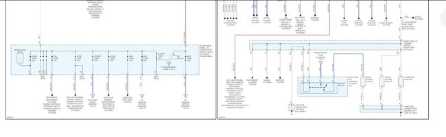

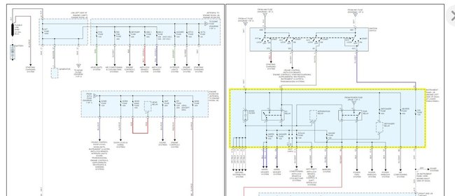

I had to rethink my plan for that. Since the blower works, I put power to it , I have a new resister put in, I am thinking , this might be a blower switch problem since the light to the AC is not on? All the others are on. Fuses check out fine but I could redo checking them. I keep thinking blower switch? Thanks Rob.
Jan 20, 2019 at 12:10 PM
If you wiggle the wiring at the motor, what makes you think it is the switch?
Jan 20, 2019 at 12:18 PM
I will wiggle it again just to make sure. Car on or car off again when wiggling. I see too many videos with with guys not disabling the terminal. I will disable the terminal and wiggle. If this doesn't work. I am trying to figure out the next step? Thanks Roy
Jan 20, 2019 at 12:30 PM
You will need a voltmeter to verify power. That is the next step.
