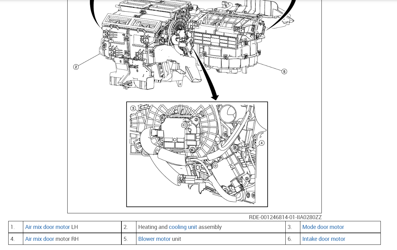

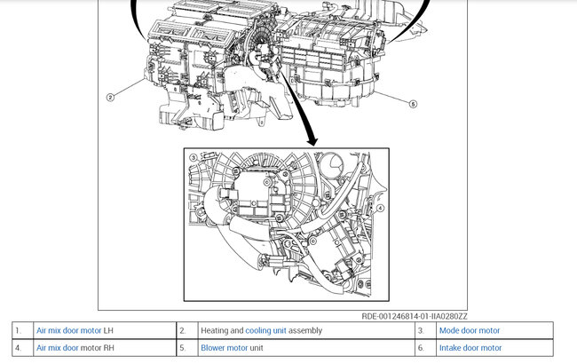

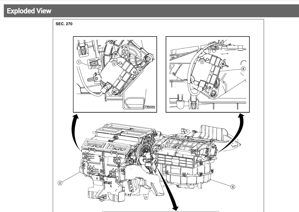

First, I would check the ground wires for the subwoofer because it sounds like one has been left off during the repair. Next, it sounds like the mode door actuator is broken, does the air change when you go from heater to air conditioner to defrost? If not, this will be the mode actuator failure. Here is the location of the actuators so you can see if they work when you make changes, you can feel them move if you put your hands on them. Check out the images (below). Let us know what happens and please upload pictures or videos of the problem.

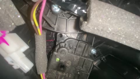

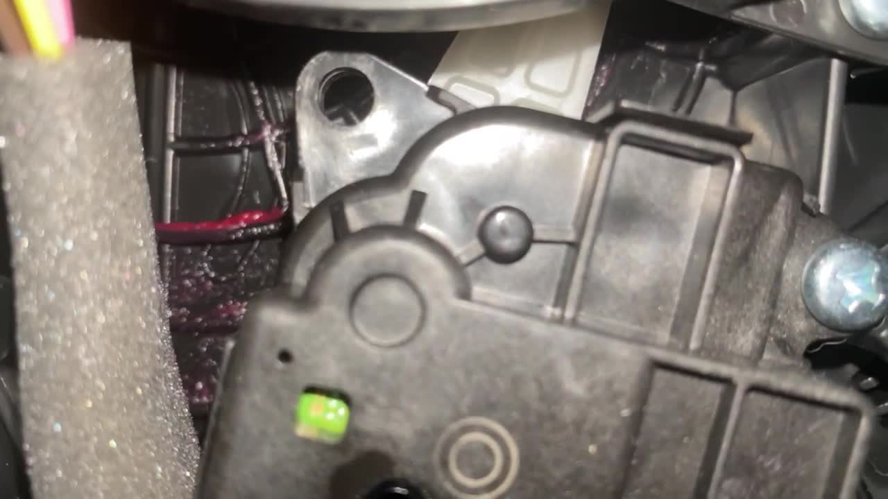

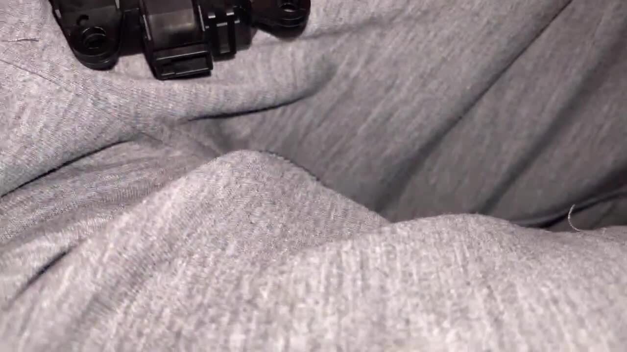

I can see all of them moving except the one in the back, nothing back there is moving when I press anything. I also hear a clicking sound coming from somewhere when I turn the air on and off.
Sunday, October 23rd, 2022 AT 10:50 AM
JAKE8771
  • 11 POSTS
Just kidding, there is some movement but not much. According to what you posted, the twitching back motor is the passenger side actuator.
Sunday, October 23rd, 2022 AT 11:13 AM

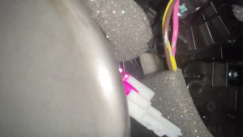

JAKE8771
  • 11 POSTS

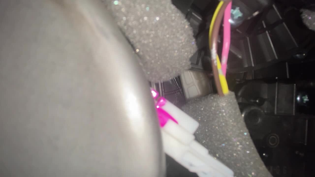

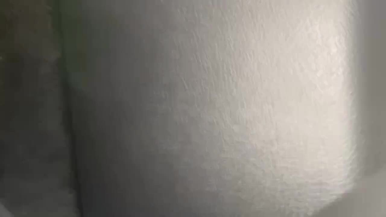

Another video of the back.
Sunday, October 23rd, 2022 AT 11:54 AM
KEN L
  • MASTER CERTIFIED MECHANIC
  • 55,097 POSTS
Nice work on the videos. Yep, I think you have found the problem, I think this is where the noise is coming from. More items will need to be removed before you can access the blend door actuator. Once you have removed it, please check the rotation of the pivot because sometimes objects can fall down into the ventilation system and block the door from moving.

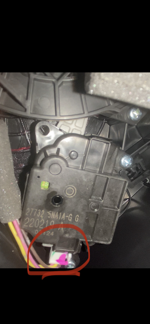

JAKE8771
  • 11 POSTS
So, today the ambient temperature has been above 70 degrees and the air is working totally fine, I have noticed this lately. I unplugged the actuator where I circled, and the air continued to work normally.
When you say check the pivot, where exactly do you mean? The place where the white “arms” are moving or where the actuator attaches to the white arms?

KEN L
  • 55,097 POSTS

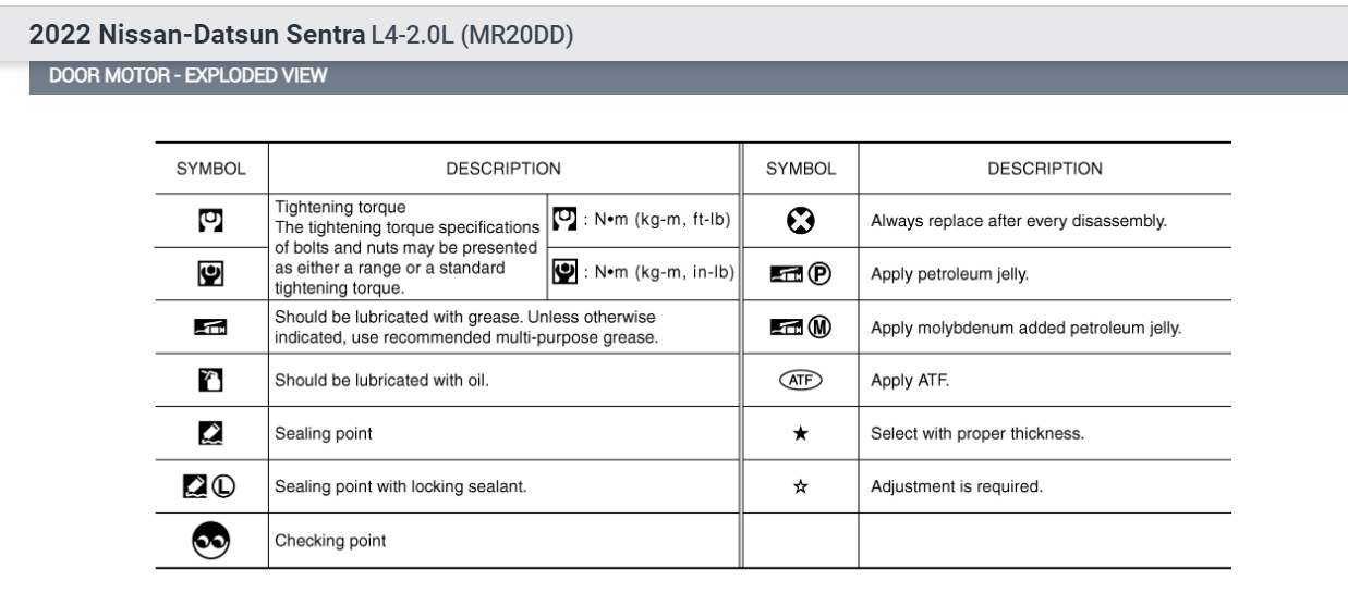

Thanks for the image. So, when the actuator is off of the plenum you can move the pivot for the blend door by hand, please make sure it moves from lock to lock.
Here is a guide that shows what I am talking about:
Please go over this guide and report back.

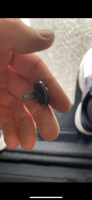

Thanks Ken. By the way, the sub was making that sound because the repair shop left a random screw sitting on the speaker. It works perfectly now.

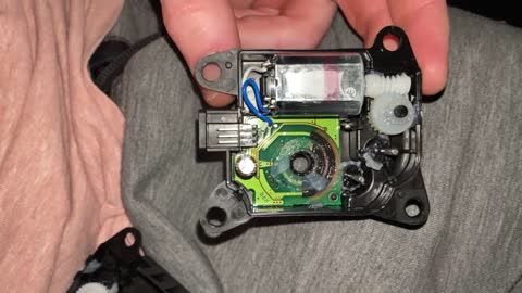

JAKE8771
  • 11 POSTS

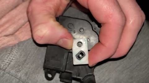

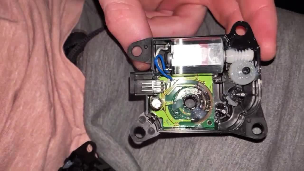

Well, I was hoping I could fix this myself but I’m running out of time. I removed the actuator and looked inside. Replacements are shockingly expensive. The car is under warranty, but I was just hoping I could skip not having my car for who knows how long when they fix it.

Even when I turn the pivot myself this does not make the temperature stable, there is still a difference between sides.

Thanks for the videos. The actuator arm won't move without the commands from the HVAC controller so you can move it by hand. It sounds like the HVAC plenum has broken internally which cause be a result from the crash, nice work finding the subwoofer noise, that's a good one. If you connect the actuator and work the control does the actuator move?
