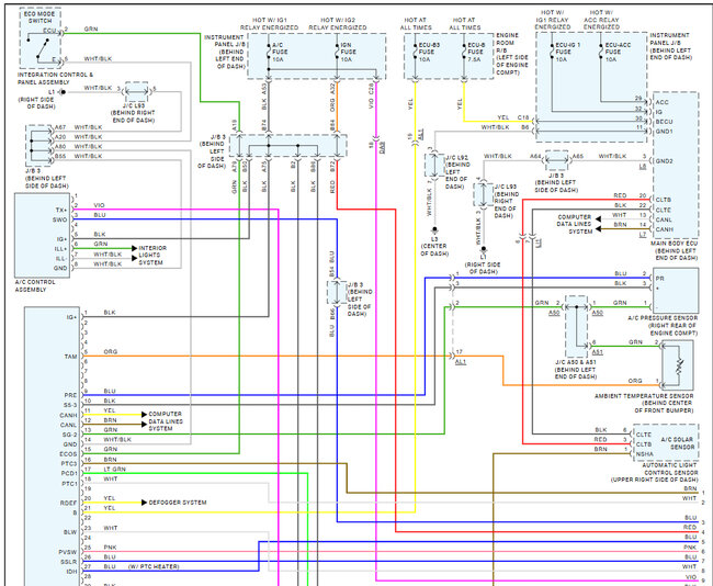

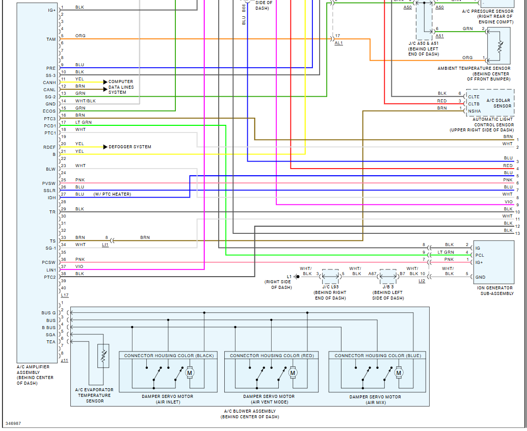

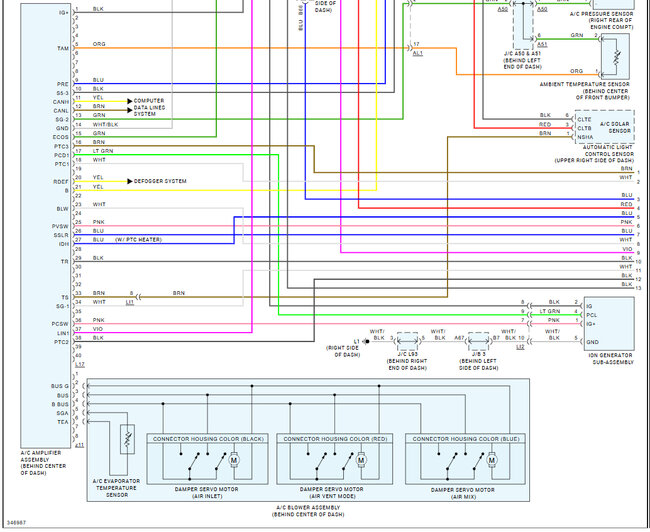

Need a proper diagram for air-condition system from air-condition amplifier to the servo motors pin out and wire color code needed for the HVAC system.

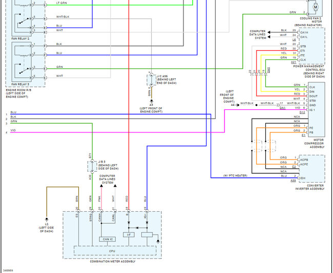

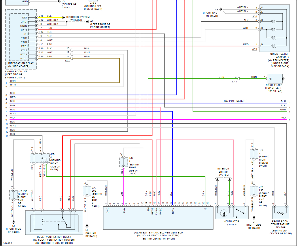

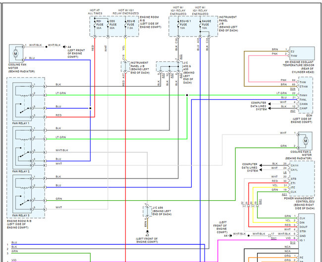

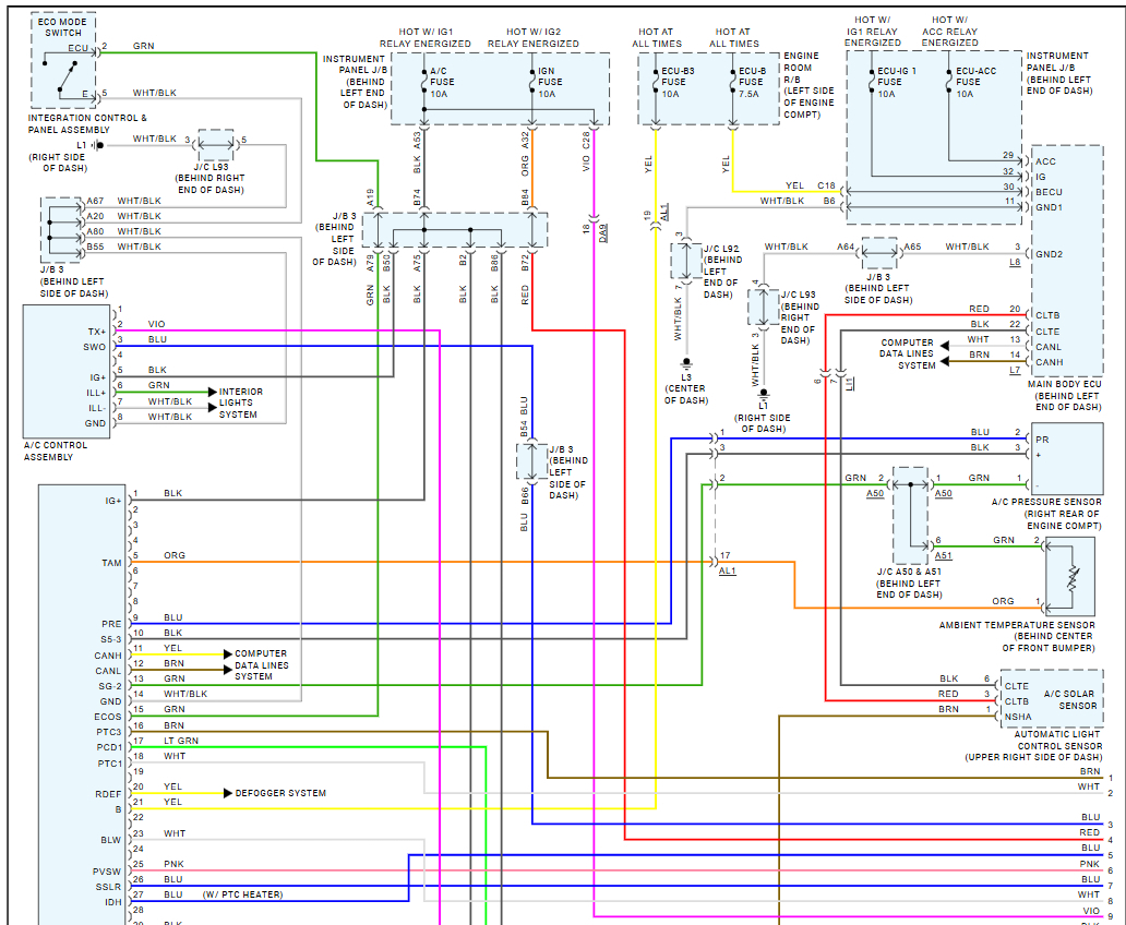

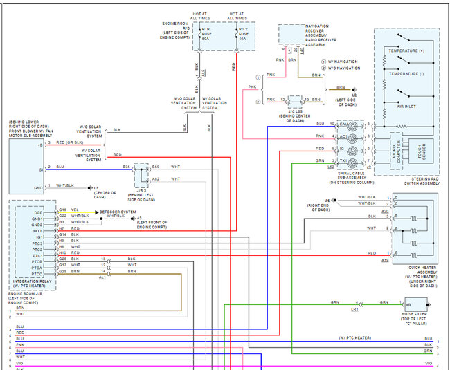

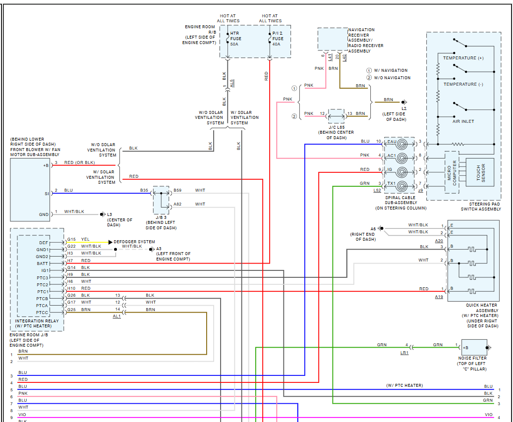

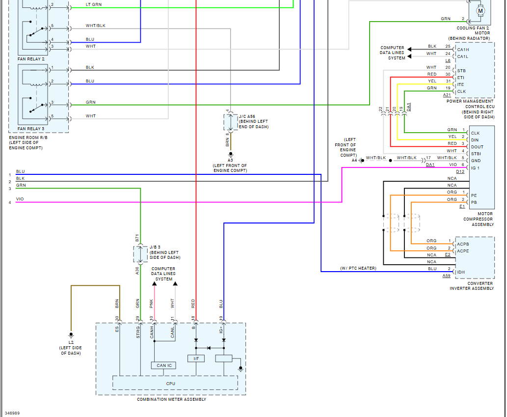

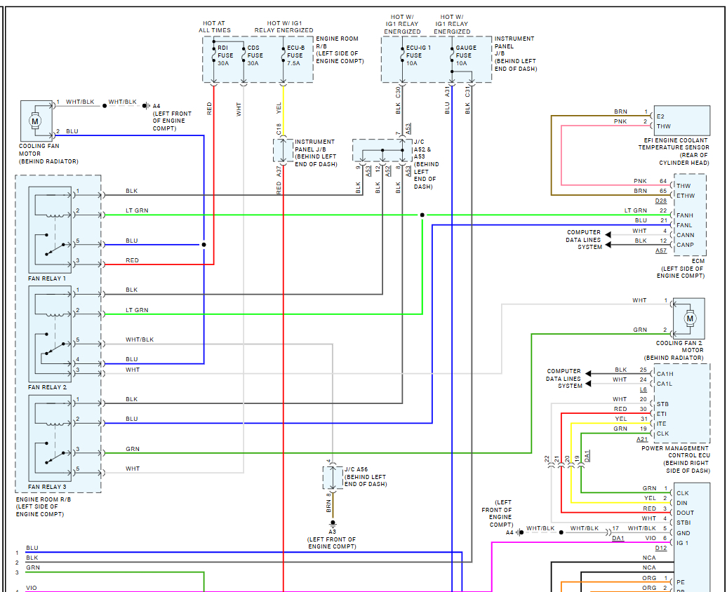

Sure, here are the wiring diagrams for the HVAC air conditioner/heater and a guide to help you will the testing.
Check out the images (below). Let us know if you need anything else.
