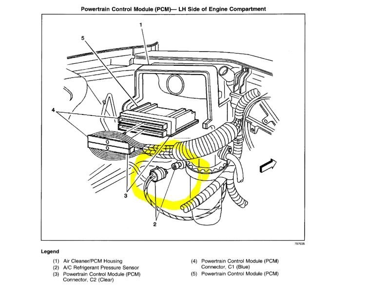

What if that has power? It's looking like I might have to take it in. What do you think?
Thursday, May 23rd, 2019 AT 4:10 PM
Does it have power? You need power to it for a signal to be sent to the PCM to energize the relay.
You may have a bad switch.
Thursday, May 23rd, 2019 AT 4:13 PM
YOUNGSNETWORK
  • 18 POSTS
But AC is working, it's just not real cold.
Thursday, May 23rd, 2019 AT 4:15 PM
Okay, the low side is still 50 while running?
Thursday, May 23rd, 2019 AT 4:16 PM
YOUNGSNETWORK
  • 18 POSTS
I don't know. Soon as I plug in the AcPro, it goes to red. Instructions say something is wrong if it goes to red. See Mechanic.
Thursday, May 23rd, 2019 AT 4:23 PM
That means either the compressor is not working or the expansion valve/orifice tube needs to be replaced.

You are not going to believe this. Too much Freon. Vacuumed system and put right portion in, now cold as Ice. Thanks again for all your help.
