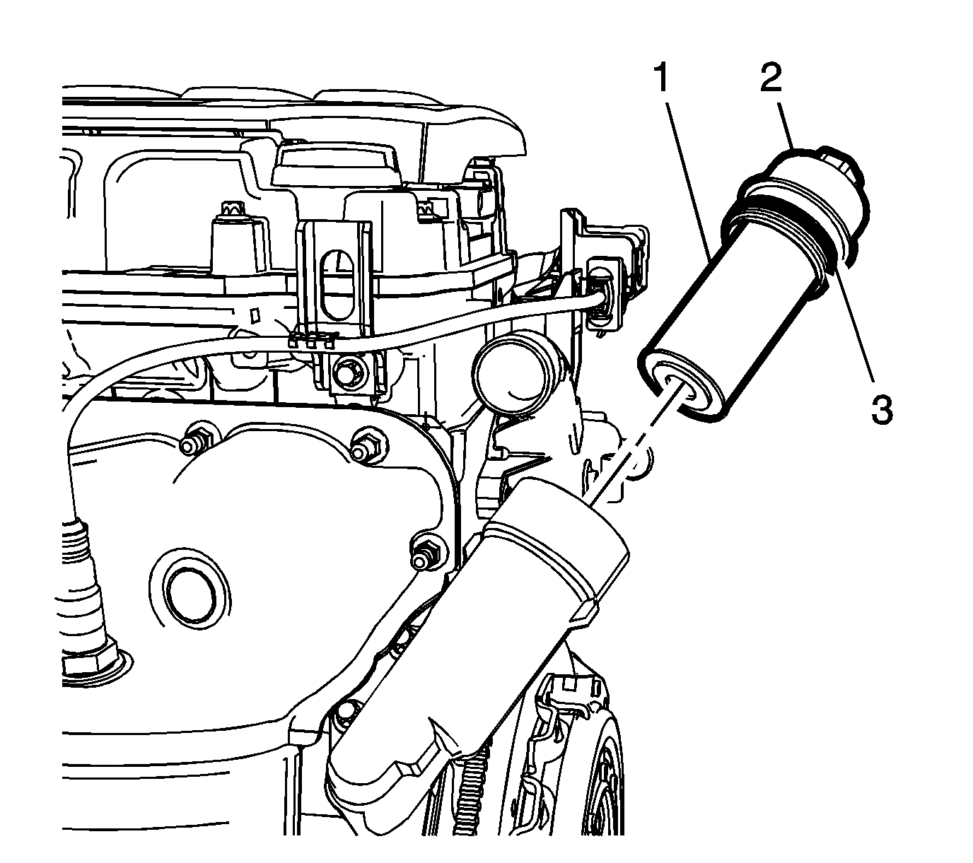

I had an oil change and maybe an hour later my engine light comes on. I take it to get a diagnosis and they said that the mass air flow sensor needed to be replaced. We replaced it and now my car engine light will not go off. Also, under the hood there is a burning smell and smoke with oil splatter under hood. The car drove fine in the thirty minutes that I drove it.
Jan 26, 2019 at 11:54 AM
  • CAR REPAIR CONTRIBUTOR
  • 110,193 POSTS
First, it is odd that it went bad after the service. Are you certain it wasn't unplugged? Also, as far as the check engine light, it will eventually go out after the vehicle has been run through several cycles, or you could clear the code using a scanner and it will turn off right away. Usually the shop does that when they do the repair.

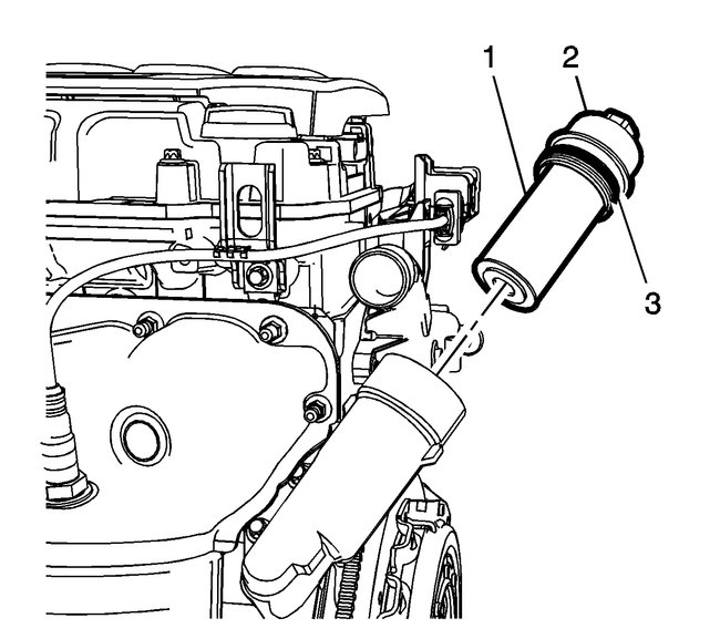

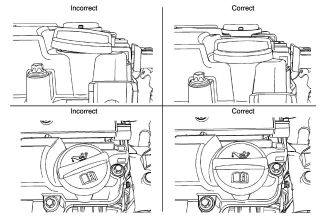

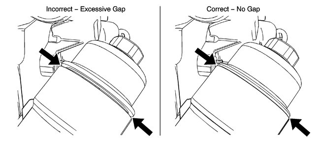

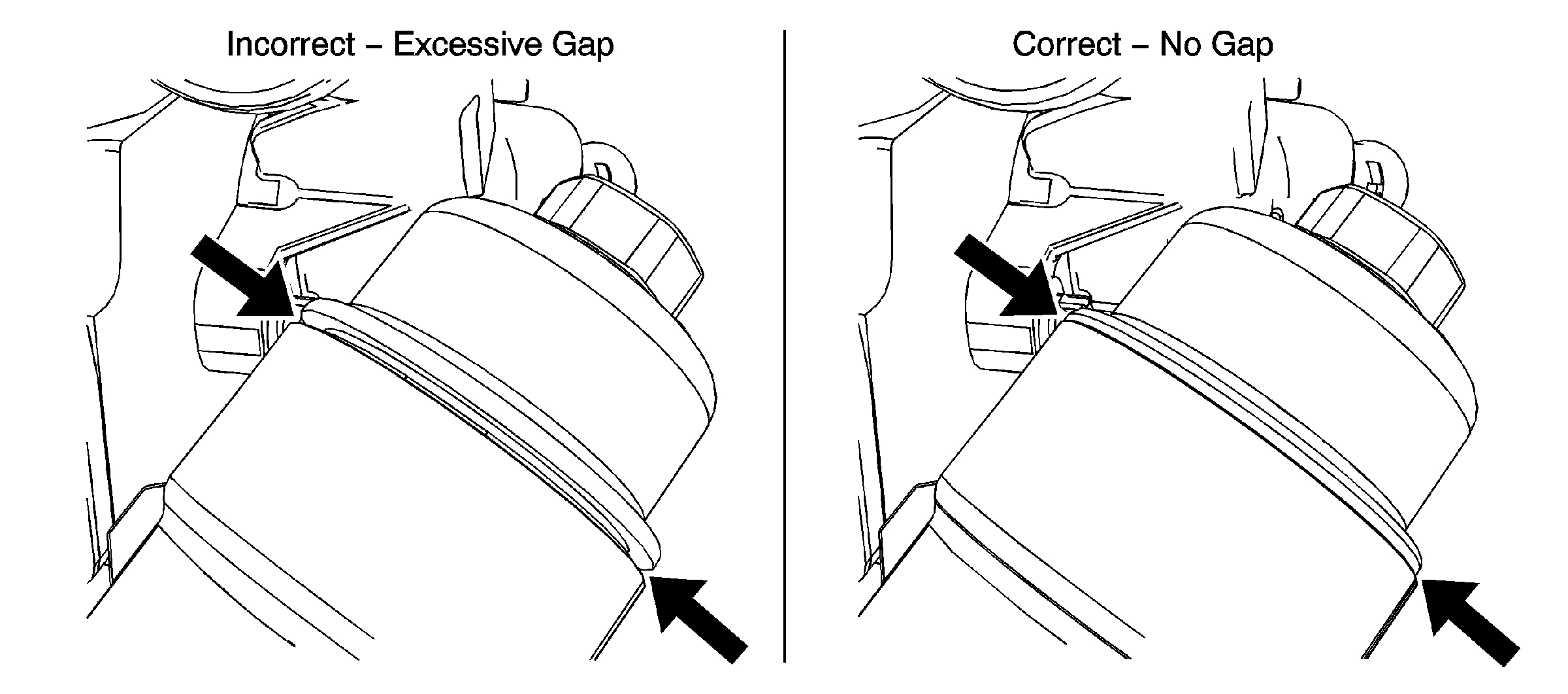

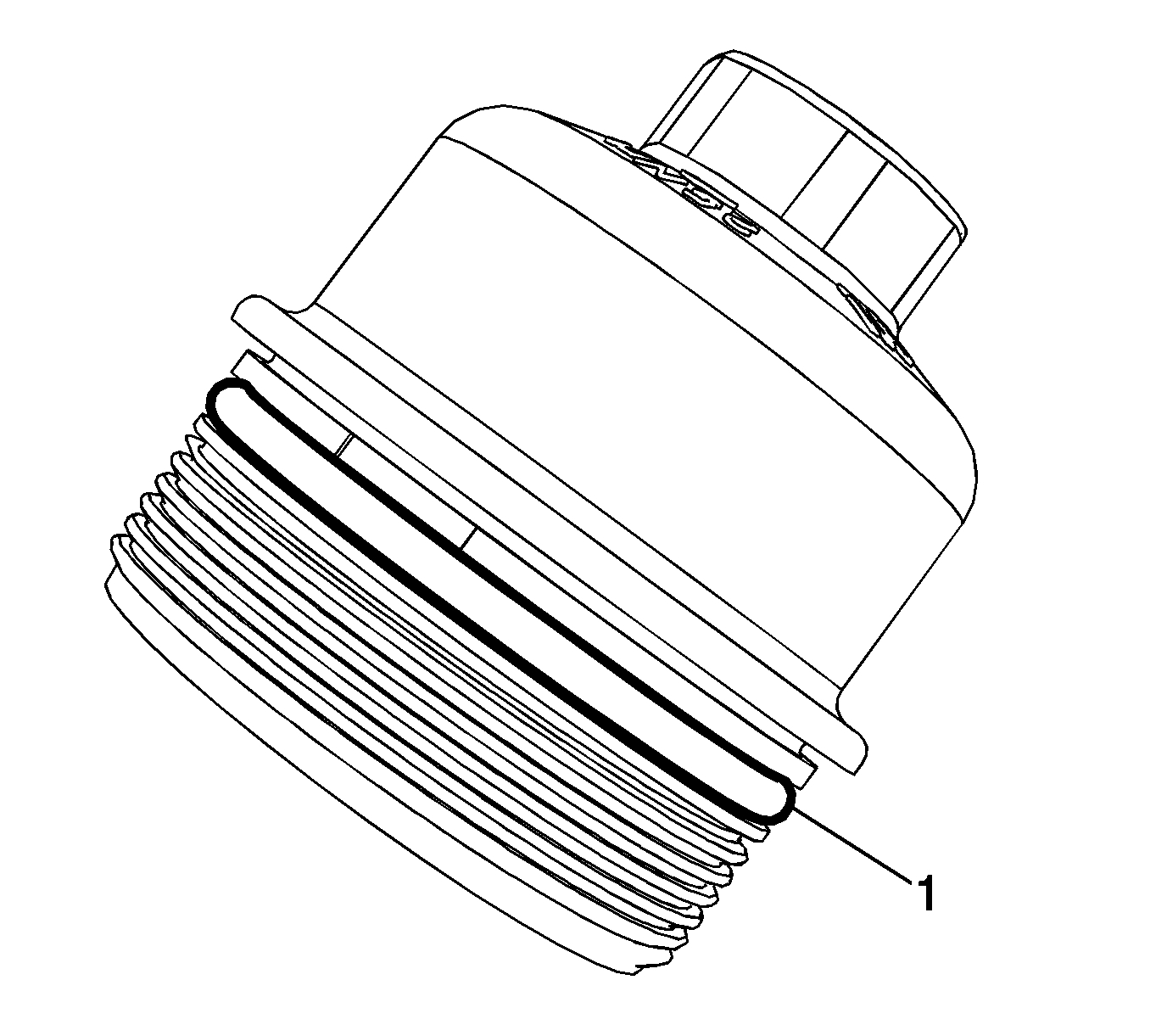

As far as the burning and oil, either they didn't put the oil fill cap on fully or at all or the oil filter housing is leaking. If you have oil splashing under the hood, that can be a fire hazard and needs to be addressed. I would recommend taking it back to have them fix their mistake.
If you would rather check things yourself, first confirm the oil filter housing isn't leaking and that the oil filter cap is properly installed.
Next, make sure they properly attached the oil fill cap.
I attached a few pictures to help you identify parts. They are
Picture 1 shows where the filter goes, the filter and the cap
Picture 2 shows the filter cap and the o-ring that must be installed and not damaged.
Picture 3 Shows how to determine if the filter cap is properly tightened. Note: The filter cap is plastic and if over tightened, it can crack.
Picture 4 Shows the oil fill cap and how it should be installed.
