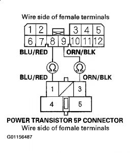

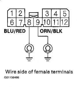

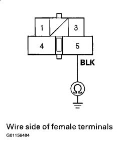

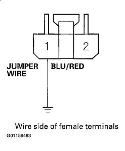

See diagram for 2P connector at motor is this how you ground and motor runs? if yes then check term #5 at 5P connector at power transistor and ground is there contiuity?
https://www.2carpros.com/forum/automotive_pictures/198357_Grafic_3_4.jpg
https://www.2carpros.com/forum/automotive_pictures/198357_Graphic_29.jpg

Yes. When I jump wire-side blue/red term from the 2p connector of the blower motor it runs at top speed. Are you saying there is an open(bad) connection between the 5p and the motor?

Was there contiuity? If no then check #5 wire to ground not motor. Did you run self diagnostic?

Yes, there is continuity. Between #2 term of relay (4P) and body ground I'm at step 26: "Check for continuity between the No. 2 terminal of the blower motor relay 4P socket and body ground. Is there continuity? YES - Repair open in the wire between the blower motor relay and the blower motor. NO - Check for an open in the wire between the blower motor relay and body ground. If the wire is OK, check for poor ground at G202." At the "YES" repair what "wire between the blower motor relay and the blower motor."? On the electrical diagrams I only see one wire between the 4P and the Blower Motor; the hot one. And that one is good because I have power at the motor?

Relay is good or you would not have power to motor.
Something is amiss in process of getting to step 26.
Go back to steps 13-16 retest
https://www.2carpros.com/forum/automotive_pictures/198357_Graphic_31.jpg
https://www.2carpros.com/forum/automotive_pictures/198357_Grafic_3_6.jpg

Check with ohm meter put one probe in #5 then check contiuity at 1=2=3=4 if there then it works. Also jumper between 4-5 key on motor run on high?
https://www.2carpros.com/forum/automotive_pictures/198357_Graphic_35.jpg
