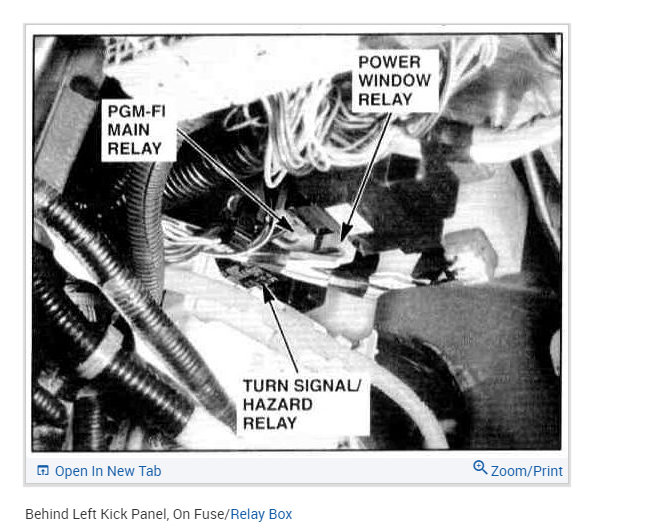

Where can I find the fuel injection relay and do u have a pics of it

There are 2 types of main relay and it is located under left side of instrument panel.

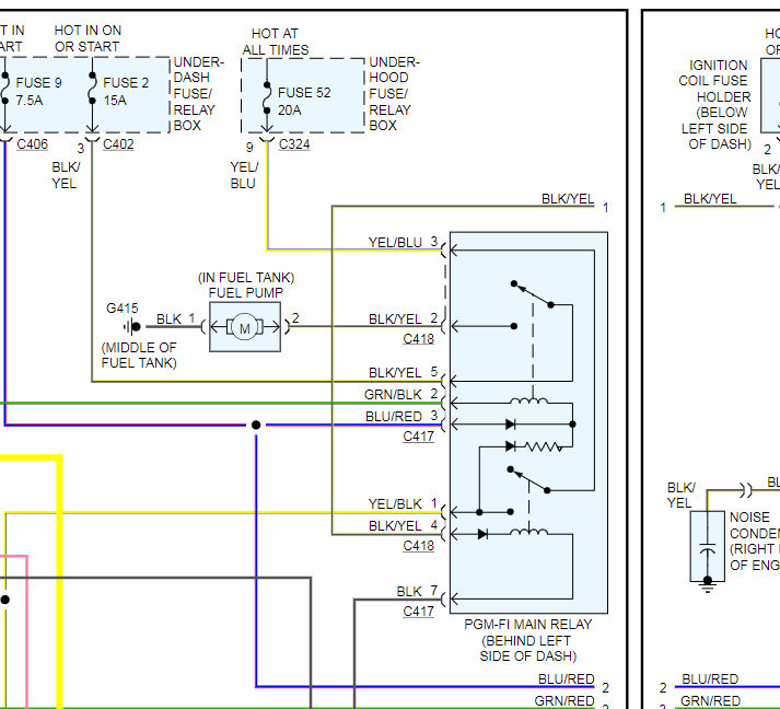

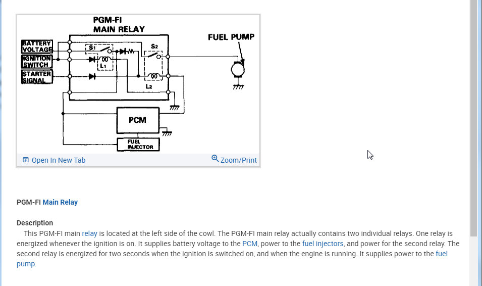

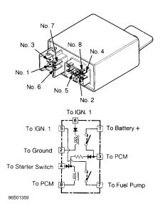

Hi, can you tell me where I can find the fuel pump relay?
Thursday, December 10th, 2020 AT 8:57 AM (Merged)
This is not a fuel pump relay by itself. It is the main relay. I attached the info for this. Let us know if you need more info. Check out the diagrams (Below). Please let us know what happens. Thanks
