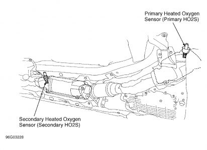

I need to find the locationof the 2 O2 sensors on this vehicle, also if any price is available

Primary Heated Oxygen Sensor (Primary HO2S)On exhaust manifold, prior to WU-TWC (first) converter. See Fig. 1 .
Secondary Heated Oxygen Sensor (Secondary HO2S)On exhaust system, prior to TWC (second) converter. See Fig. 1 .
