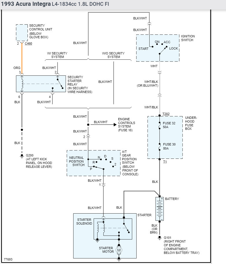

When a battery is weak, you will hear clicking noise for electrical components.
Just so cover the basics, have you tried to jump start the car?
https://www.2carpros.com/articles/how-to-jump-start-car-battery-using-jumper-cables
If you are able to jump start and the vehicle runs normal, then the battery is bad and needs replacing.
https://www.2carpros.com/articles/how-to-replace-a-car-battery

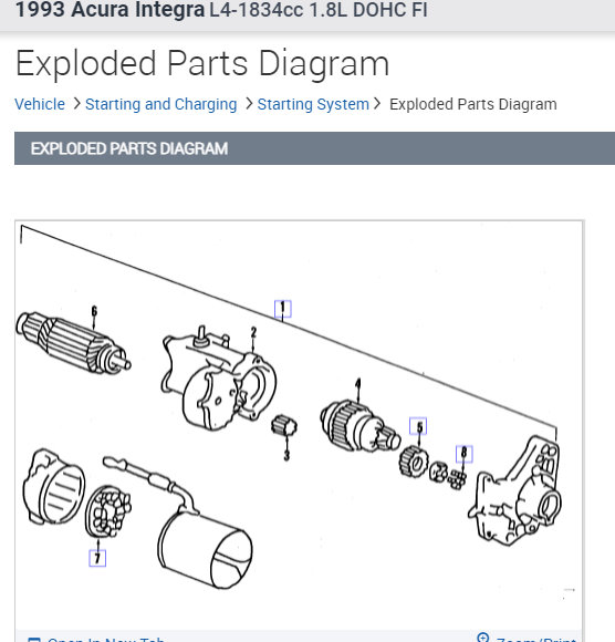

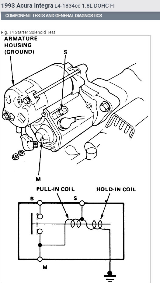

Another possibility is that the starter is faulty. The clicking noise is typically from the starter solenoid
https://www.2carpros.com/articles/how-a-starter-and-solenoid-works
