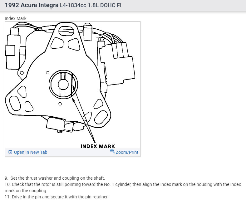

Engine turns over but it won't start. Grounded a plug wire while cranking. No spark.
Thursday, September 11th, 2008 AT 7:37 PM
SQM
  • 6,383 POSTS

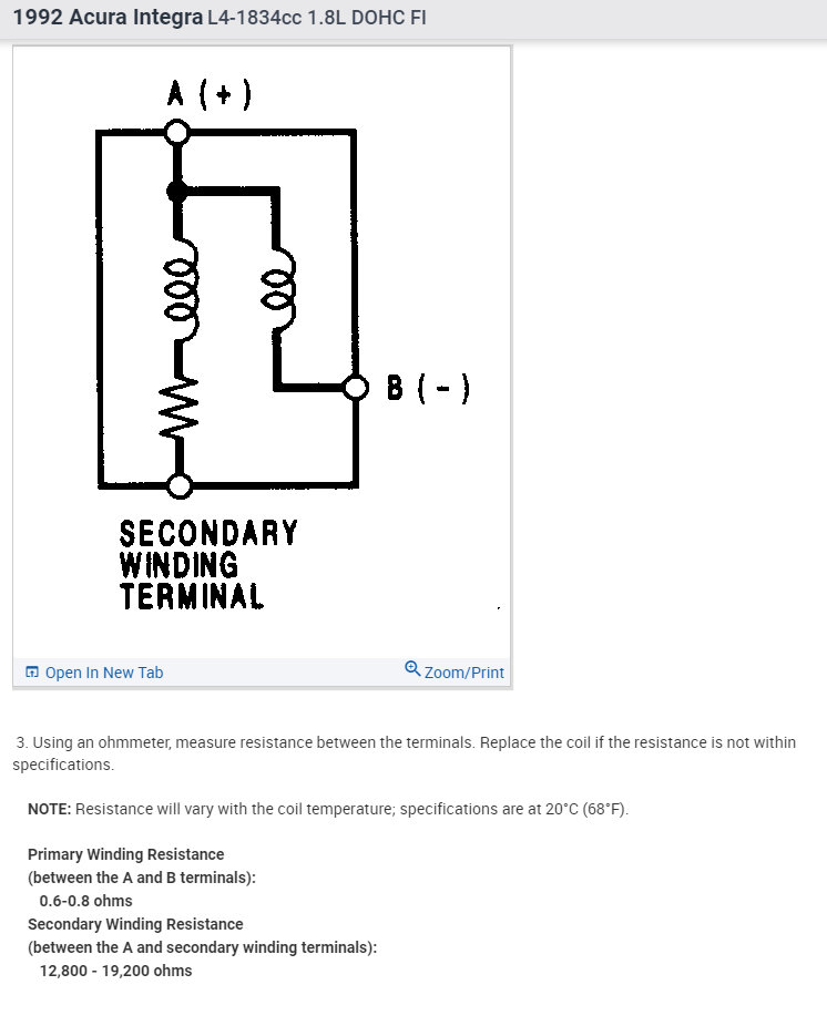

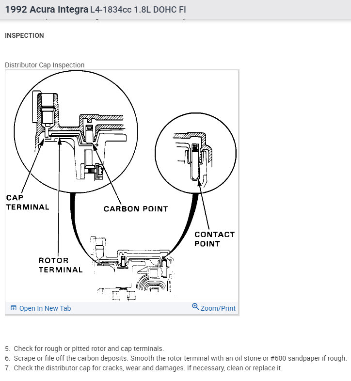

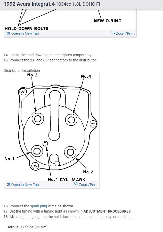

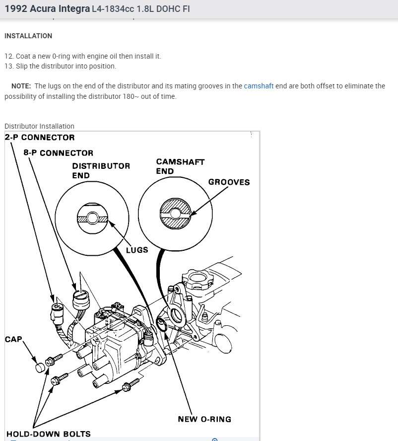

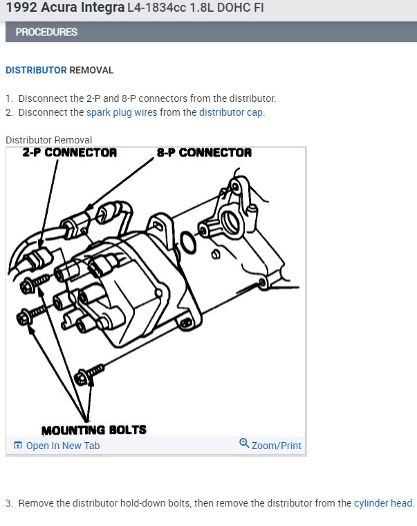

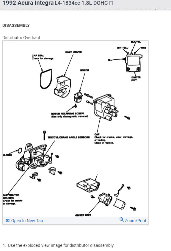

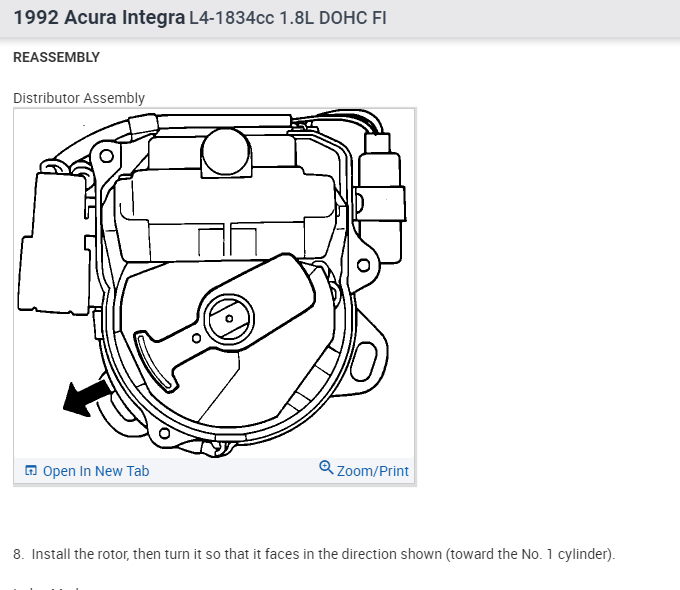

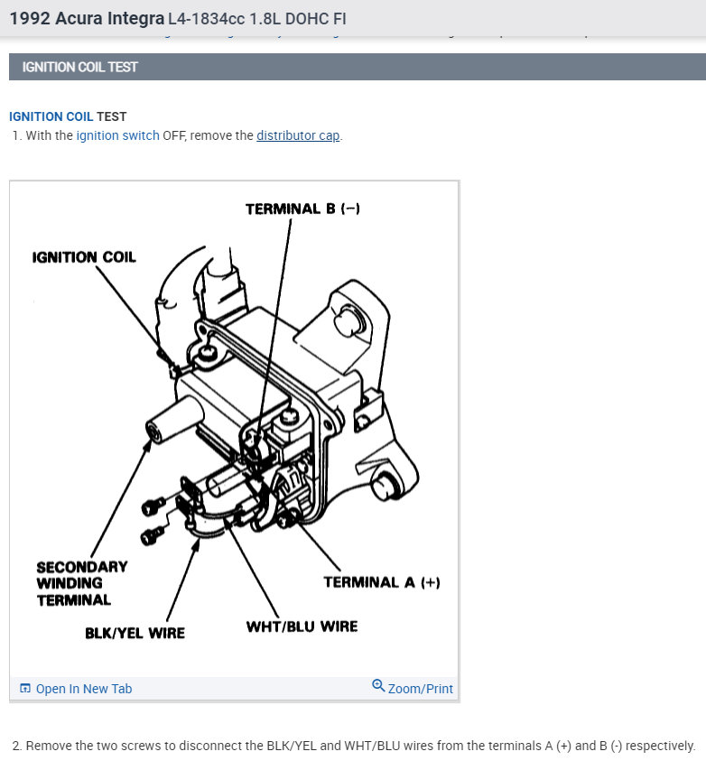

You can have no spark due to an issue with the distributor. It could be a bad cap and/or rotor. It can also be a faulty distributor. Another possibility is a bad intuition coil.
I have attached the ignition coil test procedure below. As well as the cap and rotor replacement procedure.
