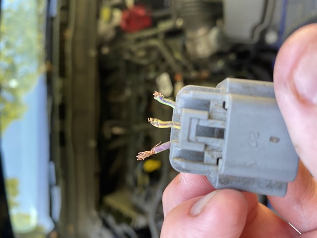

More likely a plug with yellow/violet, green/violet, and violet/green? It appeared to be plugged into the harness coming from the alternator.

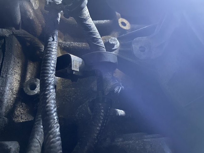

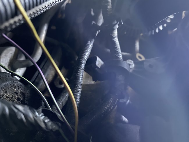

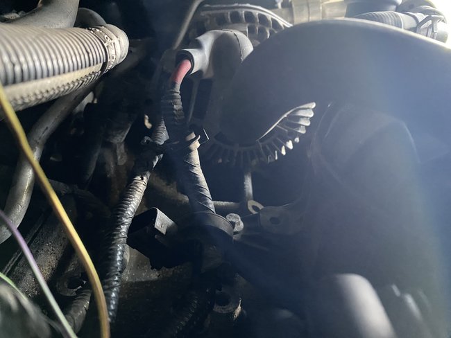

As you can imagine, it's quite difficult to get a picture of the place the plug goes. In the second picture, you can see the plug receptacle in the background and in the final picture, you can see the three wires that go to it in the foreground. As I stated in the previous post, it appears to go into the harness for the alternator? I'm adding a 4th picture of the plug going towards the alternator.

That got ripped out or cut out.
Can you find the 3 wires that go to that connector?
Friday, August 21st, 2020 AT 3:13 PM
J-SPAZ
  • 16 POSTS
Here's the picture of it going into the alternator. Yes, I can reach the three wires that go into the plug, although it's somewhat difficult. Is this likely the issue, or a completely different issue?
Friday, August 21st, 2020 AT 3:17 PM
  • 52,797 POSTS
Okay, you are going to have to remove the wrap from the harness and the tape around the harness to expose the wires and you can do the repair.
You will need to solder and shrink wrap the wires back together.
Since the color wire for the compressor is there, I would say yes to being the issue.
