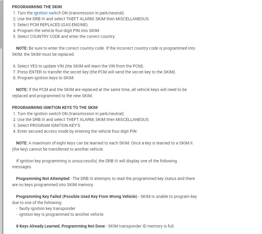

Replaced PCM and electric part of ignition, now no accessories when running but all of them with the key turned backwards.
Jul 2, 2018 at 10:39 PM
  • CAR REPAIR CONTRIBUTOR

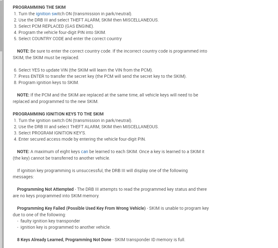

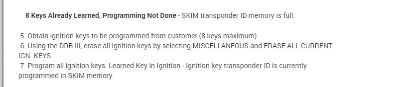

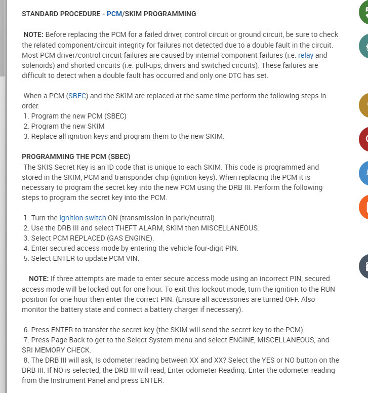

This sounds like an issue with the key itself. However, before anything else is replaced, I would suggest reviewing the info below on programming this PCM and make sure this was done.
https://www.2carpros.com/articles/how-to-re-program-a-key-remote-fob
Below you will find the specific info on this. If you replaced the PCM then you should have programmed new keys so run through this info and I would then replace the keys with two new keys and retest this.
Let us know what you find with this, and we can go from there. Thanks
