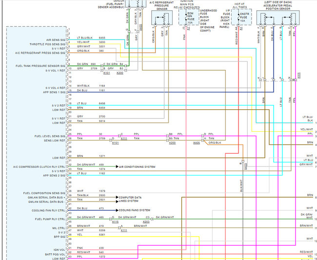

I got a code P01238 accelerator pedal position sensor. the car went into limp mode and I took it to the dealer and they could not fix it. because the pedal with sensor had been discontinued. So I replaced the pedal with a aftermarket pedal. I am still getting the same code P02138 and the car still enters limp mode.
I've tried 3 pedals and I also replaced the throttle body with sensor. I did a hard reset for the computer. It's still getting the code and going into limp mode.
How can I test the wires and pedal (It has 6 pins).

P2138 means the PCM sees the two accelerator pedal position signals not agreeing with each other. Some after market parts are junk right out of the box, I would try to get a OEM unit by searching ebay, also please inspect the electrical connector for damage. Here is a guide to help test the wiring and the diagrams for the wiring that goes to the PCM.
Check out the images (below). Let us know how it goes

I tested the resistance on the pedal itself, on sensor 1it showed 2.1 and on sensor two it showed 2.87.
Then I checked the 5V ref on both sensors and it was good. I then checked both ground wires and they were good. Then I checked sensor 1 signal wire and it read at pedal rest 1.0 and then all the way to the floor was 4.1
on the instructions it said at rest 1.0 and to the floor 2.1, so could this be a problem.

Yep, this means the pedal sensor is bad, I would get an OEM unit from ebay.

I have now tried 5 accelerator pedals with sensors, 3 were aftermarket and the other 2, I have bought used on ebay, they are OEM though. I have check the wires for power, ground which checked out ok. But all 5 pedals when checking the signal wires for sensor 1 show starting at 1.0 and goes to 4.1, Sensor 2 shows 0.50 to 2.0, each time it set code p2138. I have tested the signal wires for sensor 1 & 2 back to the x111 connector for continuity, that check out ok.
I haven't went all the way to the ECU yet. I wanted to see if you have any suggestions on what to do next? Thanks!

Nope, we did everything to test, the ECU is next. Let me know, that should fix it.

update: as stated before I was testing from the ECM to sensors and the wiring in general, the power dropped from a bad battery. setting off the U0100 code where it was not communicating with the ECM and causing a no crank, no start. So I tested the CAN BUS + AND - and discovered that the terminating resistor at the ECM was bad. So I'm going to buy another ECM. I'm hoping that will getting the car running again and Help address the original problem with the trouble code P2138 with the APPS and the car going into Limp mode.

Good find on the bad ECM, it might fix the P2138 code and the limp mode issue, please let me know what happens.

I replaced the ECM and that fixed everything! Thank you for all your help!
