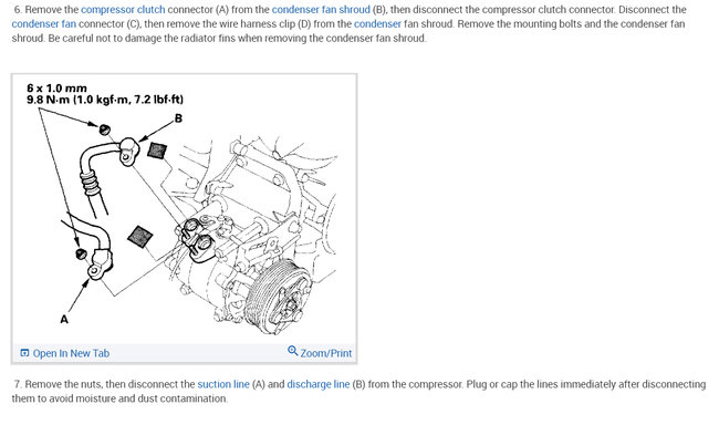

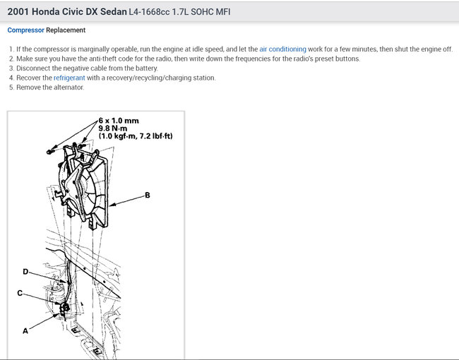

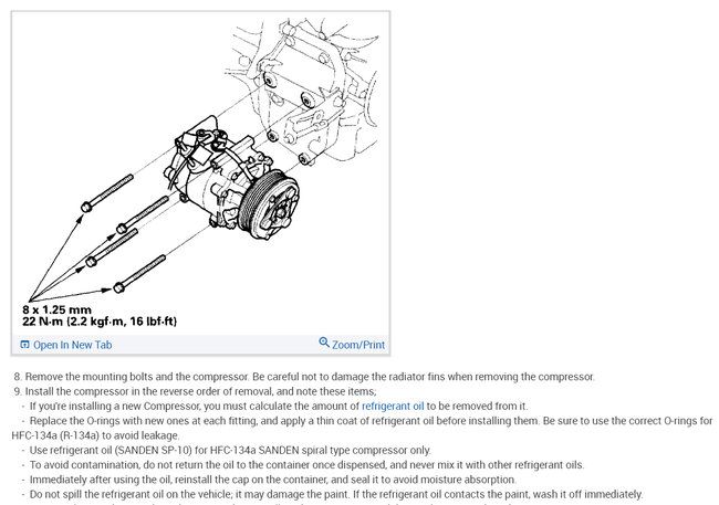

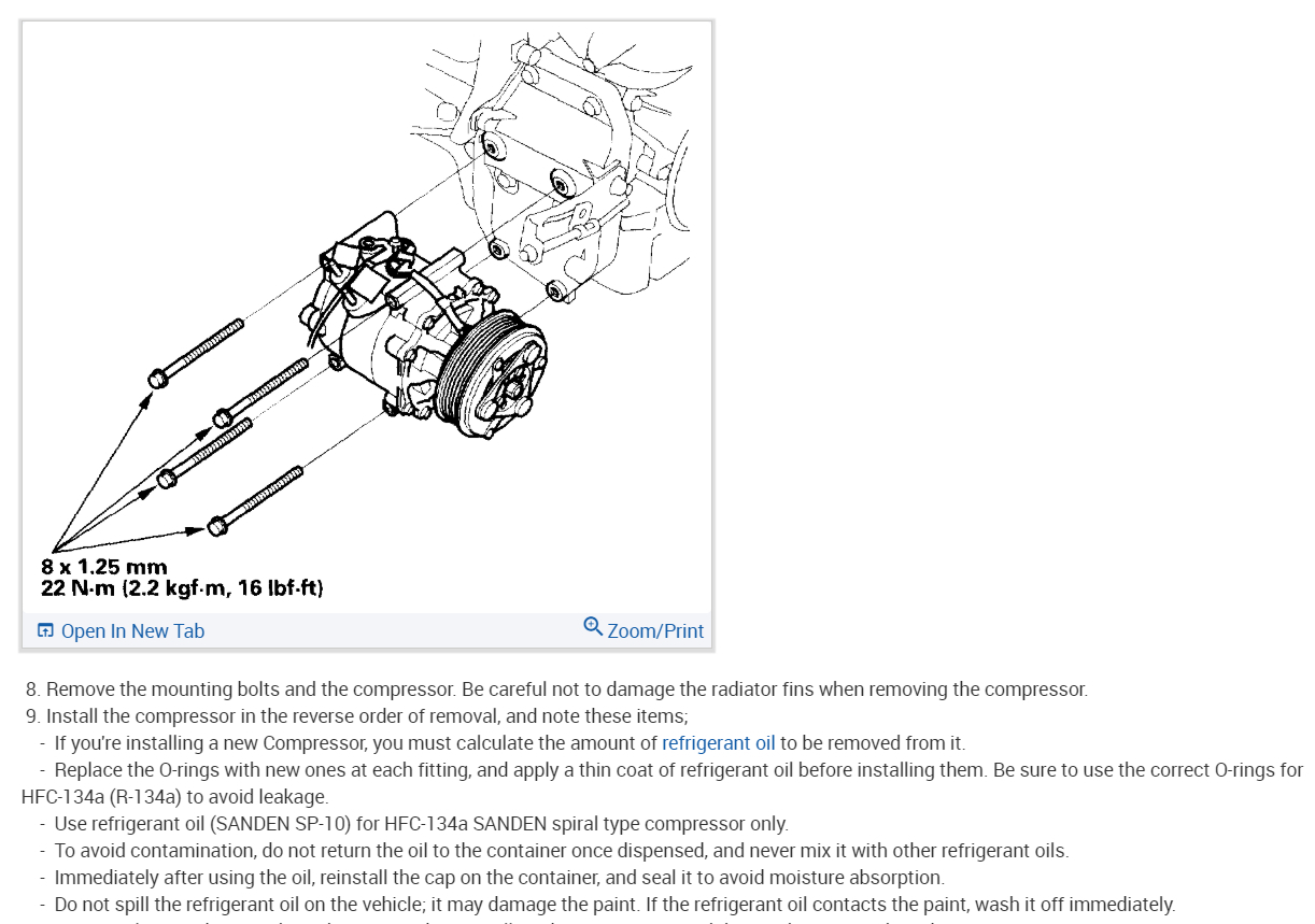

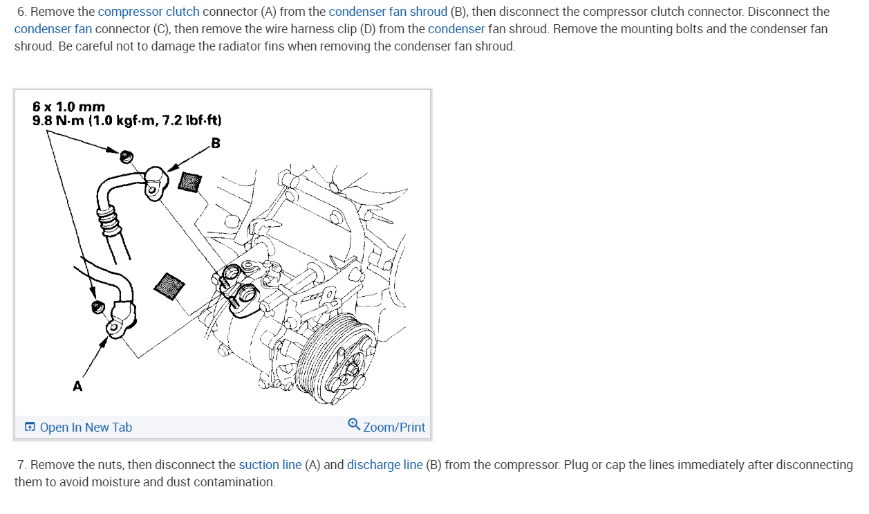

Here is a guide to help walk you through the repair and diagrams below to show you how on your car:
https://www.2carpros.com/articles/replace-air-conditioner-compressor
