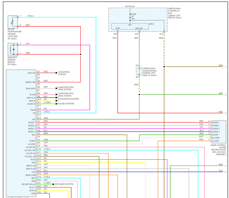

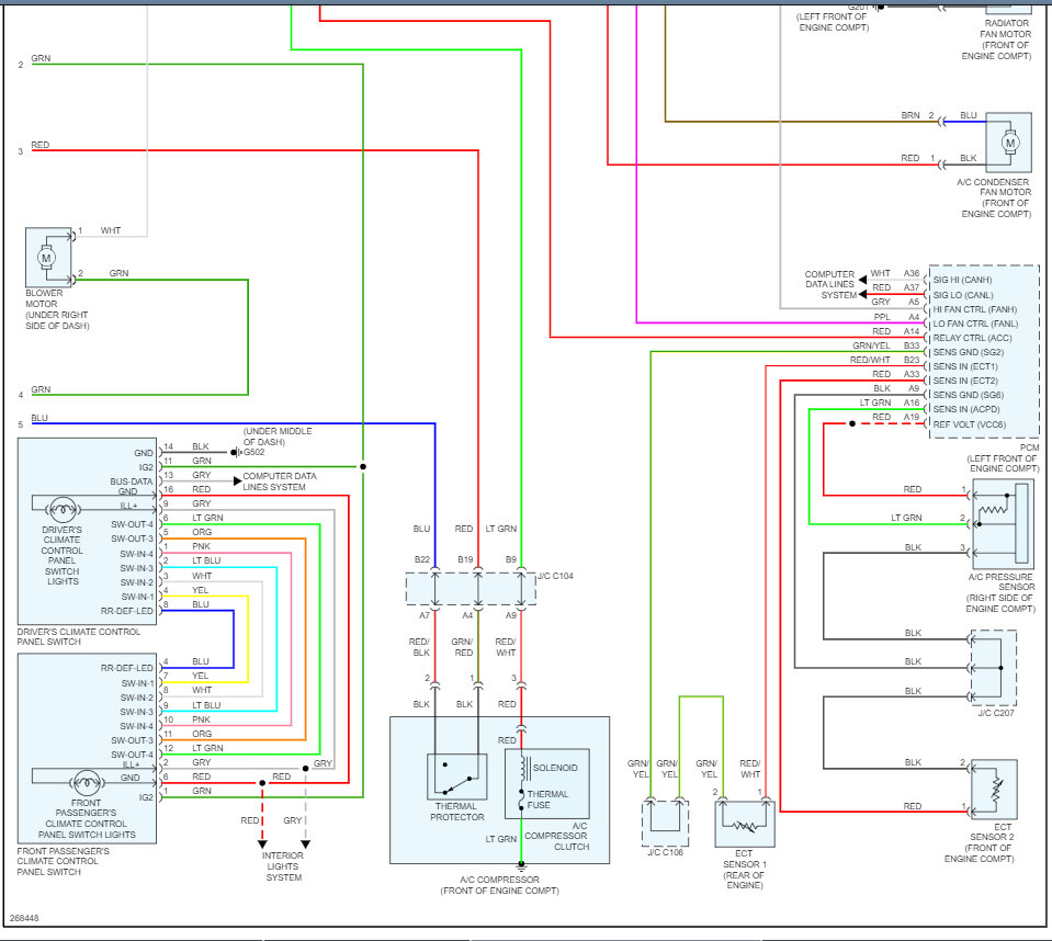

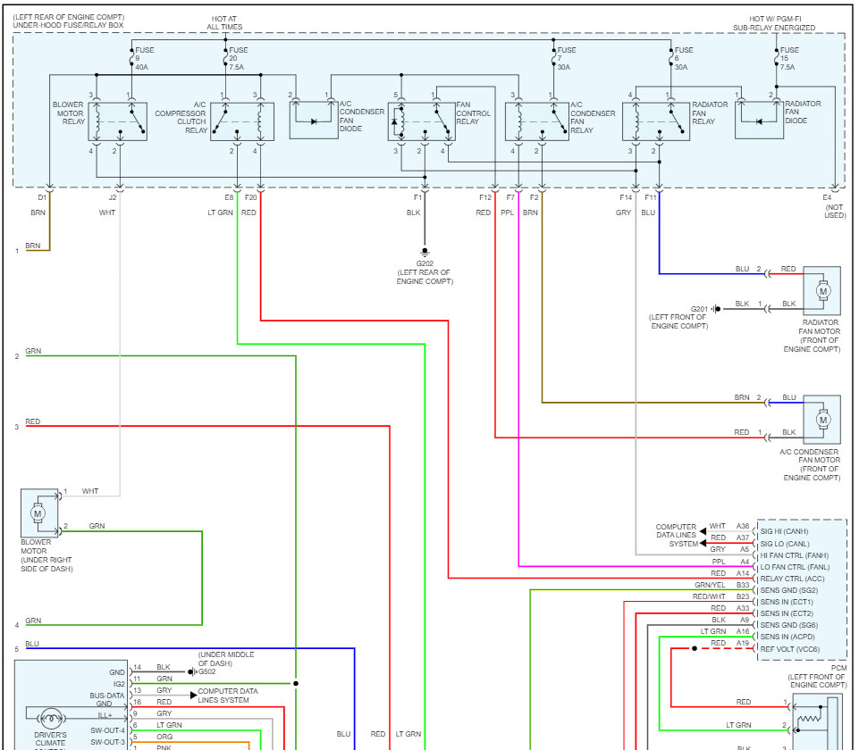

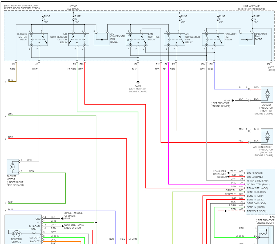

So, A/C wasn't working, there was less than 10PSI in it, I jumped the relay to get 30PSI in it. Now when I install the relay, I still have no A/C clutch engagement but when I jump the relay A/C works fine and blows cold. When I tested with power probe, I have power on the 2 prongs but no ground from ECM->ACrelay which if I power probe the relay with ground while the relay is just half installed, everything works fine. Also, when the condenser fan turned on, it rapidly clicks after running for a minute or 2 and then fans stop and after another 30seconds the pressure relief valve blows out some of the refrigerant. I believe the condenser fan control is the problem. What controls the condenser fan relay?

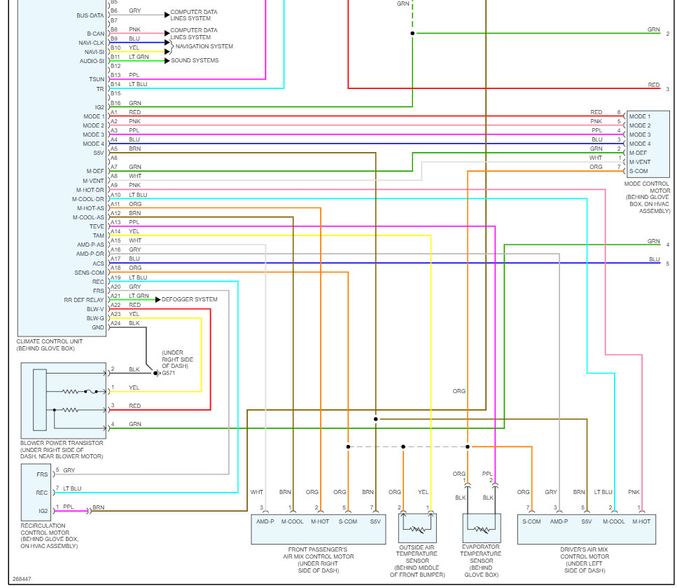

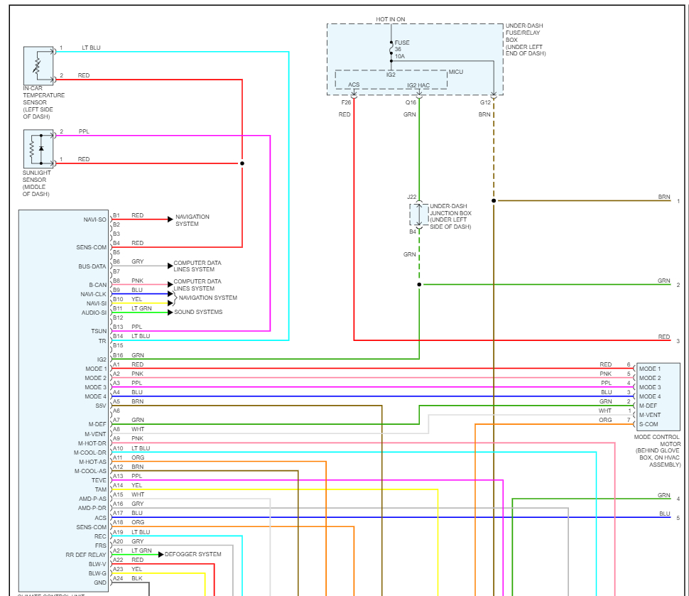

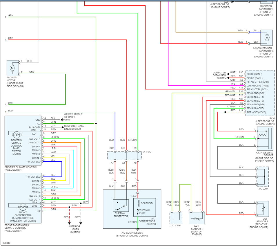

Yep, that sounds correct. I wonder what the high side reading is when it cuts out? Please check out this guide can well, and I have included the A/C system wiring diagrams so you can see how the system works.
https://youtu.be/4EqdrBVb0sY
Check out the images (below). Please let us know how it goes.

Display shows me pressing the A/C button on and off, but the ECU is not reporting to the Snap-On versus that the A/C switch is commanded on or off. Can anyone look at the diagram and tell what could be faulty here? I revised all the pressures and vacuumed the system and refilled it with the right charge, new relays and new pressure switch.

I would check the IG2 power inputs (green wire) on both the drivers and passengers side control switches.
Please check with the key on. Let me know what you find.

Also, I'd like to note that. This car's climate control inputs go through a canbus module. It's getting power since dash says A/C is on. And the compressor even turns on and shuts off.

You might have a bad MICU, we should perform a CAN scan, you can get a CAN scanner (Controller Area Network) which will work on most cars from Amazon.
