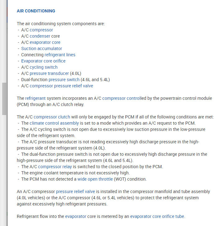

Also, the flash A/C light normally means there is a circuit issue or some other reason the PCM is preventing the compressor from coming on. This could be an electrical issue, sensor issue, or even a pressure issue.
I am attaching the info below from the manual that explains the system in more detail.
Basically, if you are bypassing everything and the A/C doesn't come on, the only way it is the A/C control module is if that is not sending the signal that you pressed the button.

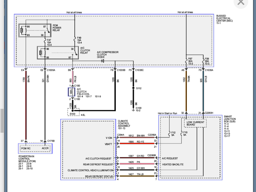

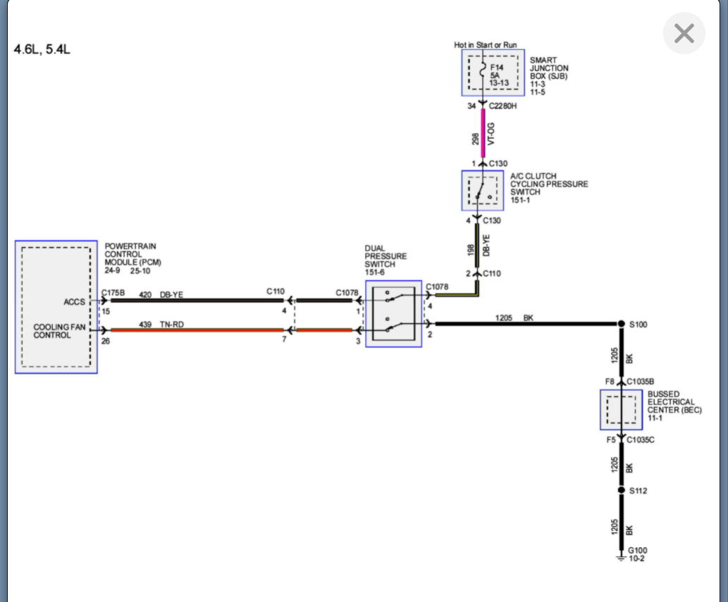

Also, these OEM diagrams explain this a little better than the AllData ones. You can see the pin 2 and 3 of the dual pressure switch are for the cooling fan which is why that came on. However, the PCM still is not commanding the clutch on.
While it would be good to confirm this with monitoring the PCM, it appears the way this works is when you press the A/C button, it sends voltage to the smart junction block as you can see on the first diagram. The SJB then sends voltage on the A/C clutch cycling pressure switch. If the pressure switch is closed then it sends the voltage to the dual pressure switch on pin 1 and 4. The PCM is the ground for this circuit so if it gets 12 volts due to both switches being closed, then it commands the clutch relay to close.
We have already confirmed you have voltage at the PCM on this circuit, but the relay is not coming on. Jumping 1 and 4 of the dual pressure switch just eliminates the switch as being the issue.
Unless I am missing something, I think you need a PCM.
If you connect the entire system and start the engine and turn the A/C on, you should have 12 volts at pin 15 of the PCM C175B. If you do, then the PCM should be grounding the relay, but it is not.

Maybe I didn't understand something. What two wires did you jump to cause the compressor to kick on? The two on the dual pressure switch? If you did then that switch is the issue.
As for rigging this up to take the PCM out of it, that is going to be tough because you can simply remove the relay and jump power directly to the compressor circuit, but the compressor will run all the time and you need to cycle the compressor, or you will over pressurize the system and blow a line off or freeze it up.
So, you could wire a switch and run it into the cap but you would need to cycle the compressor manually, but it needs to cycle based on pressures. This is why you have this pressure cycling switch on the PCM control circuit. Basically, that is a pressure switch and when the pressure reaches a certain point, it opens the circuit and the PCM cuts the compressor off.
So, this really isn't a good option but hopefully you jumped 1 and 4 of the dual switches and the compressor kicked on. If so, replace that switch and it should be fixed.

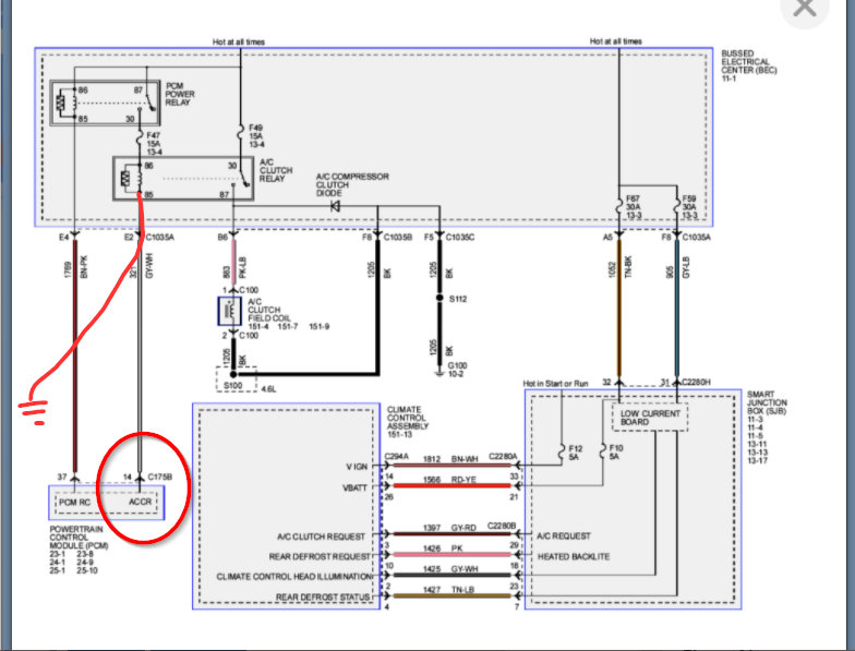

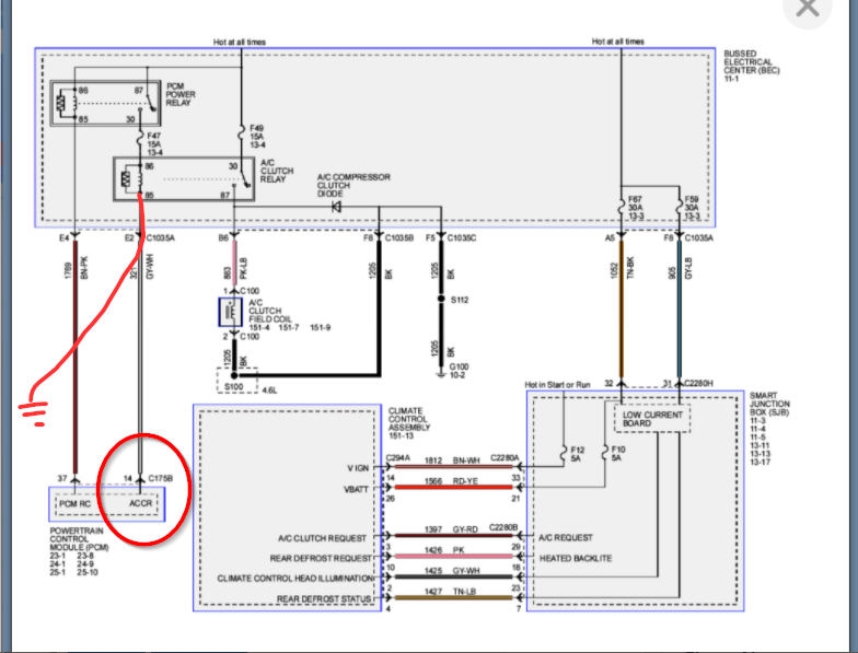

What I connect a ground the relay ground pin and since the dual switch works it should cut off the compressor if the pressure is too high or too low.
Sunday, October 10th, 2021 AT 3:03 PM
Take a look at the diagram below. If you put a ground on this circuit so that the compressor comes on, you are eliminating the PCM all together. Those sensors are on the other side of the PCM, so they are called inputs to the PCM, and this clutch relay is called an output.
The PCM takes these inputs and determines if the clutch relay should be grounded or not.
So, the PCM is what is turning the relay on and off and whatever you do, you are going to have to take the place of this. That means you need to have the input information (pressures in this case) and instead of the PCM deciding if the relay needs to be grounded or not, you would have to do that by adding and removing the ground so that the compressor doesn't continuously run.
