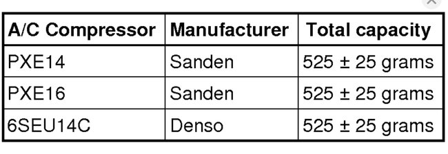

What type of Freon does it take and how much do I need? Any how to instructions?
Tuesday, February 5th, 2019 AT 7:31 AM
3 Replies
SEVAG P
MECHANIC
406 POSTS
Hello thanks for using 2CarPros.
The type of the Freon used Refrigerant R134a.
For capacity check the table attached.
Check our guide how to recover and charge the system:
thank you.
Image (Click to make bigger)
Tuesday, February 5th, 2019 AT 12:24 PM
CORY2427
MEMBER
293 POSTS
Do you have to vacuum AC? Never did before on my Toyota.
Tuesday, February 5th, 2019 AT 6:48 PM
SEVAG P
MECHANIC
406 POSTS
Yes, you must vacuum first to remove air pockets that can effect AC performance.
