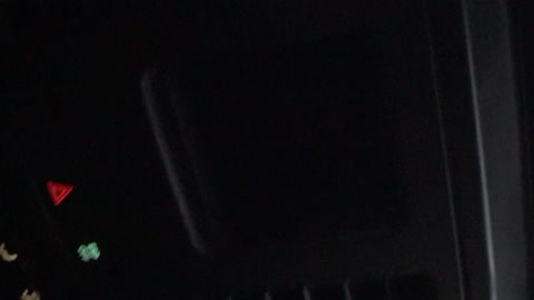

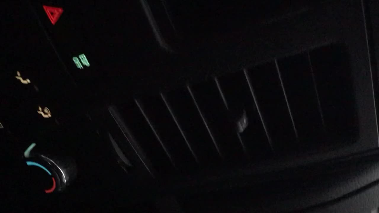

I believe I have an A/C leak. In the video below you will hear a “hissing” noise when I shut van off. It’s been doing this for a few months now. Don’t know if it’s just low on charge or if there could be a potential leak. Let me know your thoughts.

That sounds like the remaining air being pushed out by the blower motor. How long do you hear this hissing after you shut the engine off?
The blower motor is on a bearing and it will spin for quite a while when the power is removed. Try turning the blower fan off and waiting about 2 minutes and then shut the engine off. If it does not do it then this is what it was.
If it still does it and you have a leak then the A/C is most likely not currently working. Does it blow cold still or do you have any other A/C issues?
Let me know this info and we can go from there. Thanks

Can't tell from the video, but a hissing sound proves there is still refrigerant in the system. When the charge leaks out over time, the pressures in the system will drop to the point the low-pressure cutoff switch disables the system, then you won't get any cooled air. That is done because once the system is low on charge, it could be possible for a running compressor to pump the low side into a vacuum. That could allow air to be sucked in along with the harmful humidity in it. Moisture in the system combines with refrigerant to form an acid that will corrode the metal parts.
Before the system gets that low, you can tell when the charge is partially leaked out by observing the compressor cycles on and off rapidly, or at least more often than normal.
The hissing you may hear is refrigerant rushing through the expansion valve or orifice, and into the evaporator in the dash. When the system has the correct amount of refrigerant in it, half of it in the evaporator will be liquid and half will be vapor. It is at the point where it changes from a liquid to a vapor that it gets really cold. The flow of refrigerant is regulated so that point never gets below about 40 degrees. All AC systems provide their comfort by condensing out the humidity in the air. That condensed water collects on the evaporator, then runs down into a drain pan, then onto the ground. If the evaporator were allowed to get colder than 32 degrees, the condensed water would freeze into a block of ice that would block air flow.
When enough refrigerant has leaked out, the point at which it turns from a liquid to a vapor will be in the hose under the hood. That is where the cooling will take place, but there will be very little of it. You may see frost form on the hose at that point. You'll get uncooled air in the car.
When the system is running, that hissing you're hearing is occurring all the time, but it may be somewhat muffled. With a partially-leaked-out charge, the flow rate increases to maintain the desired rate of cooling, and that flow will continue for a few seconds after the engine is stopped. That is likely the hissing you're hearing. If the noise was from a leak, you might see frost coming out of the vents when that leak first occurred, but all the refrigerant would be leaked out within a couple of minutes, then no more sound and no more cooling would occur.
