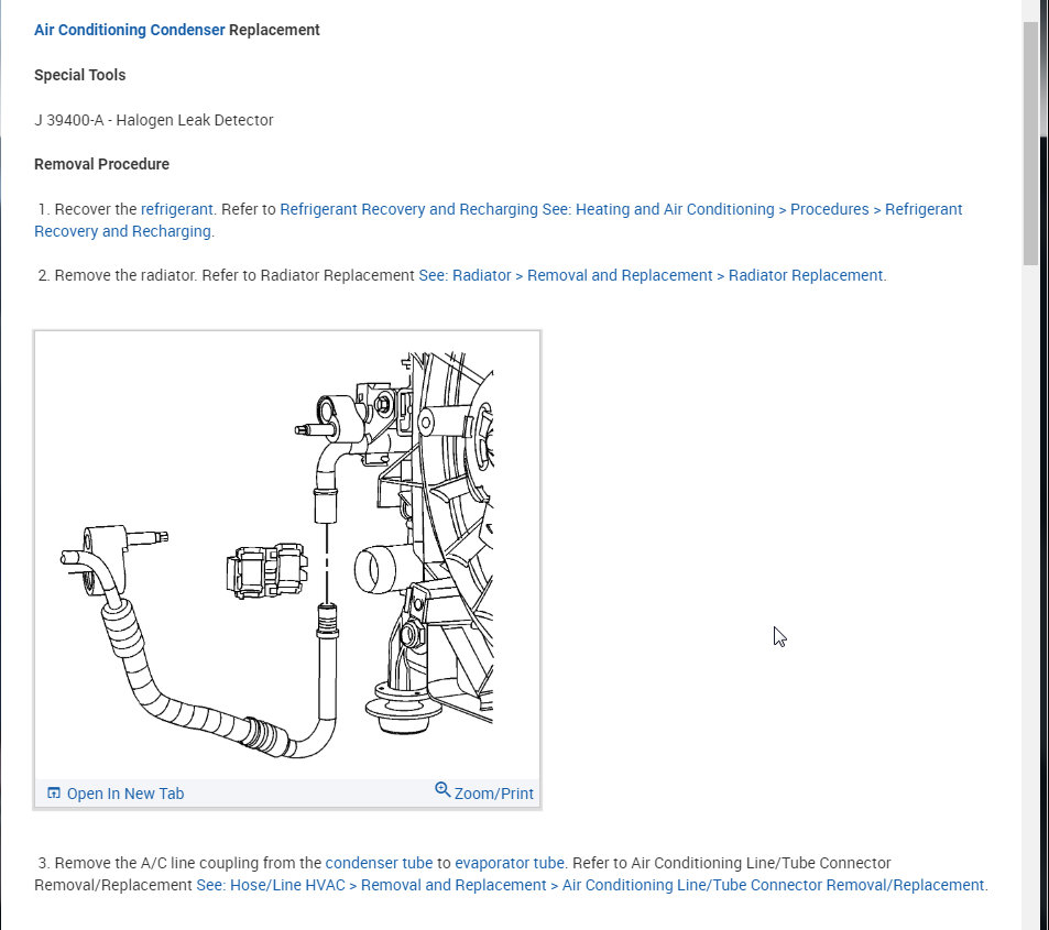

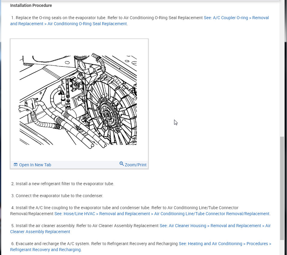

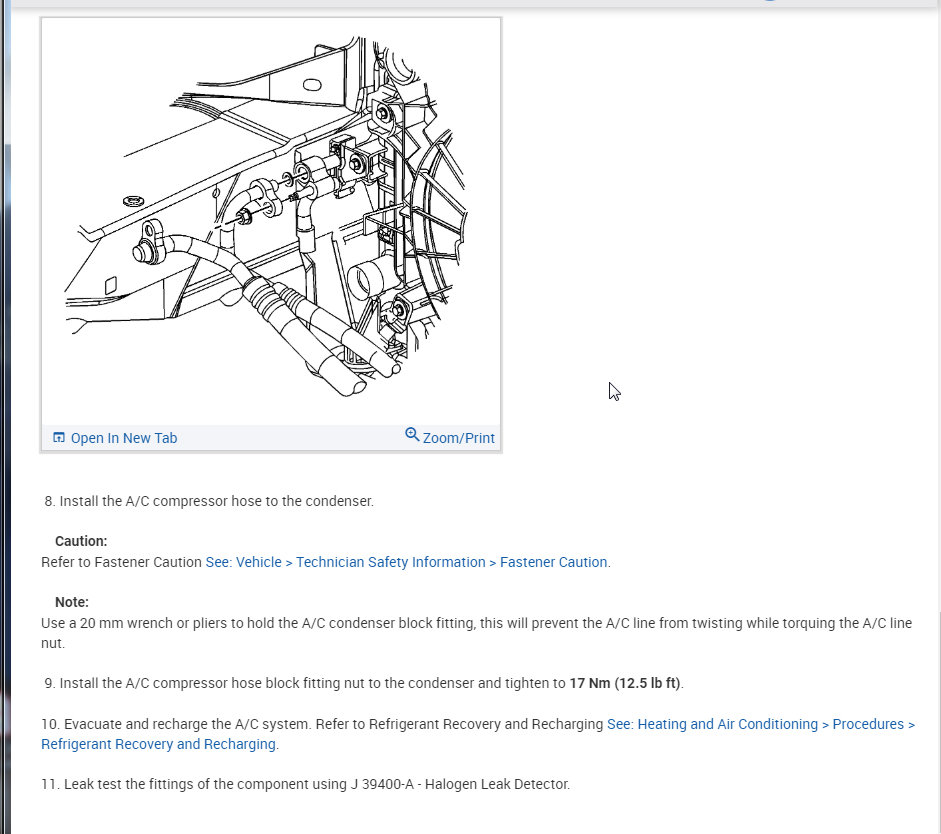

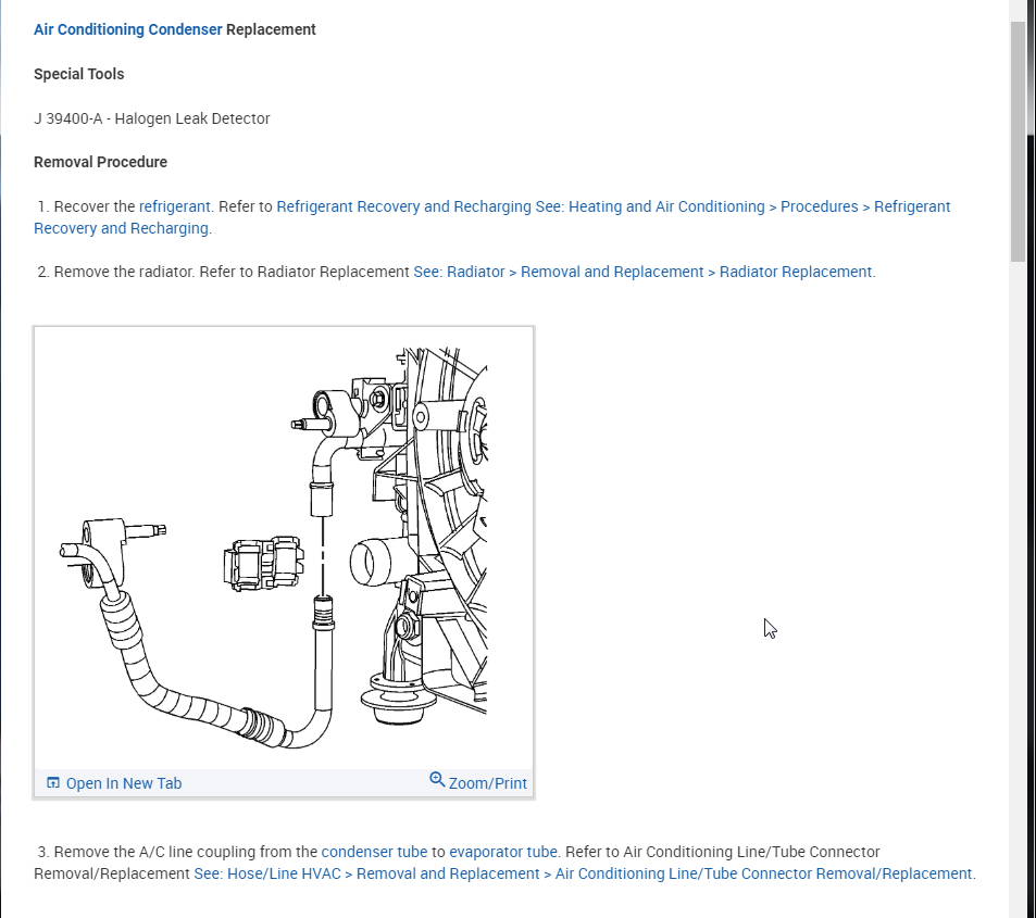

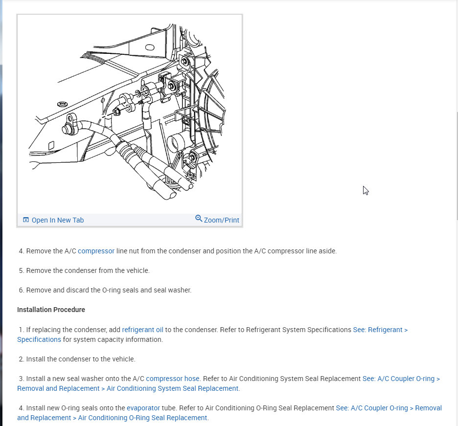

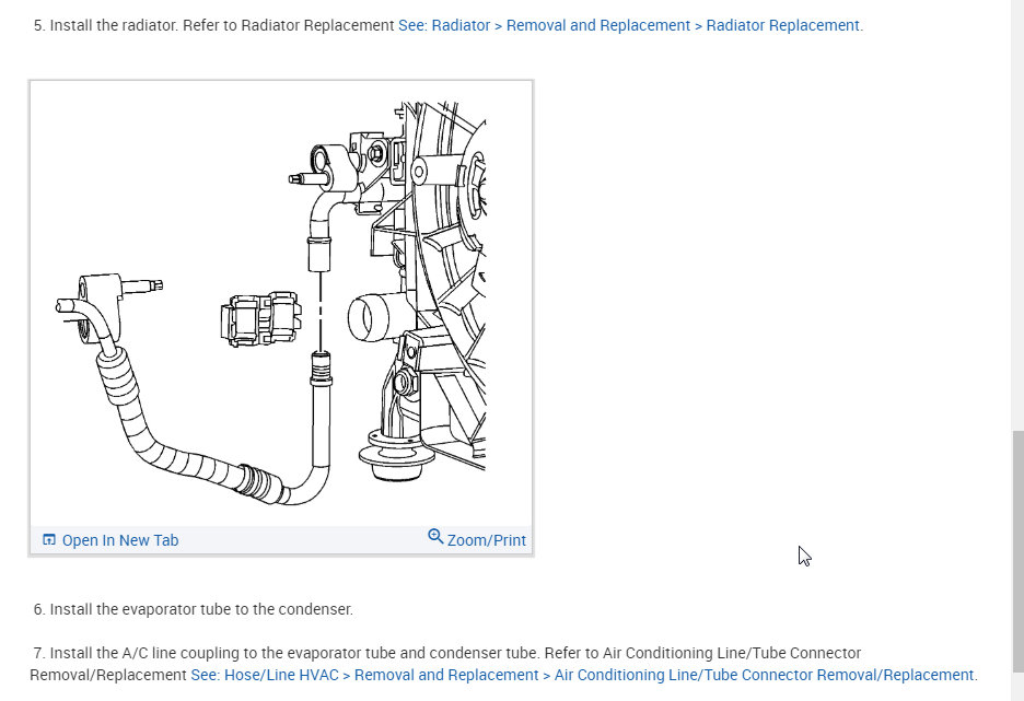

I would appreciate instructions on replacing the A/C condenser receiver drier.
Sunday, July 12th, 2020 AT 6:02 PM
MECHANIC
18,907 POSTS
I attached the requested info. Also, a guide on how to evac and recharge the system. Let me know what other info you need. Thanks
