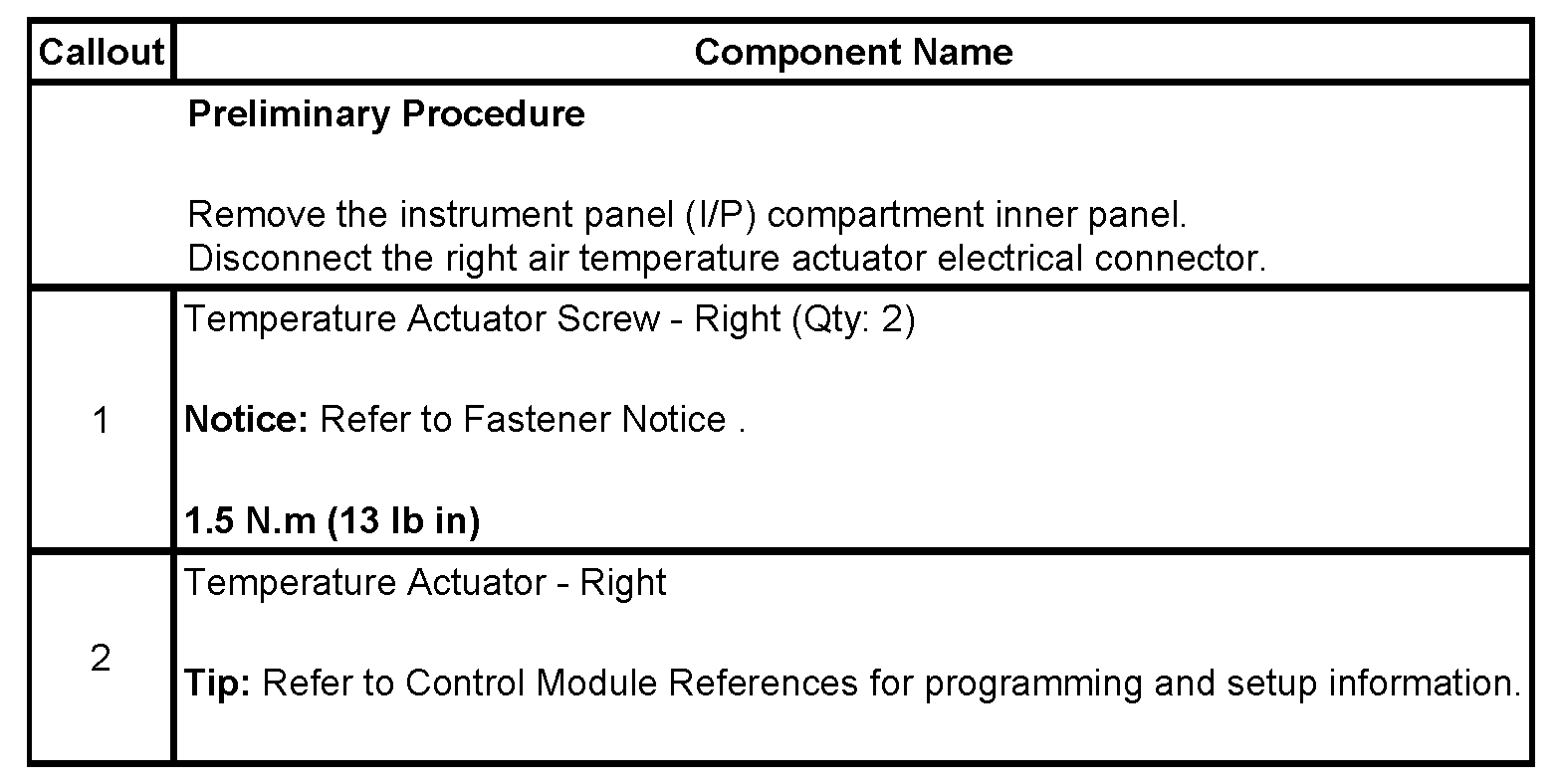

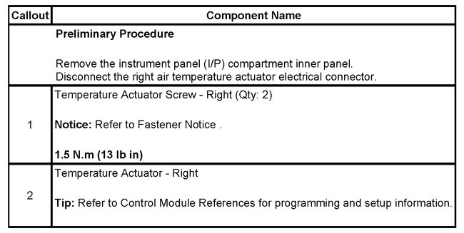

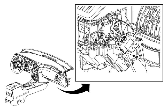

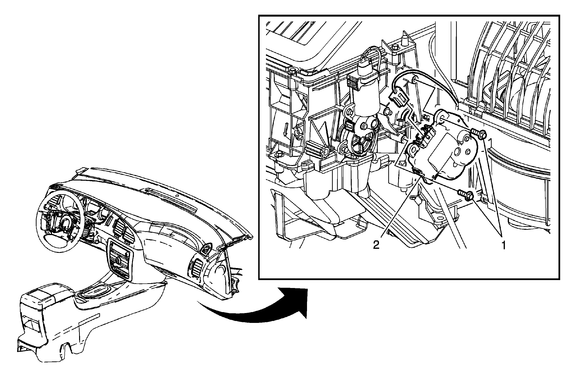

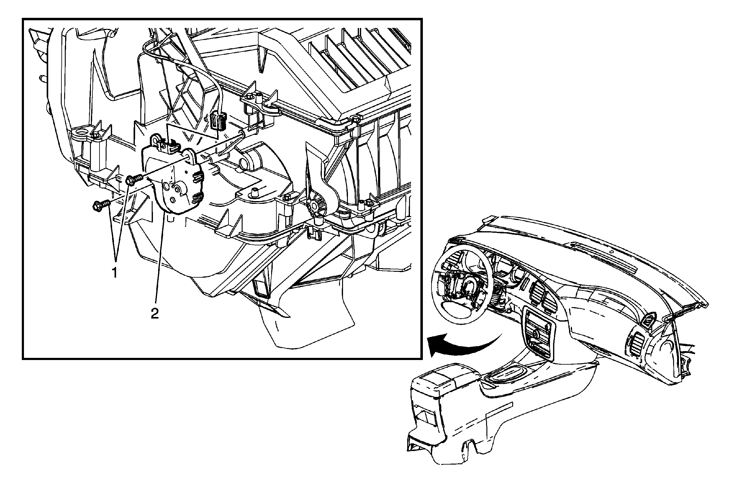

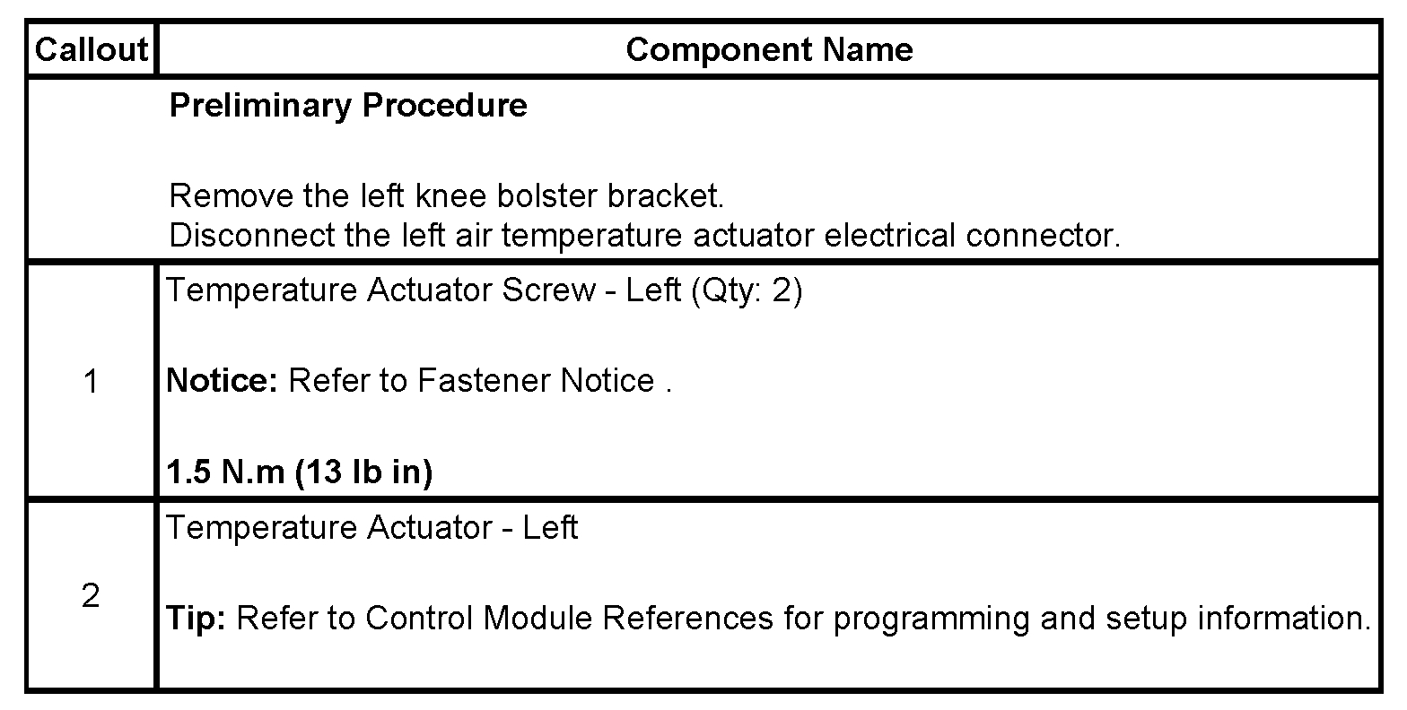

If the compressor is engaging, the system is properly recharged and both high and low side pressures are correct my first suspect is that the blend air door actuator isn't operating. This actuator opens and closes a door which either allows heat or A/C to enter the vehicle. If it is stuck, it may be blocking the cool air from entering.
Your vehicle has dual zone climate control, so if you are not getting A/C from either sides of the vehicle
If you look at pictures 1 and 2, it shows how to replace the actuator for the left side. Pictures 3 and 4 are for the right side.
