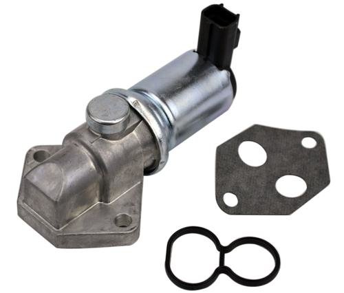

When I turn on the AC the engine rpm's drops. At idle the drop can be as much as 400 rpm's. Any idea whats happening?

It is very normal for the AC to add additional load on the engine, but the IAC normally compensates for it. You should try first cleaning the inside of the throttle body and backside of the throttle plate, then remove the IAC and clean and lube the slide valve inside. That should stabilize the idle.

What is IAC?

Idle Air Control
This picture may be from a different model, but it is basically the same.

Where on the engine do you normally find it?

It will be in the manifold, near the throttle plate.
