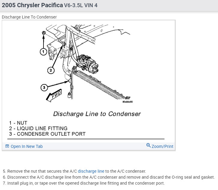

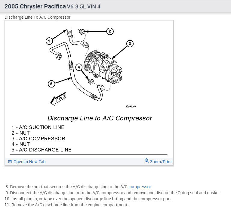

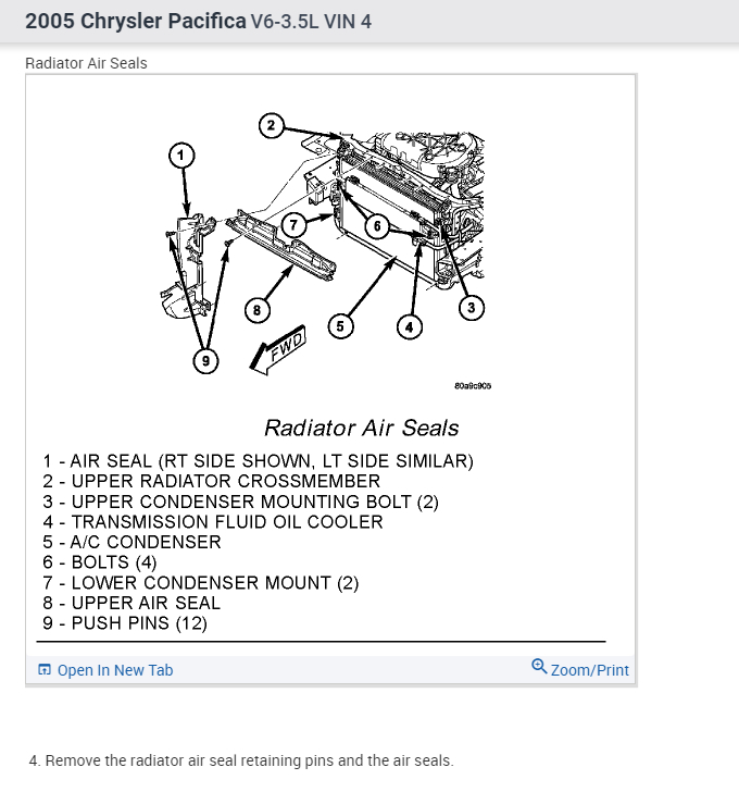

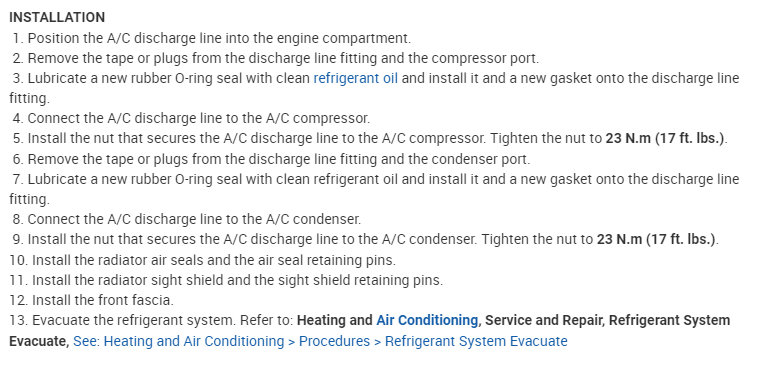

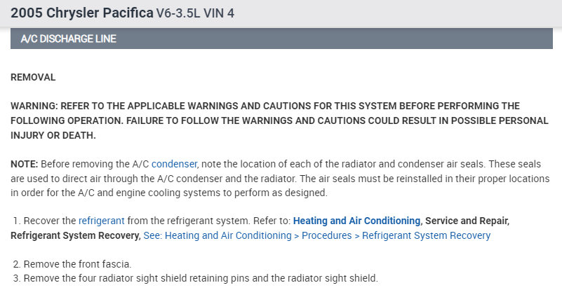

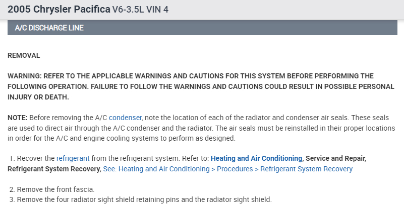

Uninstall and Installation + Torque Specs.
Tuesday, May 31st, 2022 AT 10:02 PM
SQM
MECHANIC
6,383 POSTS

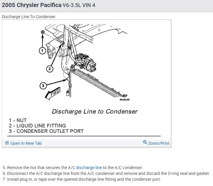

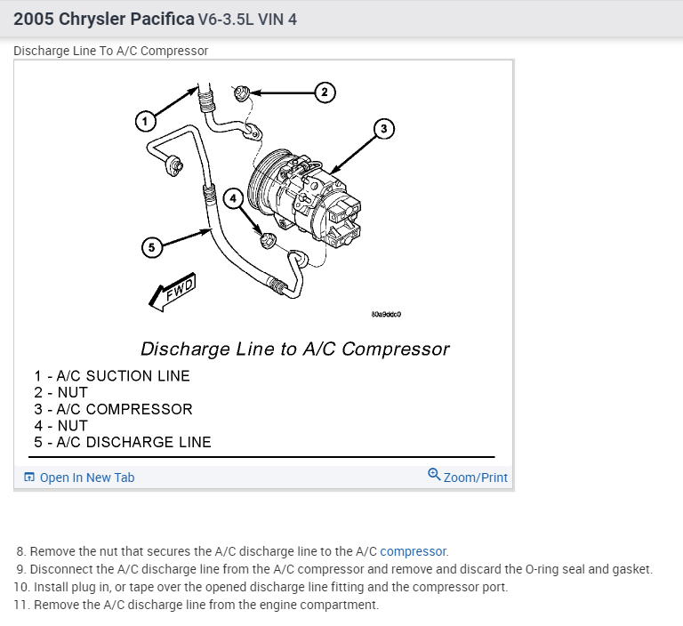

Keep in mind that you will have to vacuum down the A/C system before removing the lines.
I have attached the A/C discharge line replace procedure below.
Let me know of any questions.
