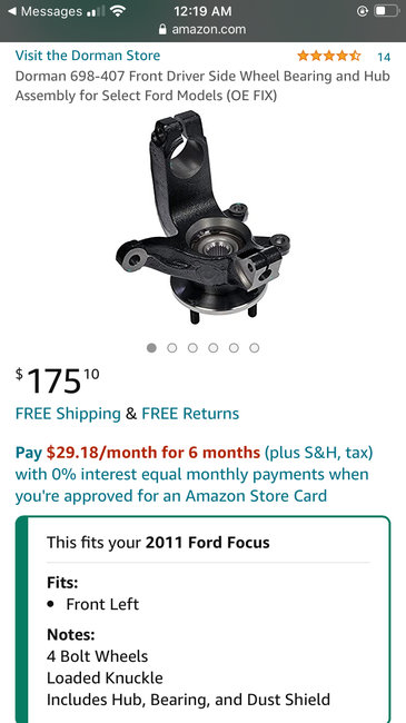

recently got the wheel bearing and hub assembly (front driver side) replaced. the wheel bearing basically became welded to the car (over time and from heat) and was taken off to be taken to a shop to take apart so could be replaced. replacement was successfully done by a friend. ABS and hydroplane lights both came on as i drove it down the street. There’s a slight hissing noise coming from the front tire where wheel baring was replaced. not sure at all what to do or expect. :(

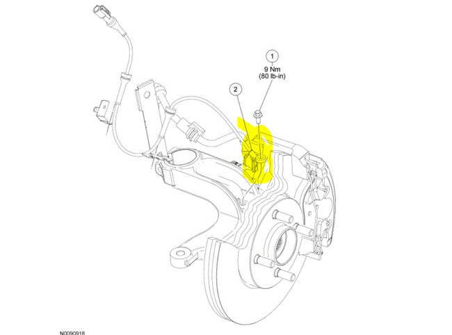

Now, the front wheel bearing on this vehicle is a press on bearing. It is separated from the actual hub. You indicated that it was in very bad condition and a shop removed it for you. By any chance did they use heat to get things apart? Also, I need to gain a better understanding if exactly what was replaced. The ABS sensor is mounted to the top of the spindle. See pic 1. Make sure the wiring is not rubbing anything that turns and confirm that it is properly attached.

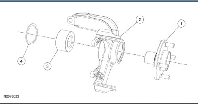

Pic 2 shows an exploded view of the assembly. Can you tell me which parts were replaced? Number 1 is the hub, number is the spindle, number 3 is the bearing and number 4 is a retainer.

From what i understand they did use heat on it to separate them. They said it was “welded together” so they had to separate it to remove it. since it wouldn’t pop off. I was told the ABS wire may not have gotten plugged in, maybe they forgot, but i’m not sure how to check that. The picture provided is the piece I had ordered so i hope that helps with figuring out what all was replaced .
Oct 1, 2020 at 10:26 PM

I am thinking that the scraping noise is a backing plate making contact with the rotor or the bearing getting locked up caused more damage to the "housing" which is called the knuckle.
Just to be clear, the picture knuckle assembly is what you had replaced? If that is the case, then I am sure there is just something making contact with a rotating object.
As for the ABS not getting plugged in would make perfect sense and the codes would support this as you will have an open circuit DTC for that wheel speed sensor.
I would recommend pulling the wheel off and spin the hub and rotor to see if you can see or hear anything.
