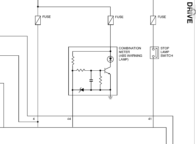

Hello Roy, I found a diagram of the t39 connector that goes to the abs module, I checked pin 44 to ground and it only has 7.5 volts, the wire is a solid blue with a white stripe, I just have to find out where the other end is, any suggestions, thanks Henry(sorry to bother you)

Hi, you never bother me.
Let me get a diagram for you

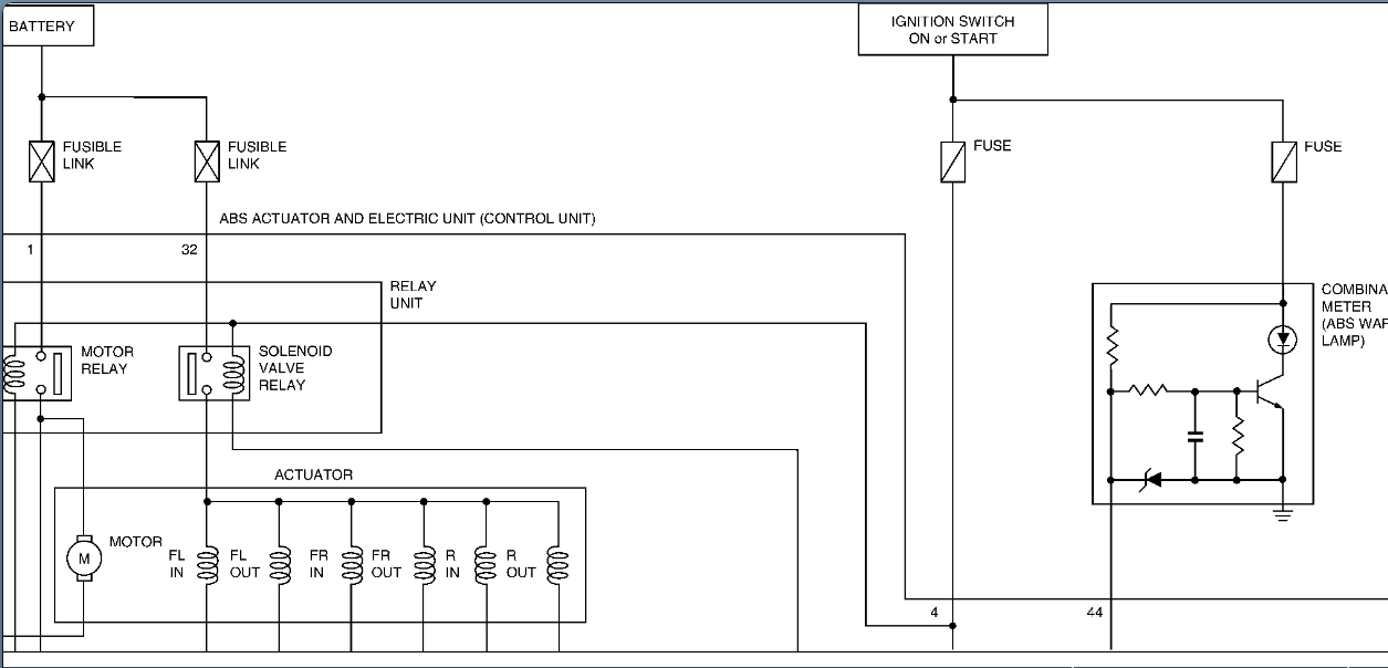

Three powers to the module. Check for battery voltage to all three pins.

Hello Roy, seems as though it is the ABS module. I have all three voltages there, I have to see what I am going to do now. Thanks

Hello Roy,
I wanted to update you on this issue. I located and bought a used module and installed, (I did not flash the module). Still the same issue, light will not go out. I bought the Bluedriver OBD2 and it says no pending ABS codes. I tried clearing the light with this unit still no good.
Do you know where pin 44 connects to? I figured I would track that down to another connector because it only has 7.4 volts. Any other suggestions? Thanks, Henry

  • 52,797 POSTS
Goes to the ABS light in the cluster.
The light may be on from the flash not being done as well.
