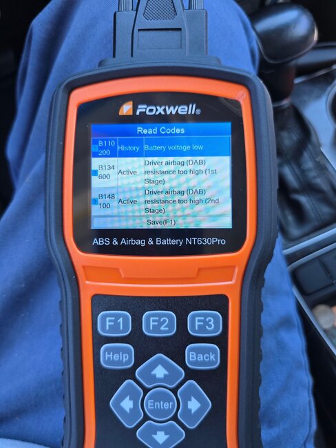

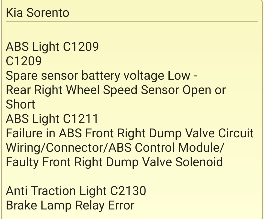

Got new ABS tester.
Shows C1206 RR Speed Sensor issue.
Replaced sensor but cannot clear lights.
And now have another light which shows up as "Brake" with a ! And P above it.
See pictures.

Why do you think I cannot clear these lights?
I now have 5 darn lights.
My Foxwell NT630 Pro is supposed to be able to clear these.
What about disconnecting battery for so many minutes, how many minutes?
Help!

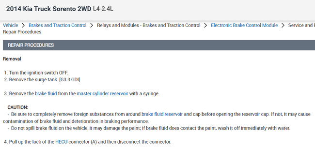

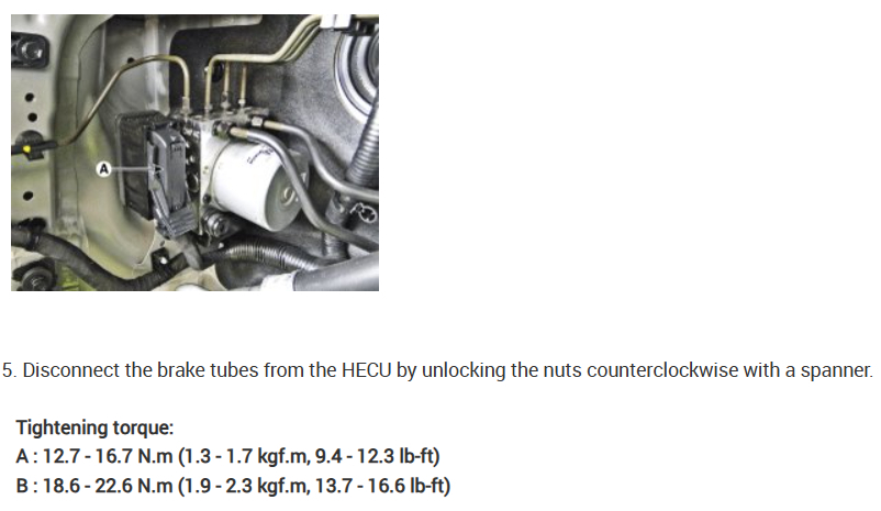

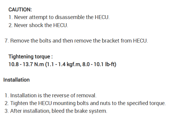

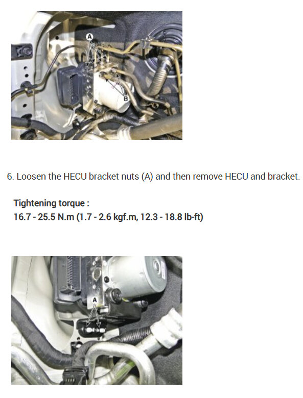

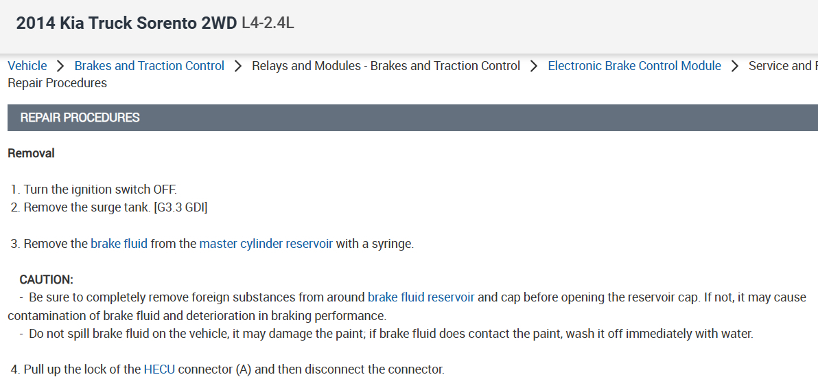

The second code is the issue, C1211, you have an ABS control module that needs to be replaced which is common. Here is the location and how to replace it. Clear the codes once completed. Check out the images (below). Let us know how it goes.
